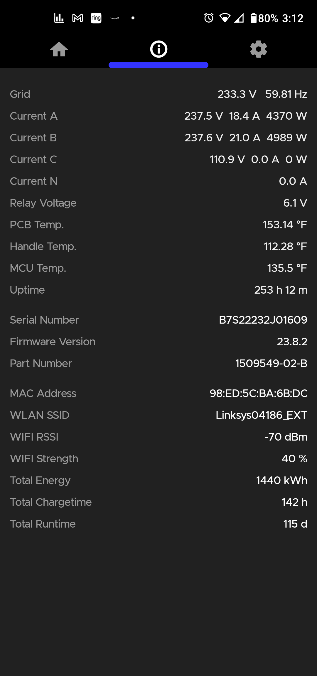

And as for its reliability, I am only using it at 40A and the printed circuit board gets up over 153F at that load. The garage, where it is mounted, is probably at least 95F while outside is less than 80F. The Amp draw from each leg is not even, one shows about 21.0 and the other about 18.4 (I need to test it at a 48A and 32A loads to compare the heating effect) but over 150F is already scary to me. Although I think I saw someone had a temperature at the PCB over 200F when it started to limit itself. (see: https://teslamotorsclub.com/tmc/thr...perature-readings-in-wall-monitor-app.298832/ ) I think about the stress on the materials as they go from ambient temperatures (0F or lower perhaps) to over 150F. I bet at 48A, the PCB will have 26A on one leg, raising temps there higher. Android Tewamo App to monitor the Tesla wall connector:
Ford F-150 Lightning NACS + J1772 Home Charger -- Tesla Universal Wall Connector launched Screenshot_20230804-151259
Saw about 106F at the 60A circuit breaker exposed surface. The black rubber handle temp in the sun I have seen over 120F, so really testing some material capabilities with these chargers.

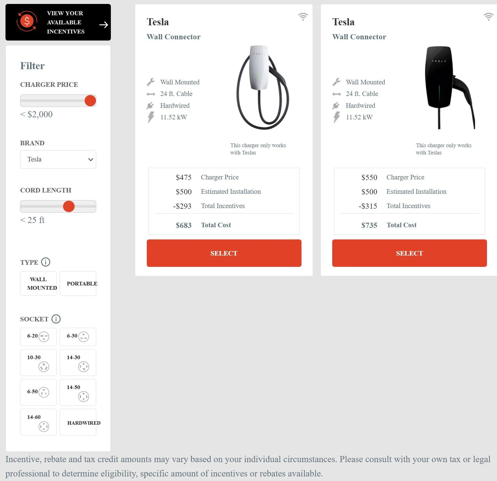

"EV Charger eligibility requirements include:
  1. Level 2 Charger (requires 240-volt power source).
  2. Must be Wi-Fi enabled (“networked”)
  3. Must be purchased new (not refurbished).
  4. Must be certified by Underwriters Laboratory Inc. (“UL Listed”)
To check if your EV Charger is eligible, please visit https://homecharging.electricforall.org/home-chargers-incentives-catalog/. "
Which leads to this, where the "incentives" do not match the rebates listed back at the Electrify your Ride site:
Ford F-150 Lightning NACS + J1772 Home Charger -- Tesla Universal Wall Connector launched 230819 electrify your ride EVSE catalog check if qualifies Screenshot 2023-08-19 095255
230819 electrify your ride EVSE catalog check if qualifies Screenshot 2023-08-19 095255.jpg
The $293 incentive shown here, is applicable to ALL chargers. It's the 30% federal tax credit. I am talking about utility company incentives such as these:
