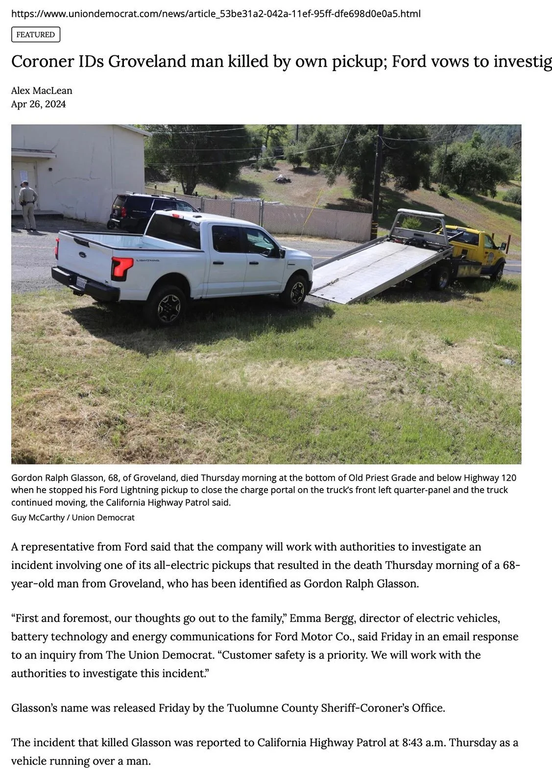

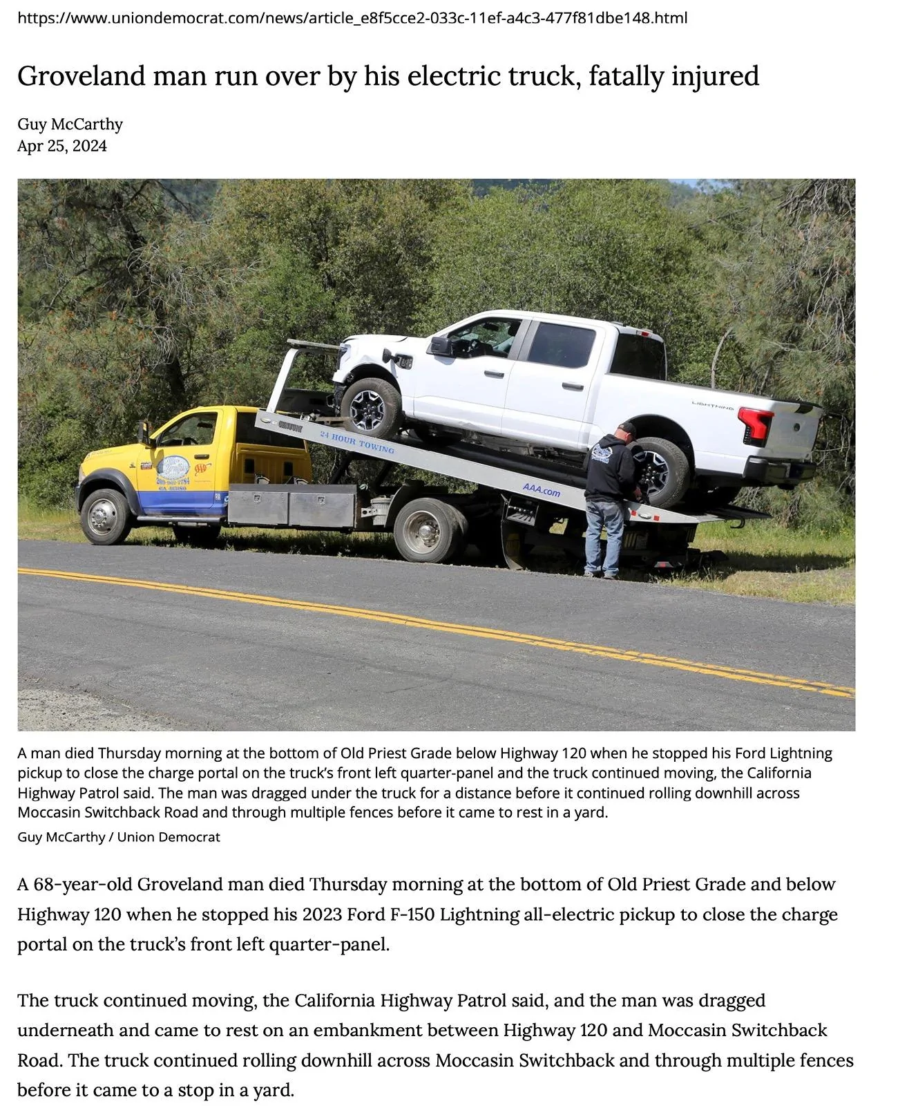

Another unfortunate accident reported by the Union Democrat newspaper.
Full articles attached.
Thoughts and prayers go out to the driver's family.

Another "small" thing with the F-150 Lighting that is a huge design flaw. #1- that little plastic flap on the bottom of the charging port is annoying AF, and it blocks closing the charging port door. #2 both the flap and the charging door should be spring loaded and biased to close IMO.
I'm a volunteer firefighter. When responding to calls and the charging cable is plugged in, in haste, I am often cursing the flap and the door, and have frequently left with the door open. But I just ignore the warning, as the fire station is only 2 miles from my home. If only the charging cord was 2 miles long, I would not have these problems. :unsure: On a positive note, I am usually the first firefighter at the station because the Lightning is fast.

That's crazy. I have, on an occasion or two, started to get out without putting it in park first and the truck puts itself in park, same as if you hit the power button while in drive. I wonder what failed here.

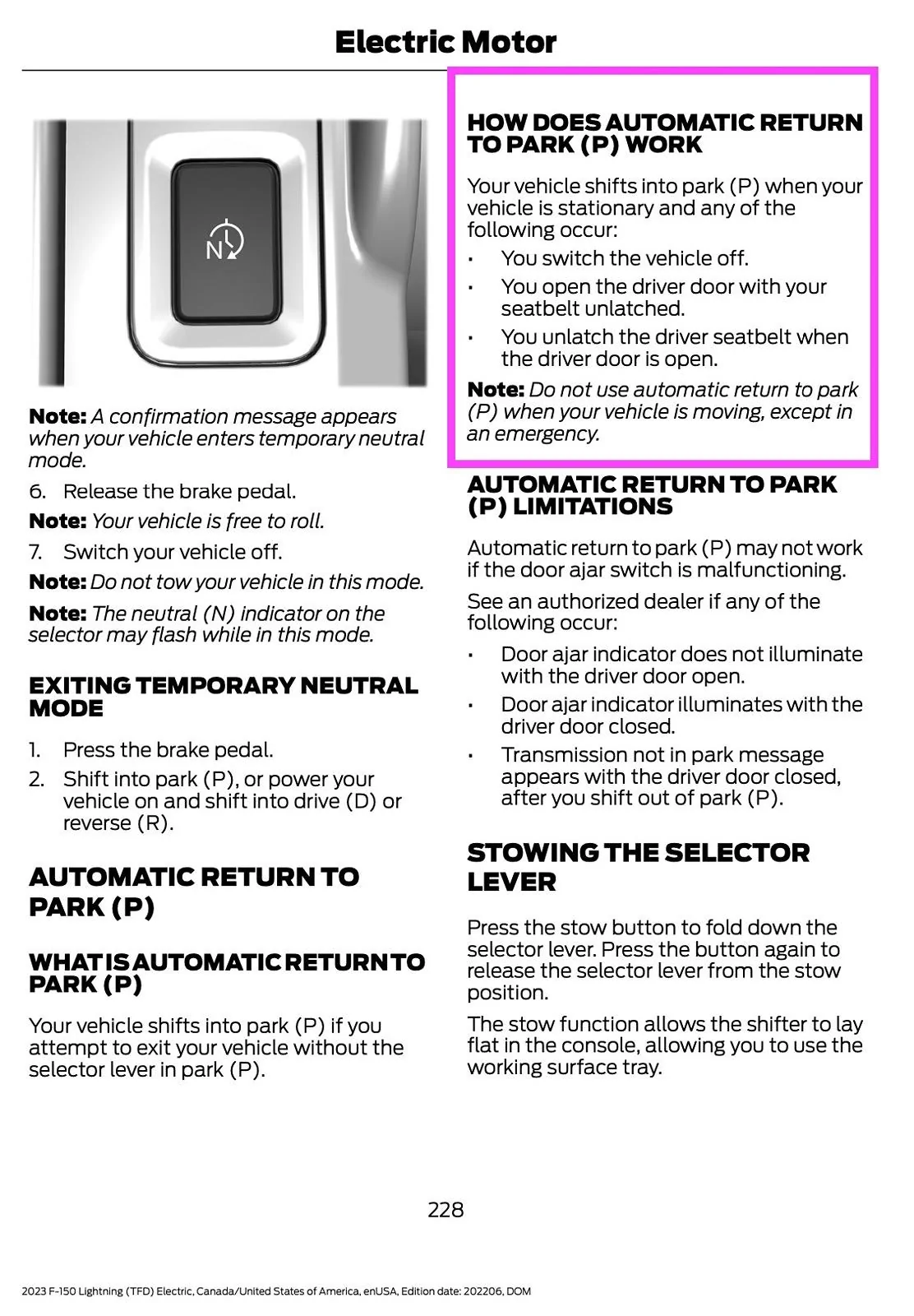

Believe the truck has to be stationary first for the Auto Return to Park to work. Then an Open Door and Unlatched Seat Belt will activate Auto Return to Park.
From the manual p.228:
