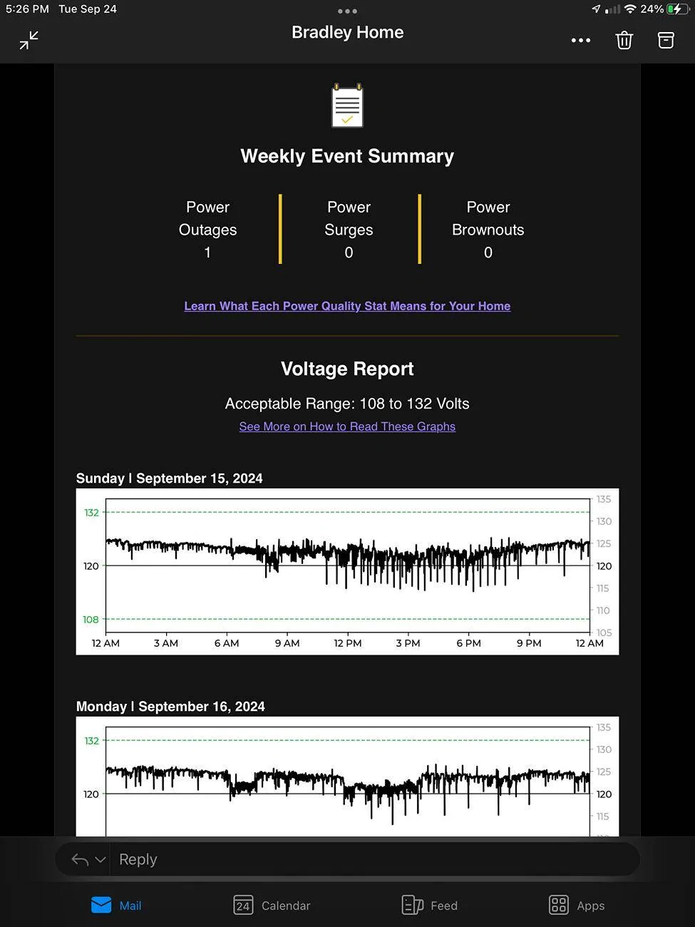

I also have the the Ting monitor. My insurance company does provide it. I think is great ?
Haven’t had any alerts. They send a monitoring report every week. It lets you know if there was any power outages or surges and voltage range.
