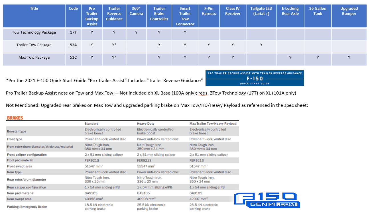

Doing what Ford should have done in their document:
I understand this is an old thread, but i noticed an error on the above chart.
The Tow tech package requires a Class IV hitch which offers you the 7 pin harness and class IV hitch.
Hence the updated chart should have Y on those two columns.

IT requires it, but does not include it, which is why I left it. I will post a link to a new thread on this.

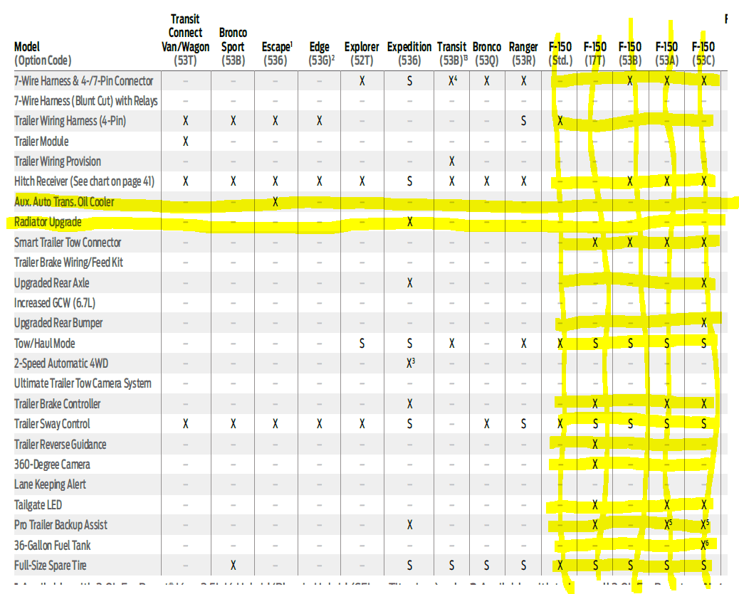

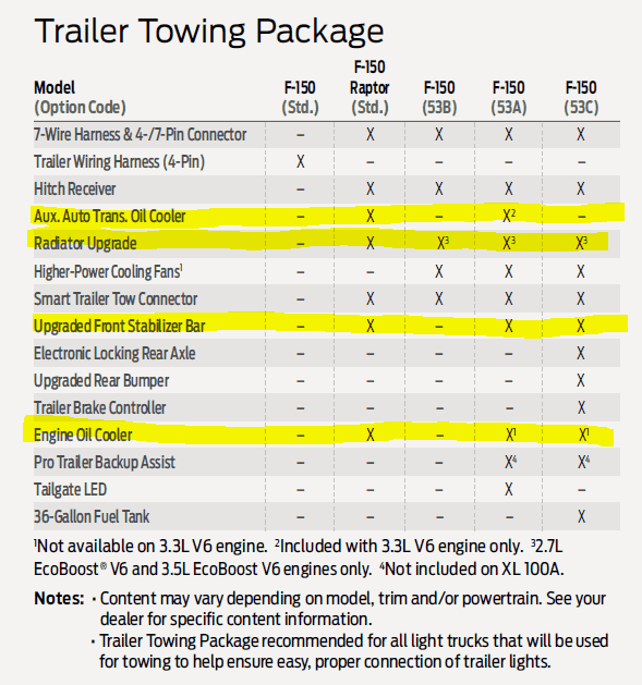

Yeah it does show that for the Max tow, though I am wondering if the upgraded radiator, trans cooler, and oil cooler are now standard in 2021. The 2020 had the coolers and the radiator as well as the front stabilizer bar. Though the 2021 doesn't show it in the towing guide.
2020 Tow Guide:
2021 Tow Guide:
Note that Aux. Auto Trans. Oil Cooler and Radiator upgrade are omitted from 2021.
I also see this in the towing guide:
5 Do not exceed a trailer weight
of 7,000 lbs. (3,175 kg) or 36 sq. ft. (3.4 sq. m) trailer frontal
area with only the Class IV hitch (53B), without the Trailer
Tow Package (53A).
Looking at the 3.5L Hybrid V6^5:
3.73: 17,000 = 11,000 towing.
My question is can I tow more than 7,000lbs with the Tow Technology Package (17T) or do I need to get the Max Tow or Trailer Tow Package to pull up to the theoretical max of 11,000+ lbs? As the tow guide doesn't show any updated coolers, then what does the Trailer Tow and Max Tow do to give you to tow above 7,000lbs? I currently see nothing that would prevent me from doing it as the Lariat comes equipped with Class 4 and 7pin. Other than the small disclaimer about not towing more than 7,000lbs w/o Trailer Tow or Max Tow, I am trying to figure out if this is a miss print or is there something else that has been omitted?
Note: I know payload is going to be limitation and I won't tow 11,000. Though I do tow boats that can be as low as 6% tongue weight and I want to fully understand what I am buying.

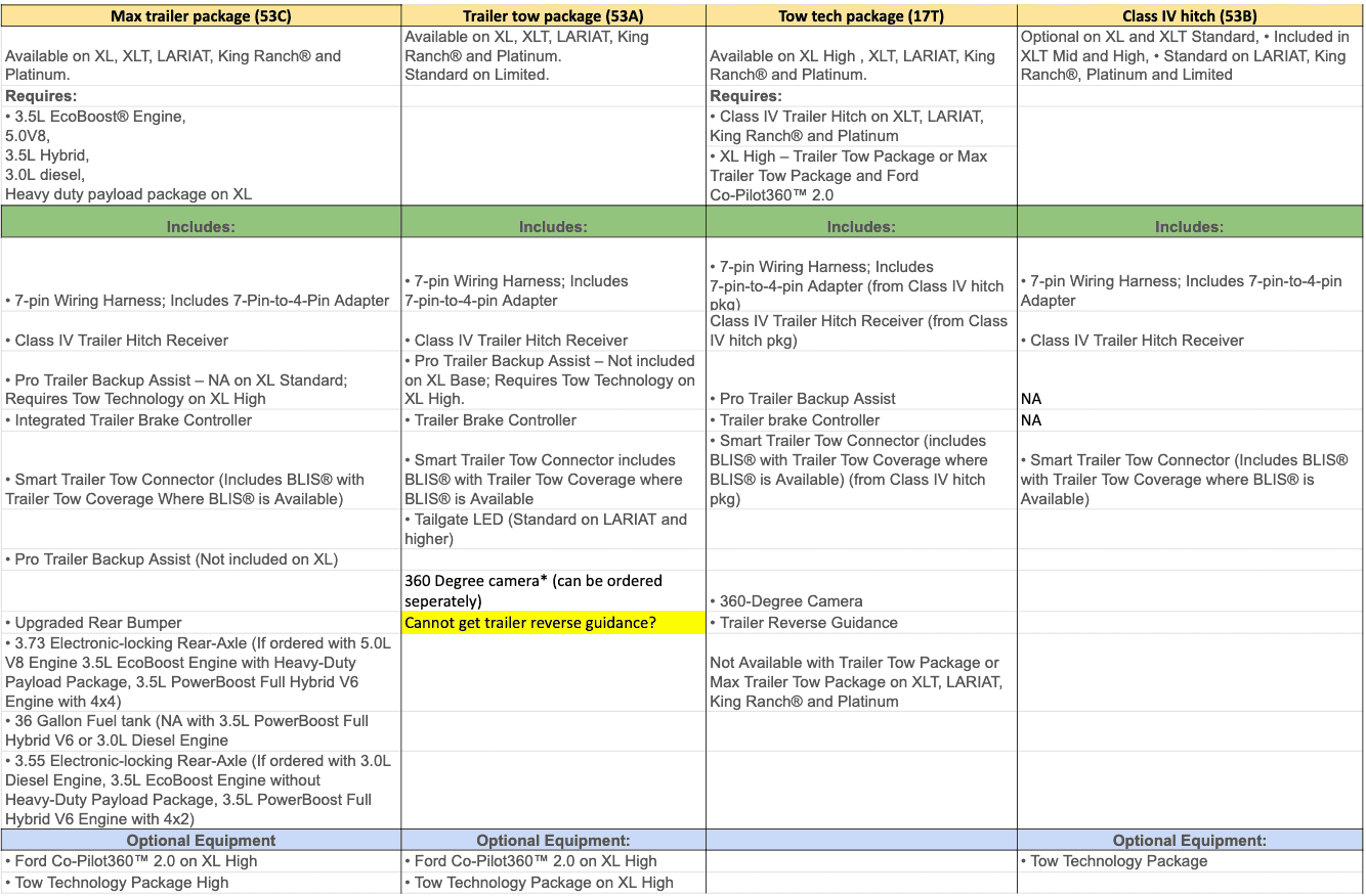

Here's a consolidated doc with the detailed specs.
https://www.f150gen14.com/forum/thr...nt-bumper-vs-class-iv-vs-tow-vs-max-tow.1188/
Regarding your build:
First 53A is the trailer tow package, 53B is the Class IV Hitch, and 53C is the Max trailer tow. '
Next, yes you are capped at 7,000 even with 17T and 53B (hitch only). 53A (trailer tow) gets a solid stabilizer bar allowing it to go to 11K, and 53C (max trailer tow) adds a reinforced bumper, larger rear axle (might be on some non max tow based on GAWR) and larger rear brakes. Most of the other things are mute on a PB, like the tank, rear axle, and upgraded radiator.
The tank of PB a firm 30 gal, it can't be equipped with the 36gal. Radiator is the same for all PB according to the spec sheet.

Sounds like the trailer tow is the best way to go on a PB build then as the max tow only gets you upgraded bumper and brakes which to me are negligible.
Does the trailer two package include the same trailer brake controller and pro trailer backup with reverse guidance as the max tow? Looking through this thread there was some speculation it was different.
One thing is for certain is they have made this unnecessarily confusing and annoying to track down all the info...
You’re right max tow is not a good value on the PB. I got it when it was $260 more than the regular tow package and now they are sticking me with $650 more... hopefully it has resale value. I will be one of very few max tow, tow mirror powerboosts, at least in the 2021. That’s what I’m telling myself so I don’t have to wait for a whole new truck.
As for the controller, I THINK they are all the same. I can’t get a handle on if trailer reverse guidance is included in pro backup assist or not either and Ford said no but that doesn’t mean anything. That means you only get it in tow tech, which I find hard to believe. I need someone with it.
