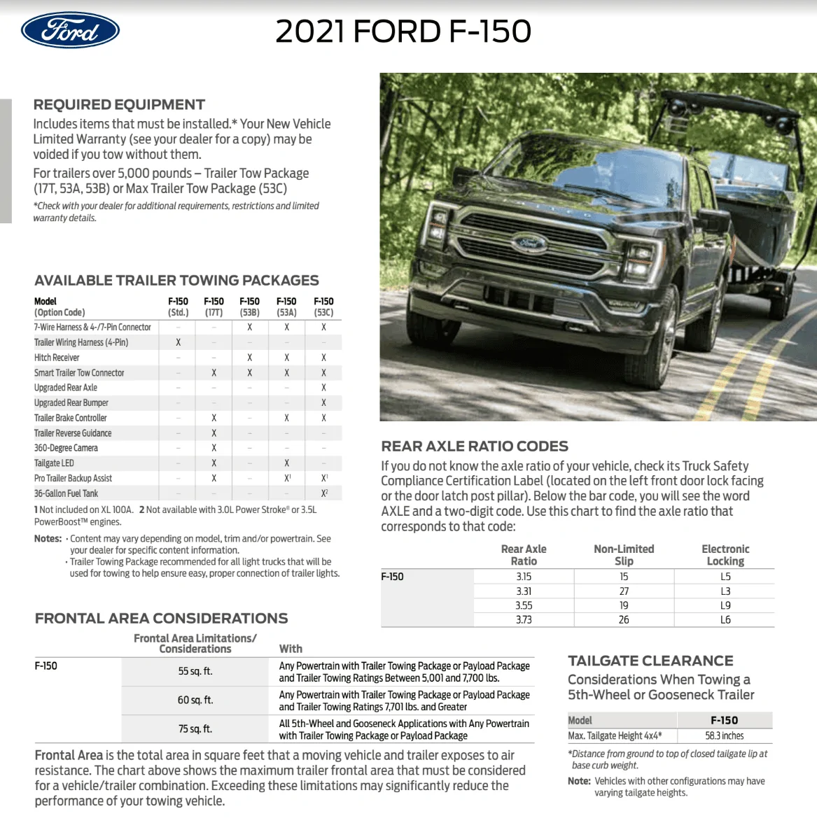

I believe you may be correct.. When pulling up the info on the "Class IV Trailer Hitch" it has this info...
NOTE: Ordering the Trailer Tow Package does not include Integrated Brake Controller.
Integrated Brake Controller is a standalone option and must be ordered separately.
But when pulling up the "Trailer Tow Package" it shows it is included.. So who knows.. :)

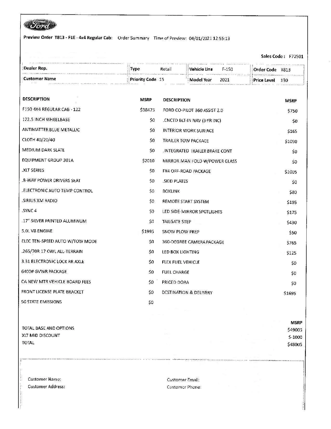

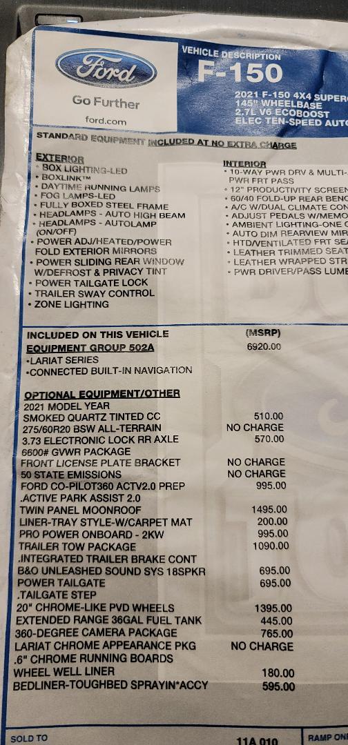

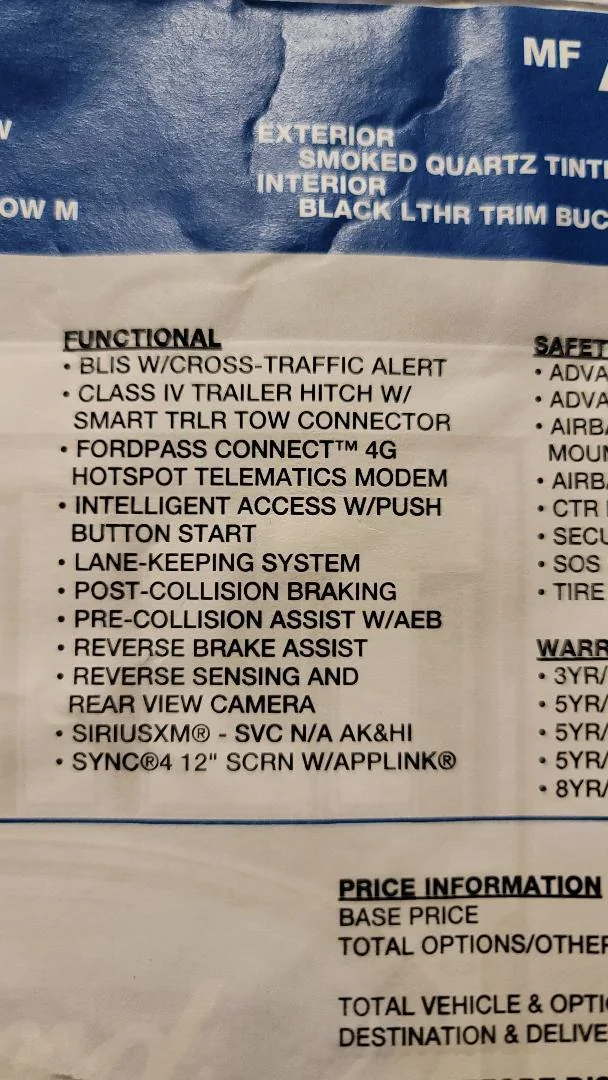

I'm still telling you guys, I get the eerie feeling that with "trailer tow package" you do NOT get the INTEGRATED trailer brake controller of the max tow. I would absolutely hate for people to try to save a few bucks because they only feel they don't need an upgraded bumper on max tow (especially on the hybrids) when I feel that integrated controller is important.
In the previous years it is getting clearer in searching older forums and also dealer website descriptions, that the integrated controller is a standalone option you would have to add, and it makes up for the gap in max tow vs tow package price.
I am VERY curious as to what "trailer brake controller" even means in the regular tow package... I want to see interior shots of where the squeeze trigger goes, as well as the in dash trailer menus, but I realize NO ONE does that in any review as they only get the trucks for a few hours and keep talking about the folding shifter for half of it.
I think you do.
The attached jpg is the order my dealer submitted. Below is from the Ford website listing what my VIN# comes with.
Both say I'm getting Integrated Brake Controller and the sales order lists it as zero cost so it must come with it.
I did have to pay extra for the 360 degree camera system and E locking rear axle. The 36ga tank won't fit on the reg cab (along with a bunch of other options I wanted) and I'll upgrade my rear bumper if I decide I want that.

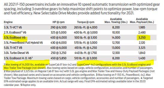

It's a bit under 200, but was going off Payload stickers on like-for-like 2021 Platinums. Window stickers were identical except the twin panel, and payload was 160-ish lower on the twin panel truck.
Hardly scientific, and hopefully it is just 66 like you say, but I would find that a bit harder to believe. That laminated glass alone probably weighs that, before track, motor, etc. You are removing metal, but it's aluminum and maybe some sound dampening material. Maybe losing a few lbs and adding in a decent amount more.
But I can't find anything for sure on the total moonroof weight, found the parts but nobody was listing weights.
The numbers I was quoting was from the 44 page "2021 F-150 Weights & Specs" from the section "Actual Regular Production Option Content Weight".
It literally list everything, like the power adjustable brake and gas pedals are 7lbs.

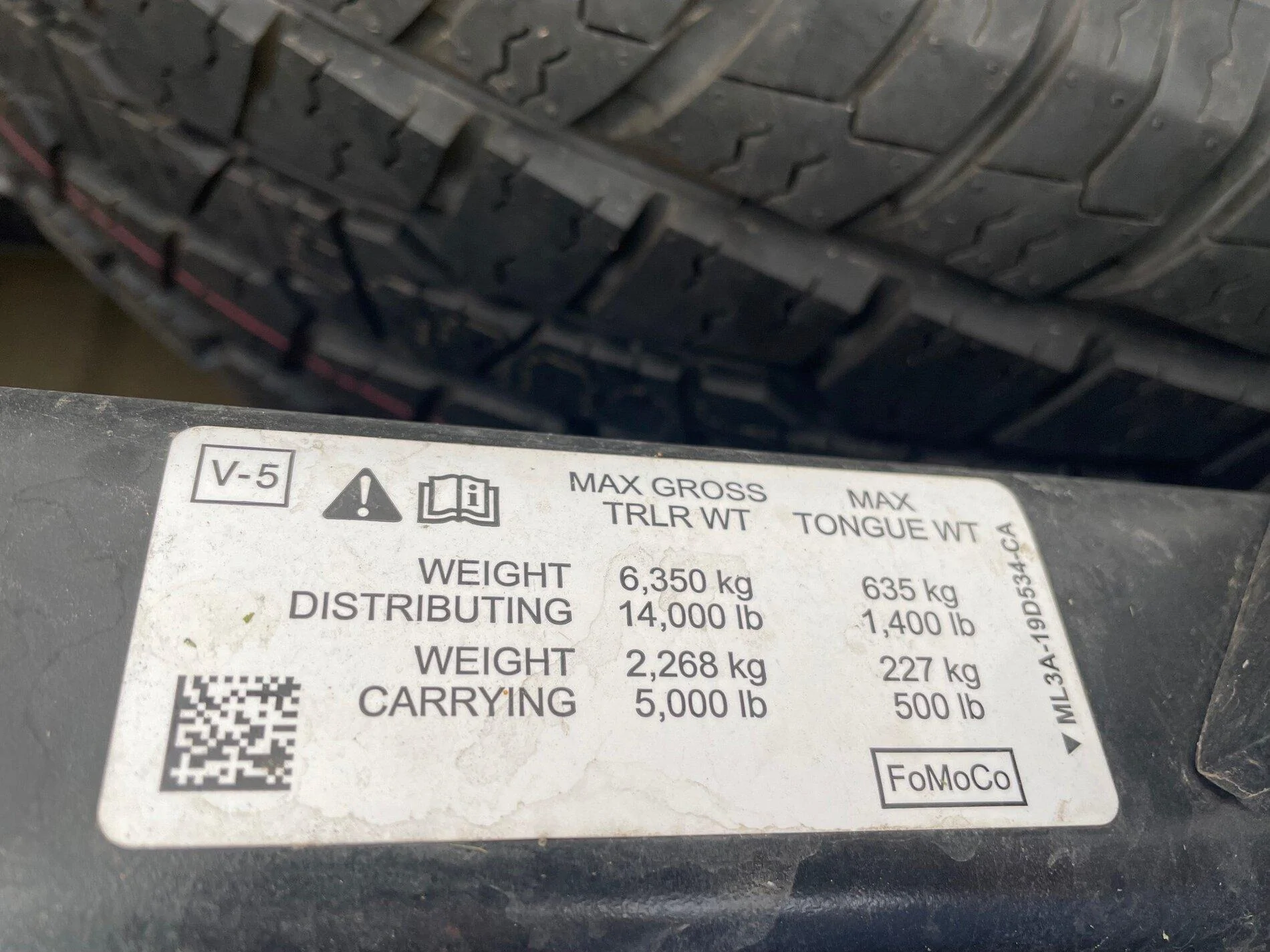

I am not a big fan that FORD keeps listing the hitch as a IV class hitch. It is only rated for 500lb tongue weight without weight distribution system. To me this is false advertising now I have to buy a $250 aftermarket hitch and cut off 2" receiver drop. My truck has the tow package and E-lock-3.73 rear-end but according to their tow spec. sheet I should be able to tow 7,700 (without any modifications) or [12,900# with max towing package]. A 7,700 trailer should have a tongue weight of 1,155-1,540# This is just not possible without weight distribution??? Who's boat trailer has a weight distribution attachment? WTF
Agreed, so I called Ford and they explained that the hitch can handle 14k (as per rating) actual trailer tow, but that the gross vehicle weight is what limits the TRUCK and therefore the trailer hitch to 5,000 pounds without weight distribution. My boat and trailer weigh 9,750 pounds combined and use surge braking, and the trailer format is incompatible with weight distribution hitches. I VERY carefully balanced the boat on the trailer to get the tongue weight to 9% (Load Rite's specification, way less that the normal 15% used for RV's and other trailers), moved the boat forward 12" to get it there using CAT scales, and added Airlift bags to get final balance, but found I did not need much because sag wasn't bad (30 psi out of 100 max to get back to 40" arch clearance), and was able to keep both of the axle weights within 200 pounds (under) max load. Technically over the hitch limit, but Ford says that's expected where weight distribution isn't possible. I did buy one and tried it, found it couldn't be done. Had no issues with getting the weight motivated, or with sway or any other towing issues, but braking and mpg became a joke compared to the F-350 it replaced (KR PB). YMMV, but I think you'll be fine with only 800 pounds, maybe less for a boat tongue weight, and using the stock hitch. I am having no issue with that part of my configuration. I also suggest better (truck) E-rated tires.
Thanks for the summary. Interesting that FORD said that... My 2018 had the same thing with the factory trailer hitch without the max payload just the heavy payload and E-lock 3.55 I towed 120 miles with a trailer having ~700-900# tongue weight and it bent the hitch down 12degrees! I talked with a few other F150 owners I knew and two of them had the same issue and the other two didn't tow. One of the guys who had that happen regularly towed a 7500# wake boarding boat/trailer combo and after his 3rd trip he took the truck in and got a f250 with the powerstroke. My personal experience, I bought an aftermarket hitch for my last towing trip of 2700 miles and it hooked up easy and didn't move. That trip I towed my wife's car at 65mph max and that little EB2.7 got 17mpg over the whole trip!

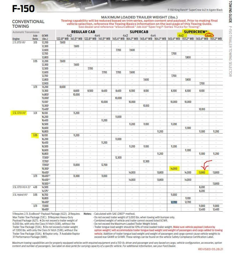

Wish I would have saved the calculator output.
The towing guide has what I was after. Trailer weight shows 11,200 and the below package option table. Didn't realize that I was getting a different axle or bumper with the max tow.

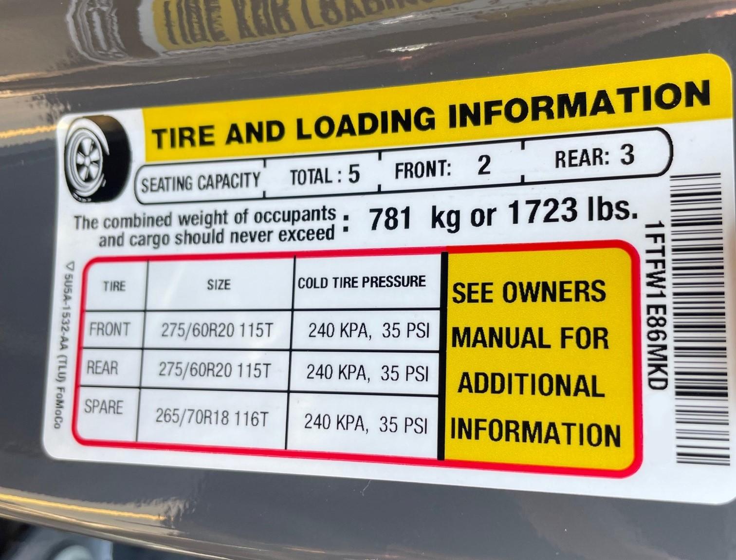

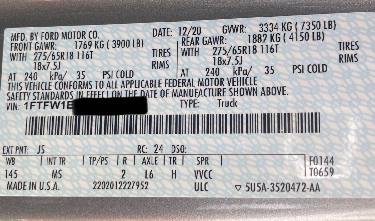

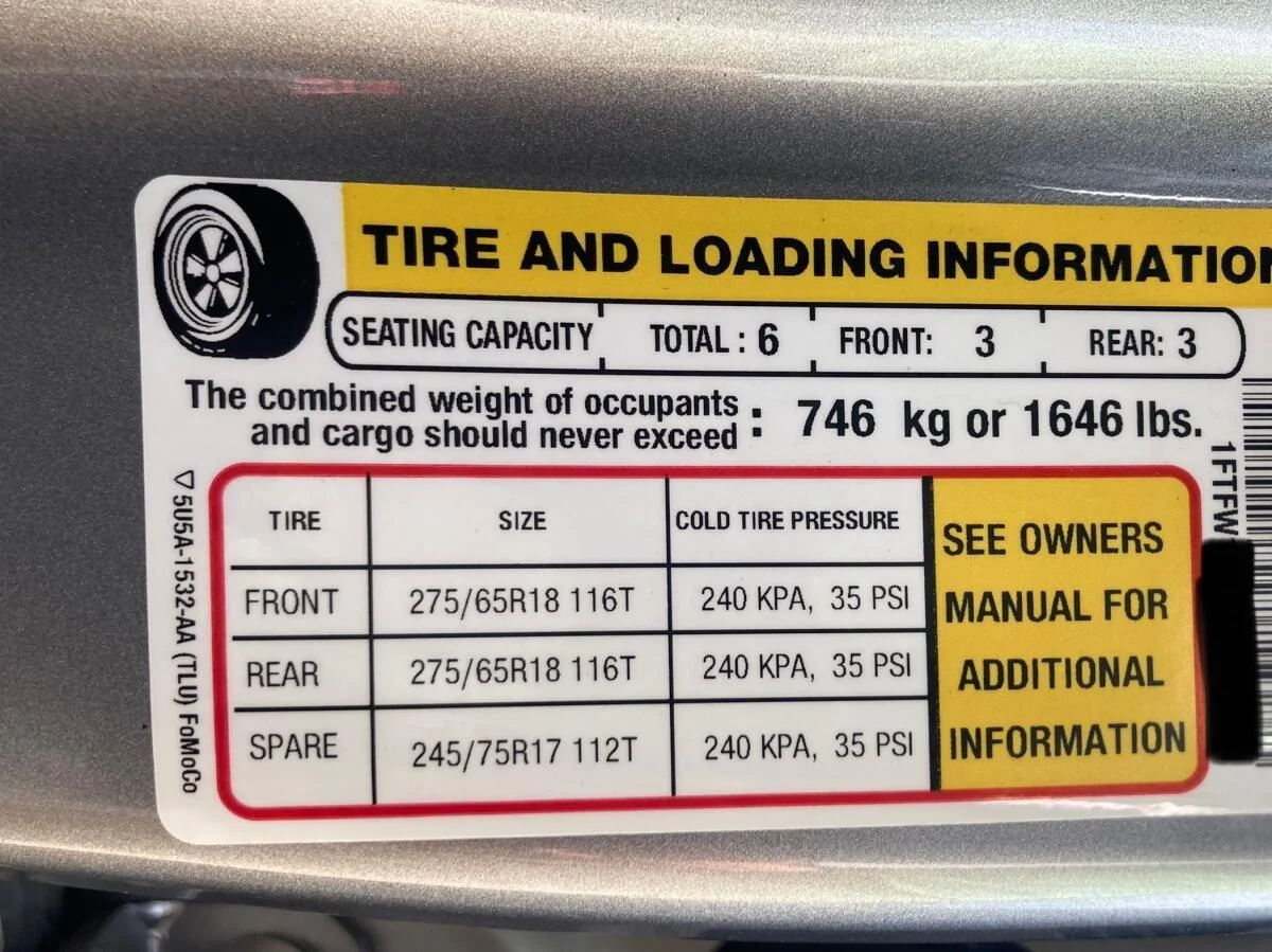

You have the 3.5 EcoBoost 4x4 with 53C max tow package? You have a loading sticker below your configuration sticker THIS loading sticker will give you the capacity of your truck as part of a backwards calculation. I wish FORD would flat out tell you your GCVWR instead of GVWR as you can see by the chart below its Very dependent on your configuration. My truck actually has a higher GVWR than your truck but you have a higher rear spring capacity by your 53C package and SPR - 33CC. Your truck should have a loading sticker that reads 3150lbs if I understand Ford's charts in order to have the 14,000 (4x2)/ 13,900 (4x4) towing capacity. I wish Ford just listed the GCVWR on the loading sticker instead of making people guess.
Ford F-150 Lightning Tow Package Breakdown For 2021 F-150 payload not mine.JPG
Ford F-150 Lightning Tow Package Breakdown For 2021 F-150 Towing not ours
Use the formula to determine if you can carry the following gear and people in a truck with a curb weight of 6,000 pounds and a GCVWR of 15,000 pounds:
  • Three 150-pound passengers
  • A quarter-cord of firewood at 1,250 pounds
  • Tow a 2,800-pound car
  • With a 2,000-pound car trailer
The calculation for determining the towing capacity for a truck carrying the above gear requires you to subtract everything moved by the vehicle from the curb weight and the GCVWR:
  • GCVWR – curb weight – cargo – passengers ≥ total towing weight
  • 15,000 pounds – 6,000 pounds – 1,250 pounds – (3 people x 150 pounds each) = 7,300 pounds towing capacity
  • Car + trailer = total towing weight
  • 2,800 pounds + 2,000 pounds = 4,800 pounds total towed weight
Because the total towing weight of 4,800 pounds is less than the total towing capacity of 7,300 pounds, you can safely carry everything listed while still towing the car.

Thanks Tokyo Joe, I appericate all the effort put into that, I will post that load sticker here soon I need to take a pic. I agree Ford needs to post this information so people do not damage their trucks or make unsafe choices by not having the correct information properly given to them without having to search everywhere. I do know with the springs the truck doesnt ride the best compared to my other F-150's. It floats more almost like an old LTD with bad shocks over bumps. Alot of front to back motion I did not notice until I get it home. I usually tune my trucks for 1/4 mile and towing is a second though. This truck is more comfortable and relaxing then the previous gen besides the front to back sway. My 18 F-150 has alot more sporty feel to the road and handles better by far.
toyko joe
Jun 23, 2021
123
earth
2021 F150 XLT PowerBoost FX4
Just going off this sticker and some assumptions:
  • Towing capacity is assuming 150lbs for driver.
  • 1723 - 150 = 1573lbs if this is your max capacity of your truck after you add a driver.
  • Towing you put 10-15% of the total weight towing onto the tongue. Lets assume 10%
  • Towing chart says 13,900lbs for your configuration with 53C so 1,390lbs tongue weight.
Summary: I your loading sticker indicates that you can place 1,723 lbs into your truck. Assuming you are towing alone and only weigh 150lbs you are well below the max tow rating IF your tongue weight is only 1,390 lbs. (WITH LOAD DISTRIBUTION) <--- This part really chaps my ass because you can't put more than 500 lbs without load distribution on the factory IV hitches. I bought a CURT aftermarket for my 2018 so I could have more tongue weight without weight distribution, the truck looked stupid with two hitches.
Disclaimer: I still don't fully understand why FORD doesn't put GCVWR on these trucks, so I can't say "you're good" its just the calculations I ran that said I think you're good.
