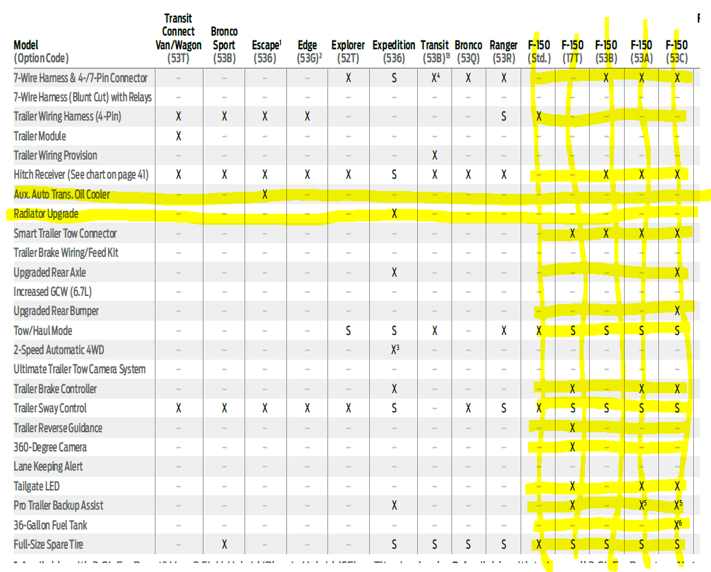

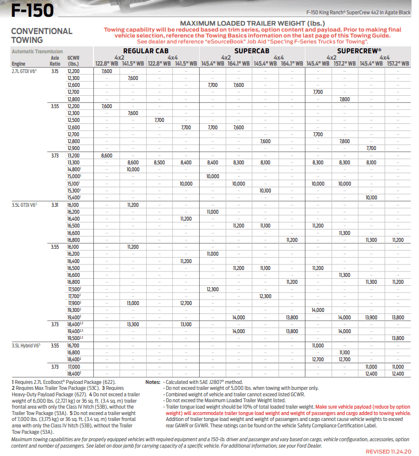

Addition Trailer tower guidance.

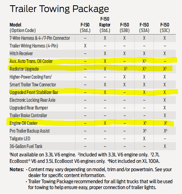

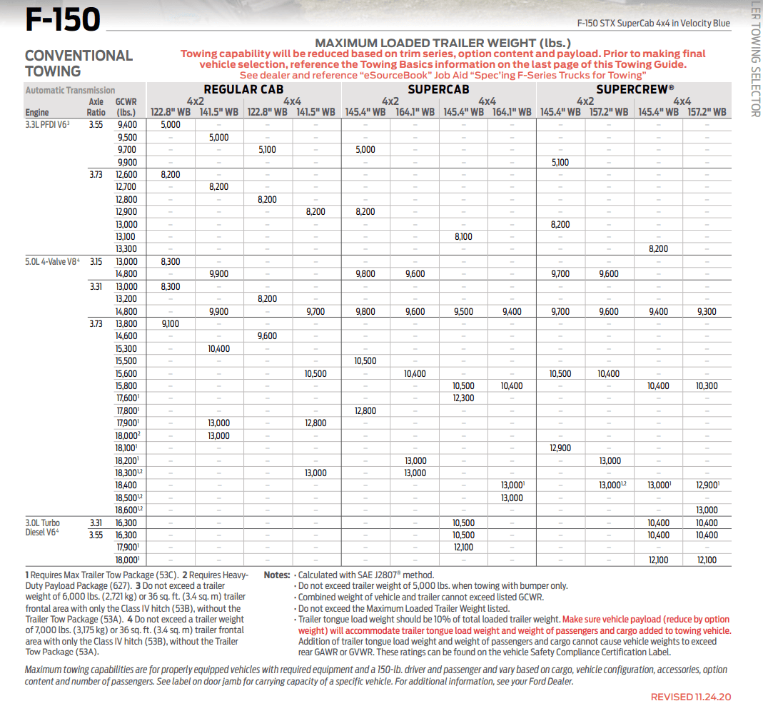

Yeah it does show that for the Max tow, though I am wondering if the upgraded radiator, trans cooler, and oil cooler are now standard in 2021. The 2020 had the coolers and the radiator as well as the front stabilizer bar. Though the 2021 doesn't show it in the towing guide.
2020 Tow Guide:
2021 Tow Guide:
Note that Aux. Auto Trans. Oil Cooler and Radiator upgrade are omitted from 2021.
I also see this in the towing guide:
5 Do not exceed a trailer weight
of 7,000 lbs. (3,175 kg) or 36 sq. ft. (3.4 sq. m) trailer frontal
area with only the Class IV hitch (53B), without the Trailer
Tow Package (53A).
Looking at the 3.5L Hybrid V6^5:
3.73: 17,000 = 11,000 towing.
My question is can I tow more than 7,000lbs with the Tow Technology Package (17T) or do I need to get the Max Tow or Trailer Tow Package to pull up to the theoretical max of 11,000+ lbs? As the tow guide doesn't show any updated coolers, then what does the Trailer Tow and Max Tow do to give you to tow above 7,000lbs? I currently see nothing that would prevent me from doing it as the Lariat comes equipped with Class 4 and 7pin. Other than the small disclaimer about not towing more than 7,000lbs w/o Trailer Tow or Max Tow, I am trying to figure out if this is a miss print or is there something else that has been omitted?
Note: I know payload is going to be limitation and I won't tow 11,000. Though I do tow boats that can be as low as 6% tongue weight and I want to fully understand what I am buying.

I'm not sure what the upgraded bumper adds on the max tow. I've never towed anything with the ball on the bumper. Only in the receiver hitch.
On my 2017 it had a different (slower) steering rack, larger front sway bar, coolers, Springs and a different receiver hitch if I remember correctly.
solarity
Dec 8, 2020
178
Western NY
Acura MDX
It seems to mean an upgraded/thicker frame.
