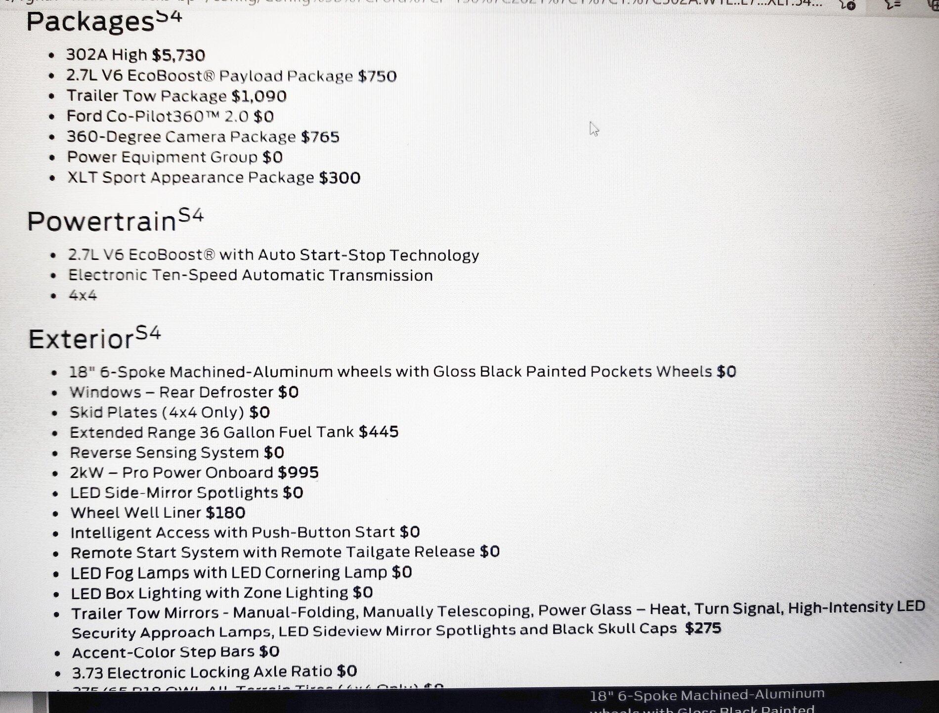

For the life of me I can not get a definitive answer from the dealer on the payload and towing capacity of this setup. It would be a crew cab 4x4 short bed , 2.7L payload package, trailer tow package, with 3.73 gears,9.75 diff. The dealer keeps pushing me towards a 3.5L with the max tow package. Most I would ever tow is a 24ft travel trailer 5,000lbs dry 6,900 gross.
Ford F-150 Lightning Tow Package Breakdown For 2021 F-150 IMG_20210410_183022__01__01
Go big, at the very least get the max tow package but I would also get the 3.5l. RVs have a habit of getting bigger after a few years.... speaking from experience.
