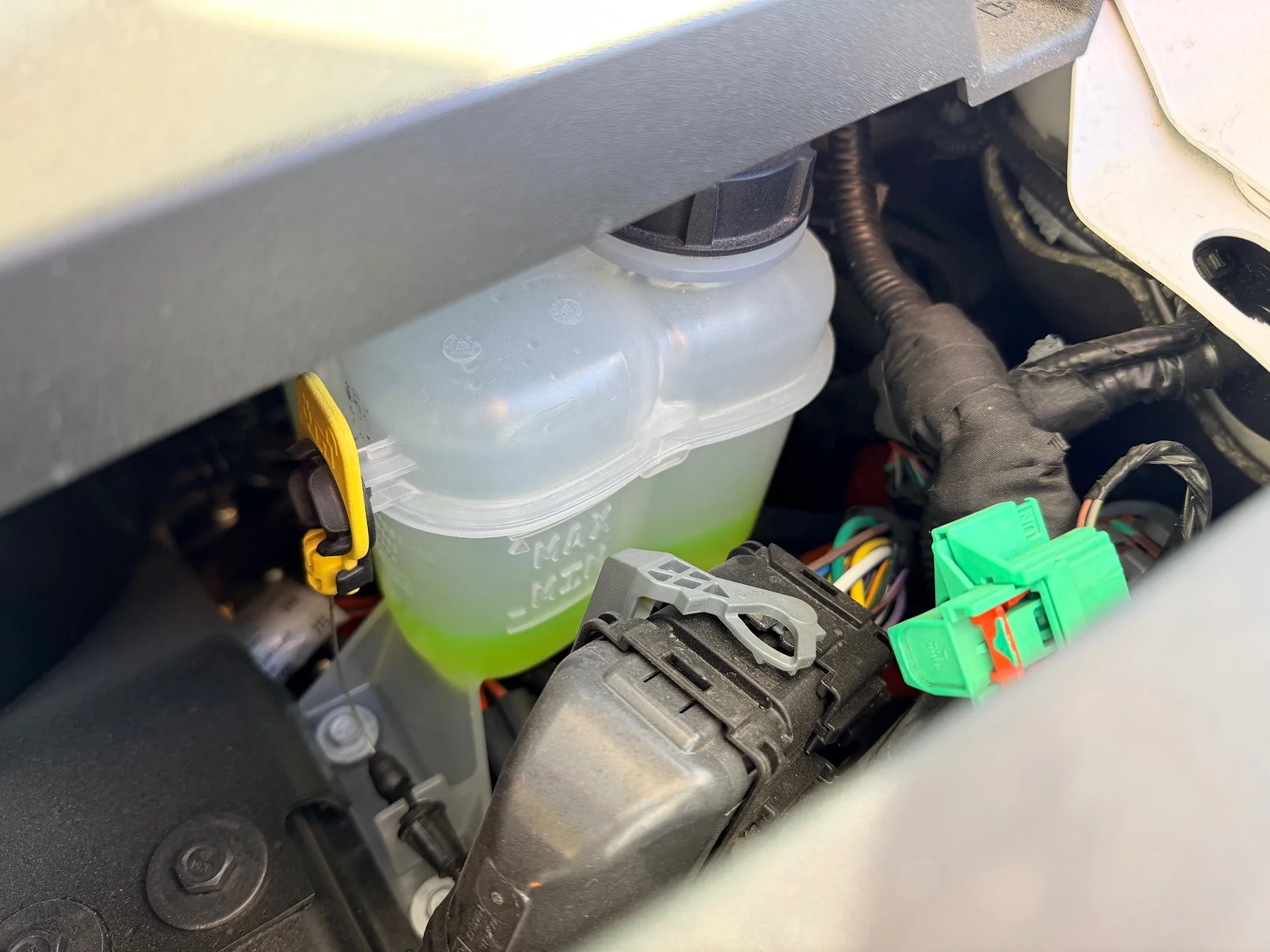

I recently saw this solution on a Facebook forum so maybe it’s worth a shot.
Ford F-150 Lightning Truck wont DCFC, but will AC IMG_4921
the pull plug they are talking about is yellow. The green pull plug is the high voltage disconnect.

Here’s a picture of what that Facebook post is talking about. Disconnect that green plug in the right. Then pop the yellow pull tab off the coolant reservoir and pull to release the pin.
Ford F-150 Lightning Truck wont DCFC, but will AC IMG_0305
I'm going to screen shot this and try. At least a good option to have in my back pocket, thanks!
Awesome, thank you!!

With the recent ultra-cold weather, snow, freezing rain, etc. much of the US has seen, I'd bet freezing. I'd try to warm up the pin (at the top of the port), then try the manual release cable as suggested above (gently), and then head to a known good DC Fast Charger and try it again.
If that works, I'd consider the weather cover (there's an official Ford one) for outdoor L1/L2 charging in this winter weather.
You bet. And then plug the green connector back in when you're done. Forgot to mention that lol.
Disconnecting that plug disables the high voltage system in a safe manner. The below page is from Ford's guide to the Lightning for emergency responders.
