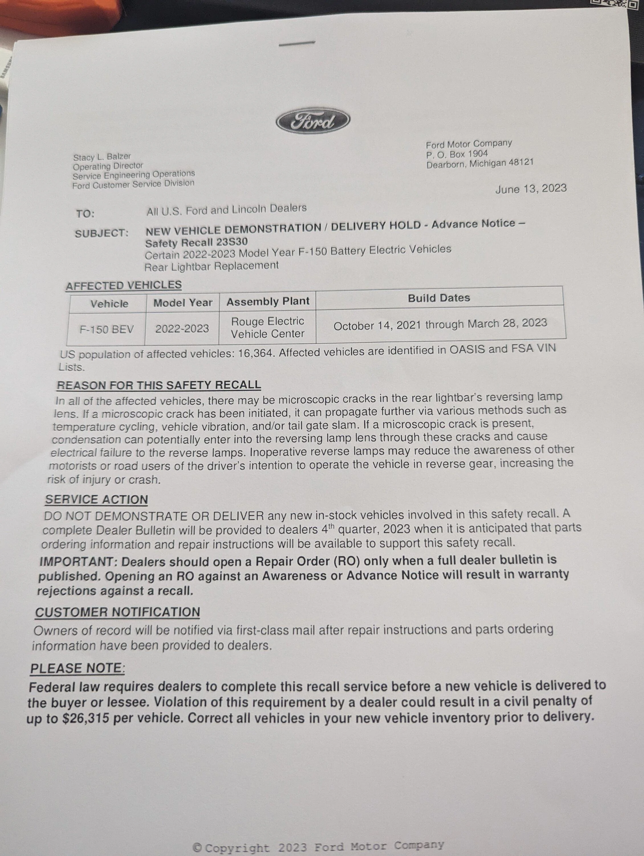

Yesterday I dropped off my Lariat Lightning to replace the rear light bar due to the infamous moisture condensation on the inside. They had the new part ready to put on, but called me this morning saying that within the last couple of days Ford issued a recall on the lights due to micro cracks in the plastic.
They've been informed that they are not to replace the light bar as that replacement has the same issue.
Ford will be replacing the light bars with updated parts that do not contain those cracks at a later date and the dealer will call me once Ford has the part available. This has now been confirmed.

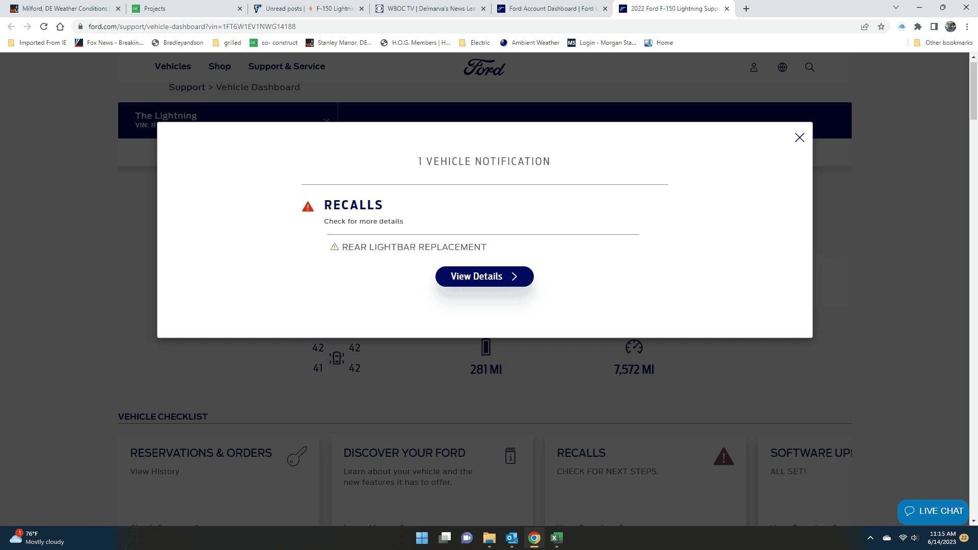

Yesterday I dropped off my Lariat Lightning to replace the rear light bar due to the infamous moisture condensation on the inside. They had the new part ready to put on, but called me this morning saying that within the last couple of days Ford issued a recall on the lights due to micro cracks in the plastic. They've been informed that they are not to replace the light bar as that replacement has the same issue. Ford will be replacing the light bars with updated parts that do not contain those cracks at a later date and the dealer will call me once Ford has the part available. Now, we all know that dealers don't always tell the truth or know what is going on, so, I'd like to get confirmation that this is the case. Perhaps a dealer is on here that can pull up the recall notice to dealers to confirm and perhaps give a little more information?
Yep, it' true
Ford F-150 Lightning TSB/Safety Recall 23S30: Rear Light bar Replacement for 2022-23 F-150 Lightning Screenshot (74)

The re
Yesterday I dropped off my Lariat Lightning to replace the rear light bar due to the infamous moisture condensation on the inside. They had the new part ready to put on, but called me this morning saying that within the last couple of days Ford issued a recall on the lights due to micro cracks in the plastic. They've been informed that they are not to replace the light bar as that replacement has the same issue. Ford will be replacing the light bars with updated parts that do not contain those cracks at a later date and the dealer will call me once Ford has the part available. This has now been confirmed.
The recall notice says that the reverse light can be affected too. They should have replaced it. What if also stops working? That light bar was not needed at all…

Dayammn... Maybe this restriction largely involves unsold mannequins among the first 16,364 trucks.
SERVICE ACTION
DO NOT DEMONSTRATE OR DELIVER any new in-stock vehicles involved in this safety recall. A complete Dealer Bulletin will be provided to dealers 4 quarter, 2023 when it is anticipated that parts ordering information and repair instructions will be available to support this safety recall.
