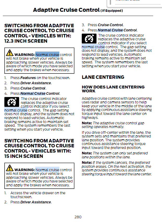

On a long drive my front sensor got blocked so I couldnt use the adaptive cruise control. What I cant seem to figure out is how to revert to standard cruise control so that I can keep using it. Is this even possible?

Thank you. I spent far too long trying to read through the manual on the truck screen and couldn't find that.
