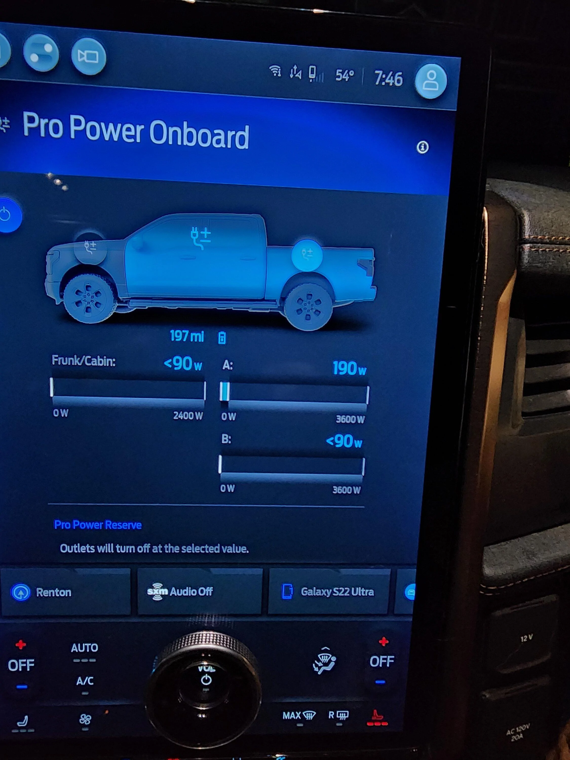

What were you running off of the 220 plug? The past weekend I sold my Honda 2000i generator and my Ego power station. I used the Lightning to work on my green house a couple of months ago. Love the onboard power!

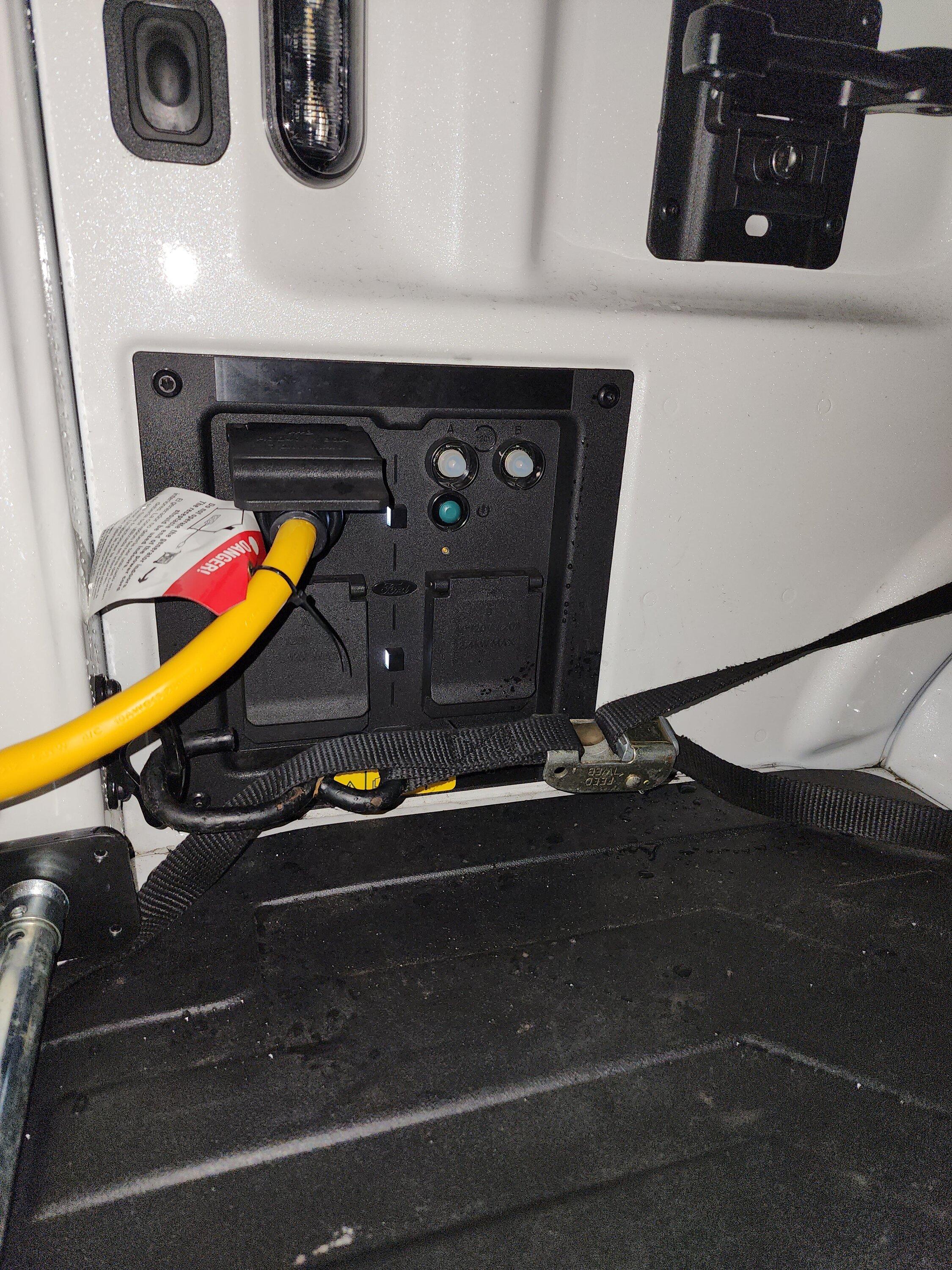

Yes, i have a cord that does 240 30A twistlock to 4 120v outlets...or 220/110 if you prefer to say it that way.
I think it is this cord even though I don't think I bought it at Wallymart..(I don't go to that store).
https://www.walmart.com/ip/Champion...d_id=612734&campaign_id=9383&sharedid=6080654
I need to install the Generac gene panel so I can just do that in the future...

Not sure but it did seem to split power according to truck screen.
I think you could run the outlets in the frunk n bed at the same time 3600+3600+2400=9600

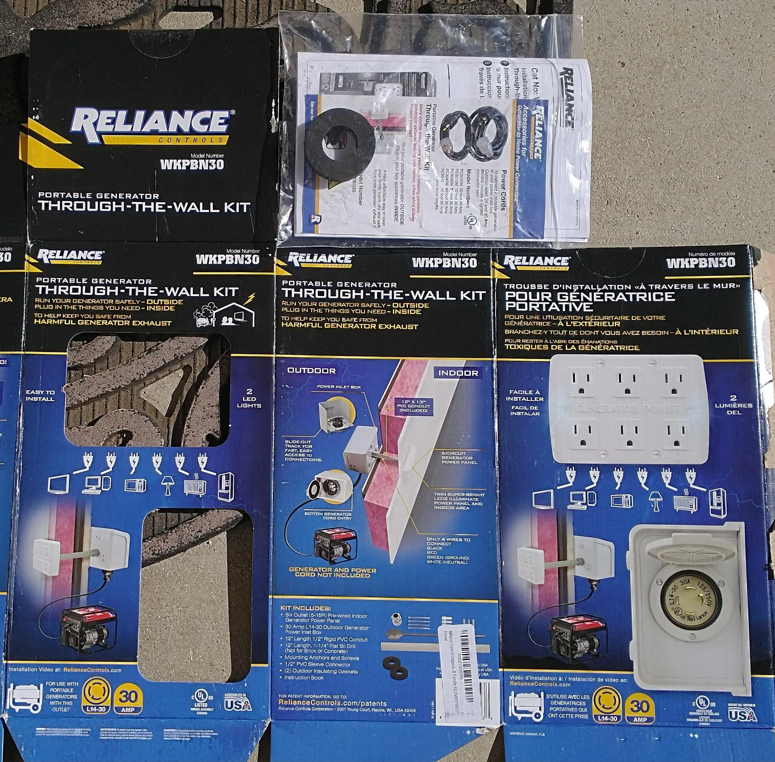

This Reliance Control Corporation WKPBN30 Portable Generator Through-The-Wall kit is a nice, safe way to go to avoid cords running under doors or through windows:
https://www.amazon.com/gp/product/B0743BQDT4/ref=ppx_yo_dt_b_search_asin_title?ie=UTF8&psc=1
Ford F-150 Lightning Power out. All good. No noise! Pro Power Onboard to the rescue IMG_20221124_114506120~2 model box WKPBN30 Reliance Controls Through the Wall transfer switch
changes the 240V to six 120V (2 groups of 3, splitting the 2 hot lines of the 240) receptacles. Just hate running cords through the house, but hate power loss more!
Eventually set up a dangerous backfeed to the house main panel, but I am a very careful electrician with a written checklist.
The Pro Power system will trip quickly if it does not like what it sees downstream.
