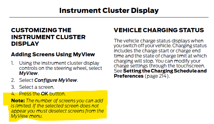

As best I can tell, the Calm Screen is the only way to access the essential State of Charge or battery % info. However, since getting my truck back from the dealer after a recall service, when I select "MyView" in the instrument console menu (where the Calm Screen resides), I only get a "Configure MyView" screen. No matter how many times I configure MyView to show the Calm Screen, I can never actually get the Calm Screen - only the "Configure MyView" screen. Therefore I am driving blind with no way to know how much charge I have available. I live in mountainous terrain so the mileage estimate is useless, as the machine has no way to know if I will be driving level or up a steep slope. Anybody know how I can escape the endless "configure" loop and get my Calm Screen? Or is there some other screen where SOC can be accessed? Crazy that it's not also available on the big touch screen through the Settings or Features menu.

While in the configure my view, un-select several of the features, leave most un-checked, then select one or two only, then scroll up/down the list of available features, hopefully you see them along with the calm screen.

Yes, did that a dozen or so times. Always end up stuck in the Configure screen.

Thanks, Noel, but that's not the issue. There is no chance to select Calm screen anymore. Calm screen is only accessed through MyView, but selecting MyView always brings up the Configure menu now. Before the recent service I would select MyView, then select Calm, then it would take a few seconds to switch to the Calm screen, as you describe.
So if you select MyView and get Configure, does that mean you also can't see other screens like This Trip, Tire Pressure, etc.?
I was getting getting those screens, but I just went out to confirm that. About the fourth time cycling through the menu looking for them, the Calm screen reappeared just as mysteriously as it had disappeared. So I have it back now. Thank you for prompting me to push those buttons enough times that the goofy software reset.

Try this: 1) start the truck 2) press menu 3) click MyView 4) DO NOT click OK to add or remove screens 5) Instead, press down button on steering wheel until you get to it. If it was checked in MyView you will see it. 6) press OK and it will come up. When you restart the truck it should be on the calm screen and stay there until you select another screen. If you scroll through and it is not there then Follow steps 1, 2, 3 and 4 except click OK to add or remove screens to add it then start again at step one and you should be set.

Well, I did at one point have my Calm screen back, I think through the method that rhscnative describes above (Thank You, Gil). Then I got an update (ECG-24.2.4.9 or 1237323-1709671) and my Calm screen disappeared again. Now if I click on MyView, the only option shown is Driver Assistance. Scrolling down never yields a Calm Screen, and there is no option to configure MyView anymore. So I am stuck with the standard dash display, which does show a blue bar graph on the right indicating the battery state, but does not display a % number next to it, as it does on other owners' screens. The dealer and my touch screen both tell me there are no other updates available, so it doesn't appear that there is anyway for me to get a battery % display on my dash screen. Why is Ford so determined to prevent us from easily accessing this info? For now I guess I will just have to keep scrolling through the Touch Screen settings to Charge Settings to check my battery state.
