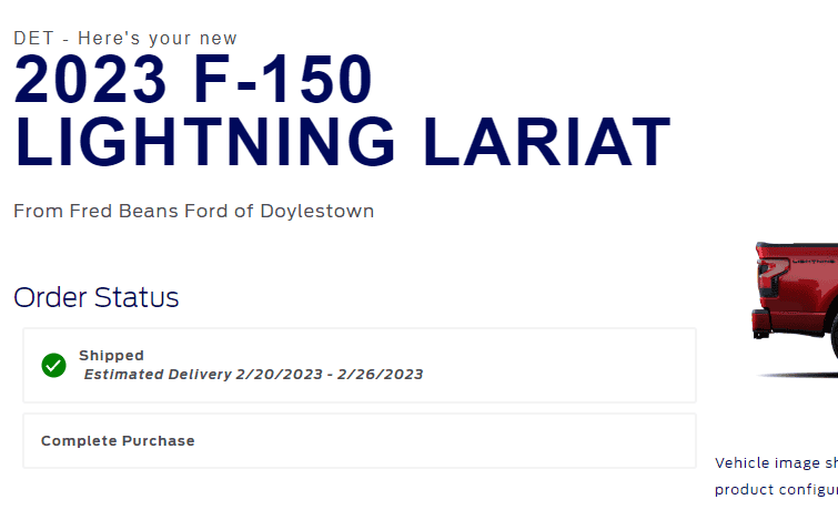

It looks like they are starting to release trucks that were stopped in transit. The delivery date of mine got moved up a week (it was supposed to be this week).
Mine was changed to 2/17-2/23 but now this evening went to 2/18-2/24
