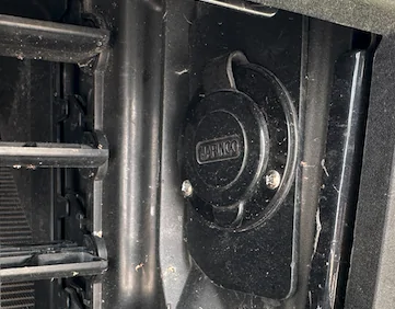

how do you trickle charge with the frunk closed
I simply closed the frunk on the extension cord initially. After that I permanently mounted a battery maintainer on the back of the access panel and ran a cord from the 12v battery bay to a permanently installed 120v socket in the front air scoop. I plug it in any time I'm not going to drive for a couple of days.

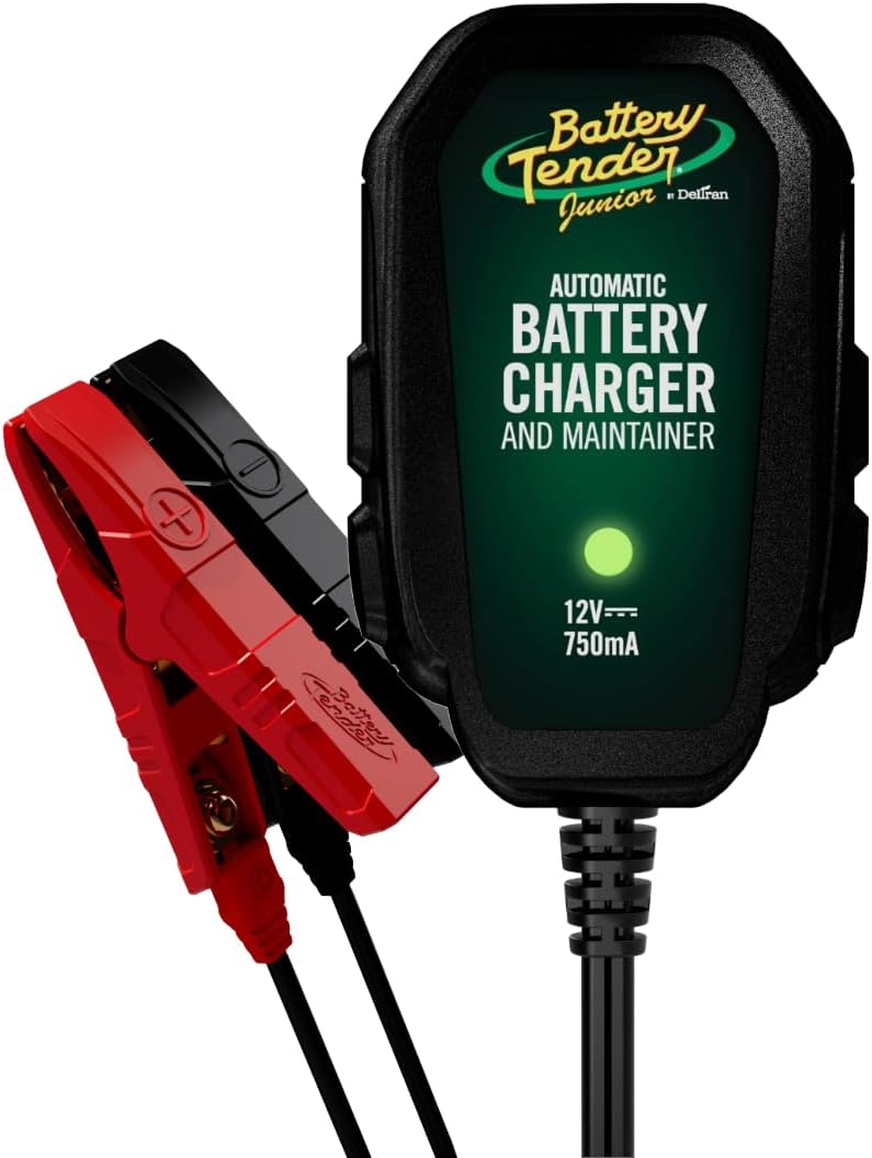

You should all have one of these and use it at the first sign that updates aren't going or every few months:
Battery Tender
Ford F-150 Lightning UPDATES NOT COMPLETING DUE TO BATTERY LEVEL 61nddgtbkaL._AC_SL1200_
GrokTime
Sean
Apr 19, 2022
162
Ithaca, NY
2022 F150 Lightning, Rivian R1S 1st Gen
Thanks everyone for your help. After trying everything else I finally bought the above Battery Tender Junior. I attached it to my battery and a few minutes later it turned to flashing green (battery at 80%) and a few minutes later solid green (battery at 100%).
I ran the update and it installed with no problems. Better yet, I was immediately offered Bluecruise 1.4 and ran that update and that succeeded as well! Finally!
However, in the end doesn't this mean that I need a new battery?

nothing worked for me. the tender never turned green. it read 14.4v when truck turned on and with truck off only read 12v. idk what im doing wrong. seems simple enough. plug it in, attach clamps at the points pictured in this thread then press the button. I must need a new battery. Its a 22. one of the first off the presses.
