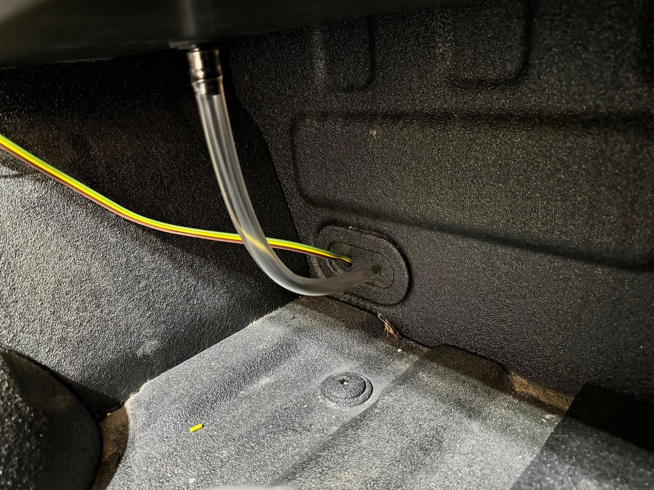

Where do you route the drain hose when your bed has a spray liner?

As I said above, I purchased the composite cover version. A bit lighter but it is only rated to 200lbs of weight on top of the cover versus the aluminum cover which can hold 400lbs. It is not watertight. Water does leak eventually in the bed. If you want your stuff to stay dry, purchase a cargo bag. The drain tubes need to point towards the forward corners of the truck bed. Water will drain out from the front of the bed. Do not drill holes into your bed. I also have the spray in liner, (factory done). The drain tubes are easily fall off when certain cargo which can fit under the rollup basket.
I have the factory spray-in liner, and I drilled through the same front plugs that she used for the wiring. It’s a tight fit with a 1/2” hole, but I wanted to keep it as small as possible to make it easier to plug if I ever remove the cover. It takes a bit for the drill to punch through the liner, but it’s nowhere near as difficult as drilling through metal.
