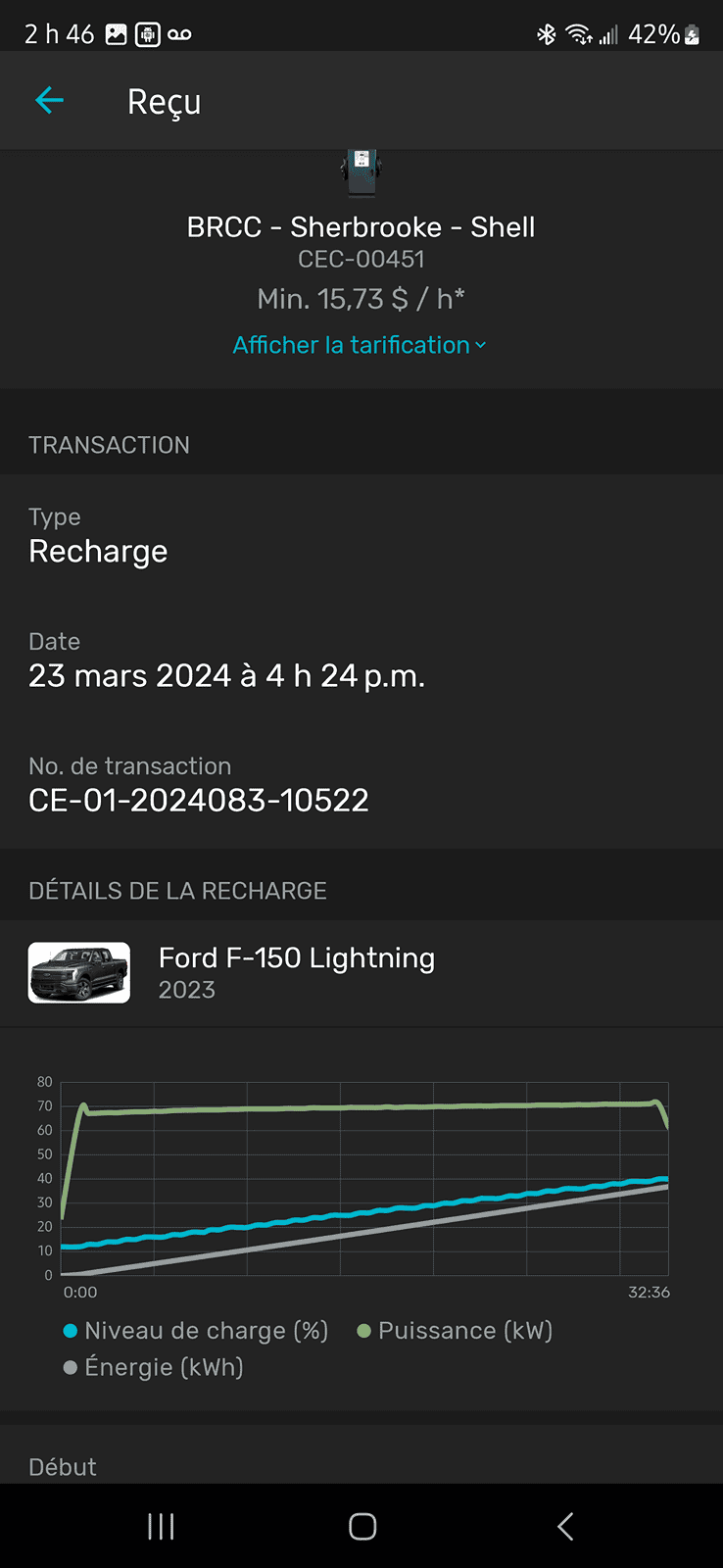

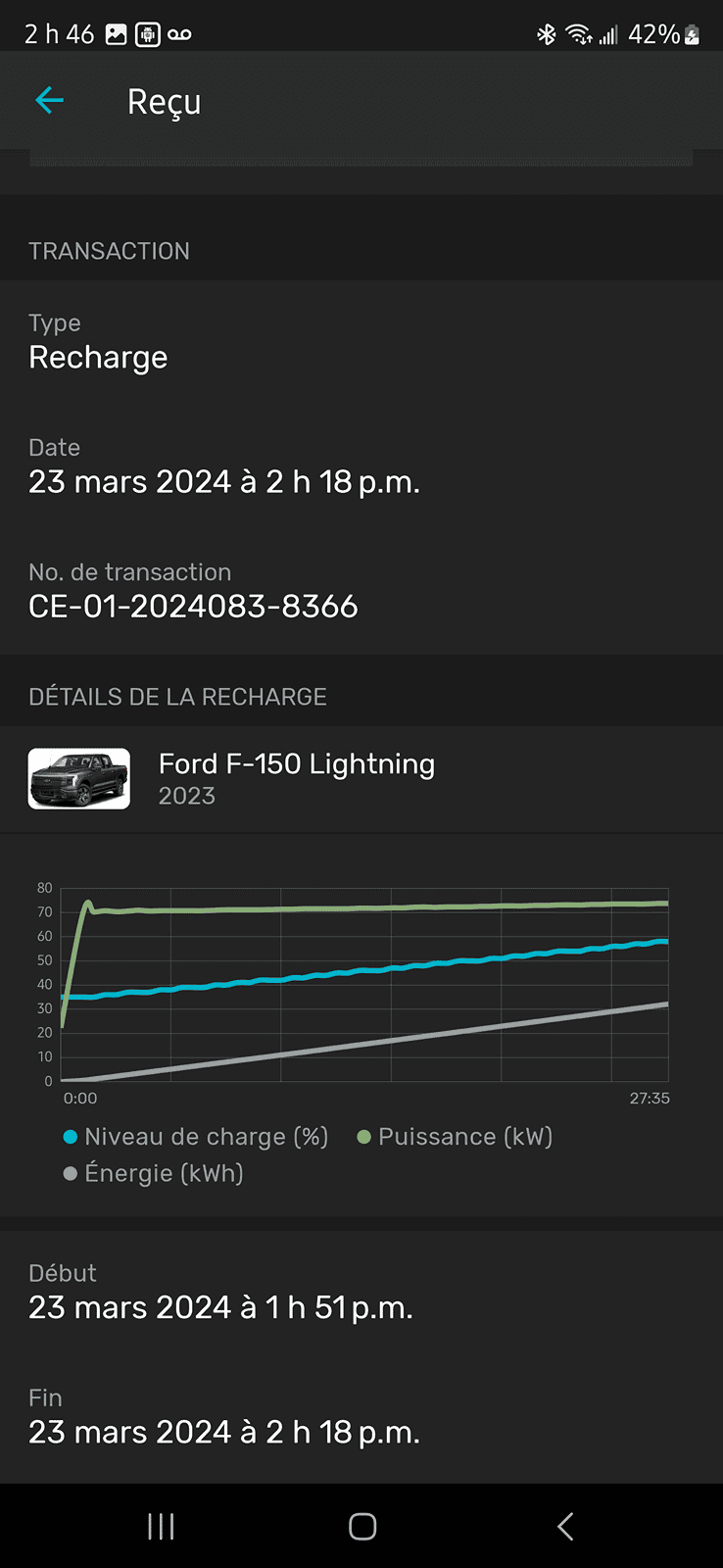

And if MIL it s ok its also normal that i M not be able to have an input over 70 kwh on different 100kwh fast charging stations?
Since the trip to the dealer.
You don't think that are to many bugs to consider all that as normals?

I just looked that location up and they are 100kW max chargers with 250 Amp max cables. Topping out in the 70s is what you should expect.
Nominal pack voltage is 370, right? At 250amps, I'd have expected closer to 90kW. When I used the 150kW EA stations (350 amps) on a road trip I average 132kW peak, which would be a battery pack voltage around 377 (this would be around 40% SoC). At 250amps, that should have given 90+kW. I know some units power share, so maybe that limited it? Or maybe a bad cable/sensor? (Common problems with EA, so in the realm of possibility hitting two different locations with poor equipment). I'm just thinking out loud for the sake of discussion. While don't think the OP has lost range, I do think it odd the dealer said the truck needed a module replaced and then didn't replace it.

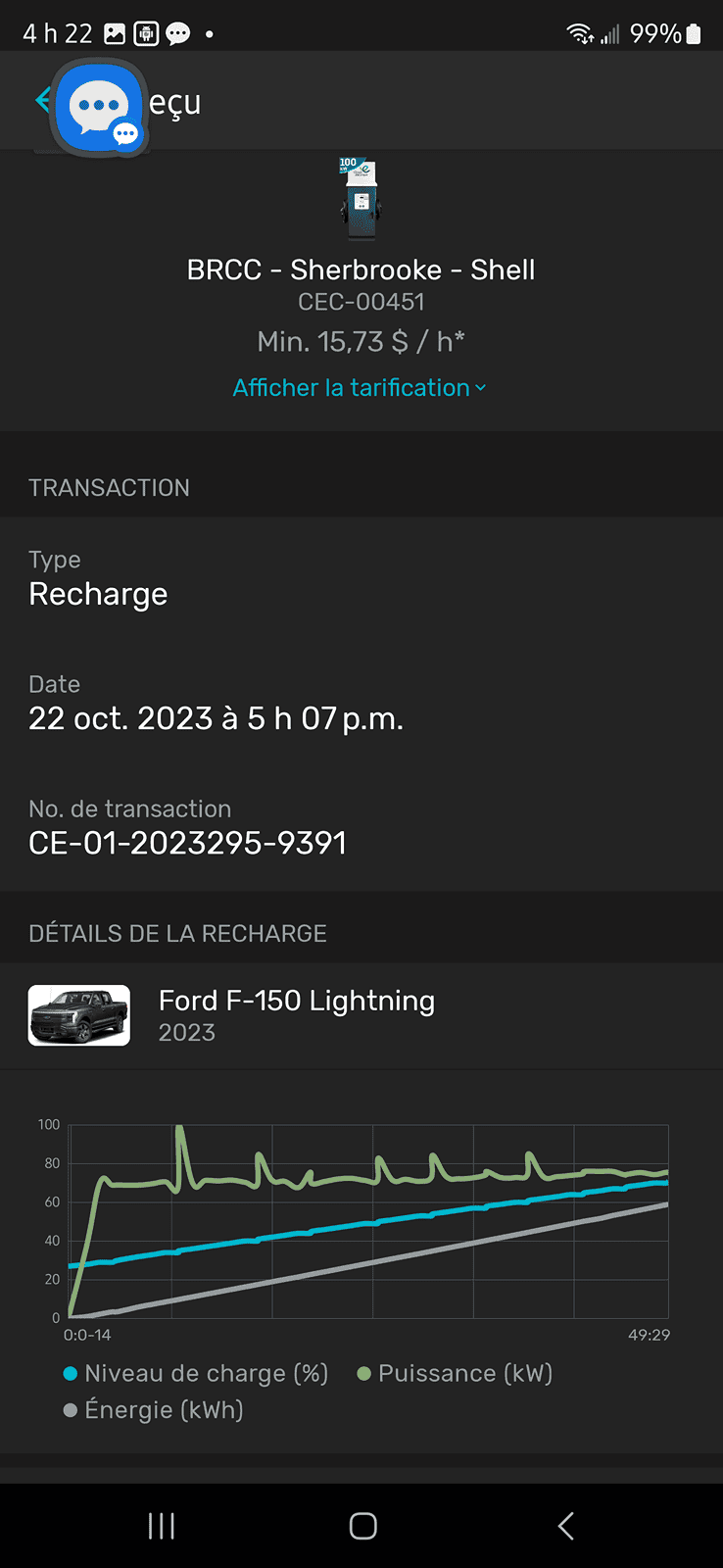

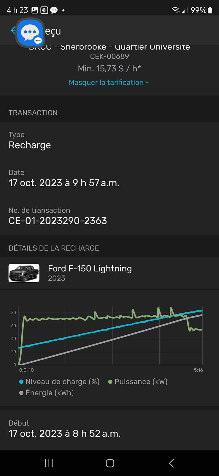

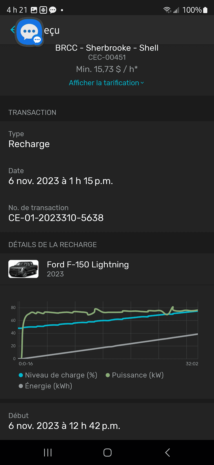

Before the dealer whit the same and other 100kwh charging station

So... basically the same normal charge rate in the 70s. These have super-inconsistent peaks that would worry me, and maybe what was fixed with the update. The charge curve in your previous post looks much healthier.
