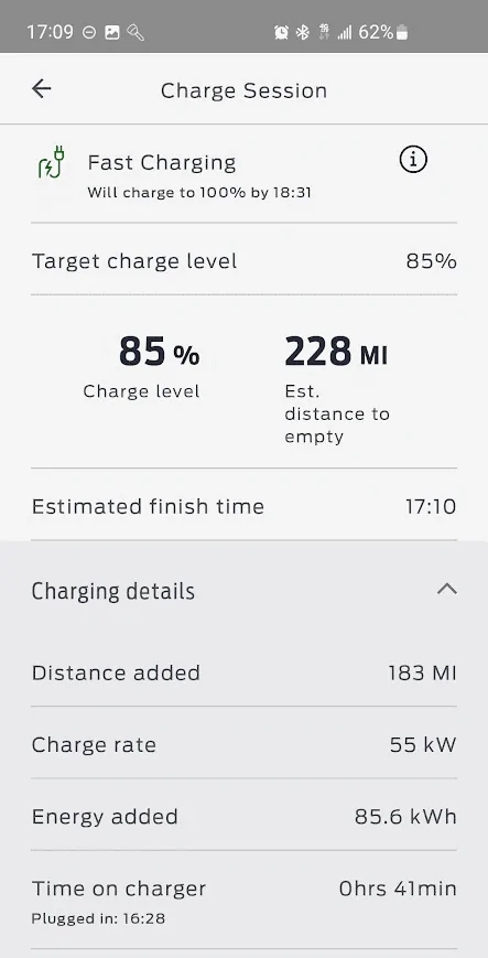

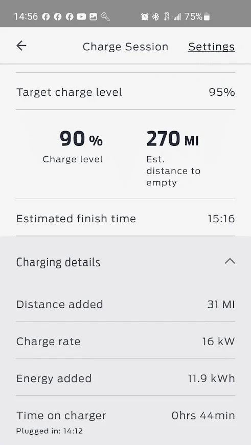

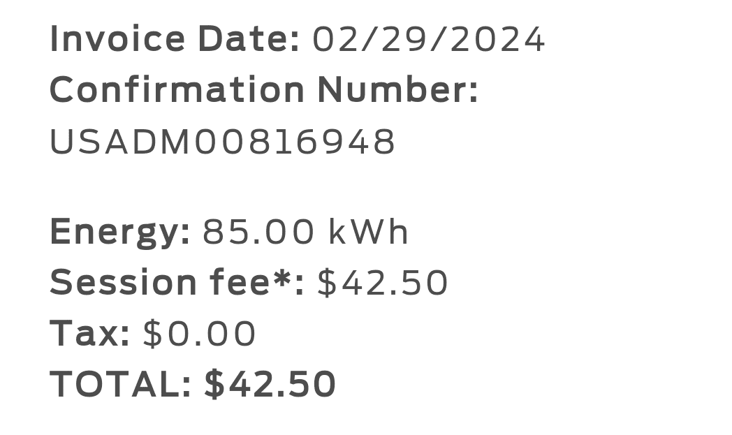

This was from my 2/29 NJ trip, at the end of the day it was chilly and I had fast charged it back to 85% at the local Tesla V3 station, billed by Tesla for 85 KWH
At 85% I had a projected range of only 228 miles, this value assumes 2.05 MPK (miles per kilowatt hour), I was running 2.0 on the instrument cluster after a 458 mile day.
2. MPK times 131 KWH fully charged battery, I might get as far as 262 miles, not the ideal 320 miles, the day was chilly low 30's, even with judicious use of heat I was still only getting about 82% of range compared to ideal conditions.
The lower half of the screen regarding my charging session indicated I received 85.6 KWH of energy and that increased my range by 183 miles, this implies a 2.14 MPK (a little optimistic) I've seen more exaggerated values of added range, do not use that as a measure of how far down the road you will actually go.

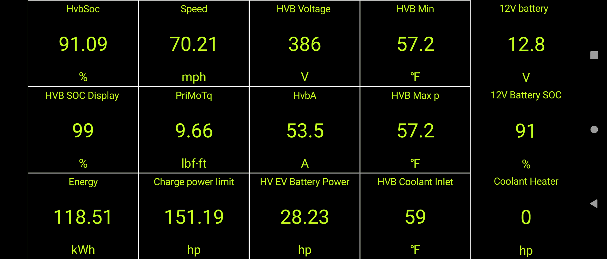

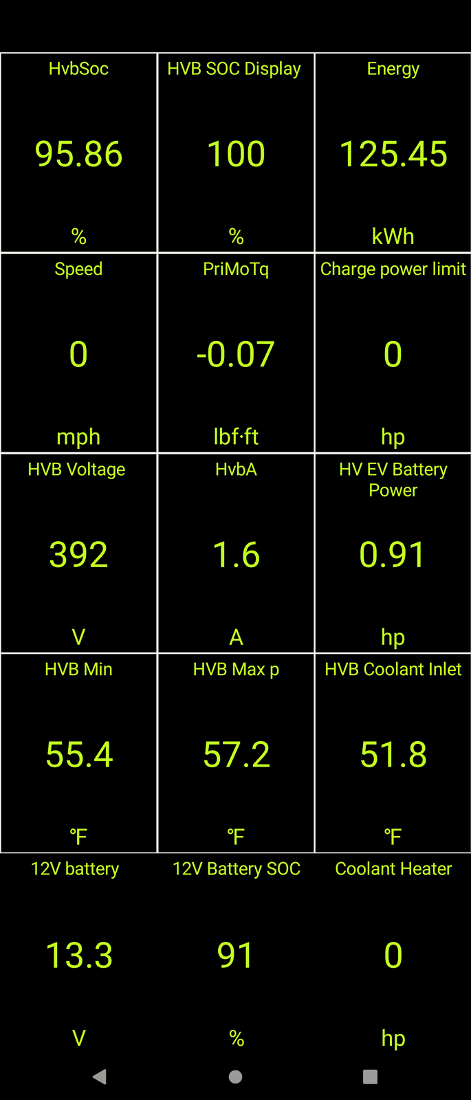

Here are a couple screenshots from car scanner showing actual versus displayed SOC at very high battery charge levels from a week ago. The truck was charging at a Kia dealership while I took an EV9 for an overnight test drive. The EV9 12V failed or the car had an iccu failure and they had to tow it back (4 days later). At least it failed in my driveway, not while out with my wife. Even so, Kia is off the list (or on the shit list) of cars that she will ever purchase. It was really our roadside assistance experience with them that cemented our feelings.
I am now sitting on pins and needles wondering which fail I’ll get first, the lightning module issue or the Kia EV6 ICCU 12 V fail. Seems several of the Kia EV models are having an issue with their onboard charging unit. NTSHA just issued a safety recall for several Kia and Hyundai models including the EV6 and EV9.
So Ford is definitely not alone in this arena.

I plugged in after driving home at 83 percent and the EV9 and my evse made happy charging sounds, then 30 seconds later more sounds and charging stopped with maybe 10Wh delivered. I tried 4 EVSEs (flo x2 mine and wife's, old clipper creek 20Amp unit and FCSP). Then I started getting 12V warnings and stop safely, electric system service required, lots of beeping. I know my lightning could do the same thing, but in 9k miles it hasn't and in 48 miles the EV9 gt-line did.
It’s disappointing to see these ICCU failures with the KIA’s since it has been a known issue since the 2022 model came out. Seems KIA tried a CSP, but that program as apparently collapsed and now NHSTA has imposed a recall. Unfortunately, the letters and dealer fix isn’t coming until sometime in April.

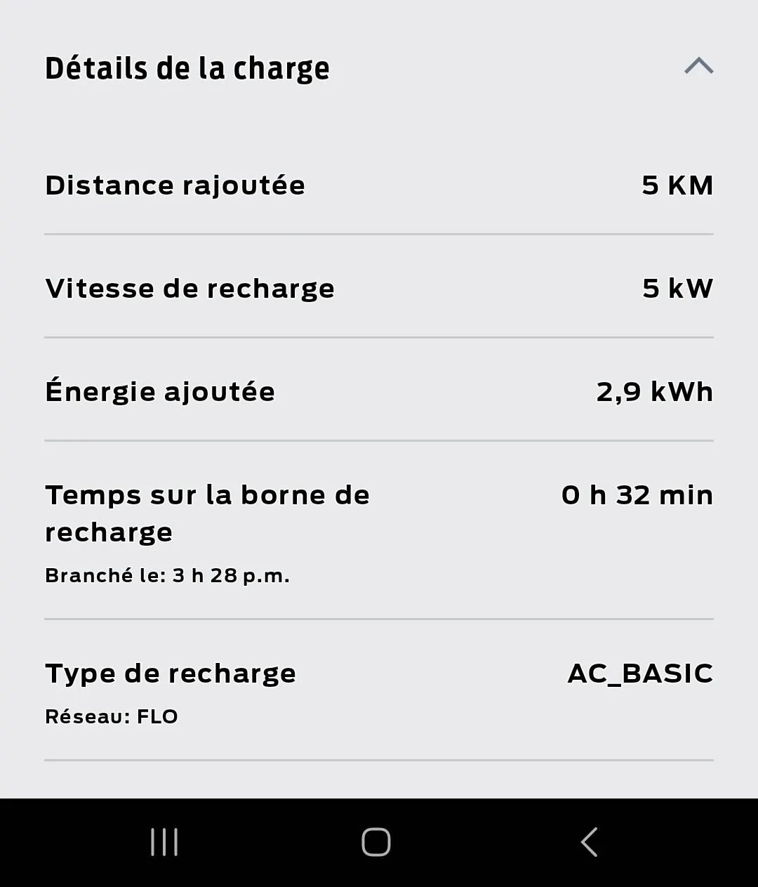

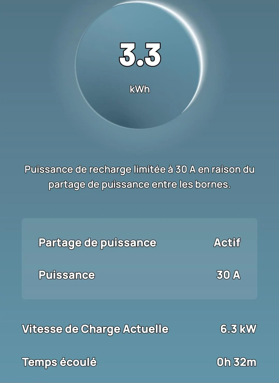

Are you serious, or are you on Ford's payroll? ?
100k Canadian for that scrap... with 3 recalls in 5 months and with this load of scrap codes probably linked to inflation. ? #FordFail
That gives me confidence in the future... and the worst is that it's normal, I have more explanation on the situation here? nothing by Ford? #WhatsTheDealFord
Another thing, if all is normal...
Sometimes My Weather on Sync locates me in Chicago... (I'm in Montreal, btw) ? #SyncFail
Whatever the charging station... my pickup doesn't take all the input... ? #ChargingIssues
See the picks
But my MIL is ok ... so... good product A1.
Come on
Ford F-150 Lightning Waiting 5 months for module replacement / end with an update and less miles Screenshot_20240202_160103_FordPass
Ford F-150 Lightning Waiting 5 months for module replacement / end with an update and less miles Resized_Screenshot_20240202_160111_FLO_1706907999859
211
15,635
17,483
See the picks

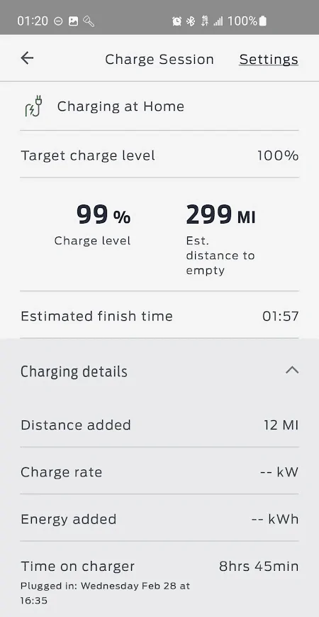

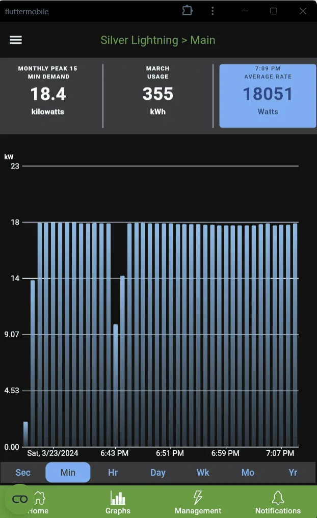

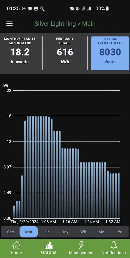

No, I'm not an employee of the MoCo, I'm life long Ford customer who understands his truck, when my Lighting is charging on home AC, at 80 amp 240 volt service, it ~NEVER~ shows an energy input of 19.2 KW which is the theoretical value, no one has seen that value.
The reality is, that I'm pulling about 16 KW according to Fordpass, but in reality it's pulling around 18 KW, ie the App is off calibration displaying only 89% [16/18] of reality, and that reality is only 94% [18/19.2] of theoretical maximum energy flow, many of us have observed the same factors, nothing is broken, all is working fine.
Ford F-150 Lightning Waiting 5 months for module replacement / end with an update and less miles 1711250447191-9m
Ford F-150 Lightning Waiting 5 months for module replacement / end with an update and less miles 1711250756433-ld
Your values are in line though at the 30 amp x 240 volt, factor perfect energy flow would be 7.2 KW, you're seeing a 5 KW rate in Fordpass, while your Actuelle value is showing 6.3 KW, which is 88% of perfect, were you charging above 95% SOC?
The only time I've seen the rate slow down is when charging well above 95%, the last few percentage points of charging slows because the truck asks for a slower rate, the last 35 minutes it tapered as the SOC neared 100%
Notice, I'm promised only 299 OPTIMISTIC miles with a fully conditioned (warmed) battery not 320, this is due to frigid conditions.
Ford F-150 Lightning Waiting 5 months for module replacement / end with an update and less miles 1711251371740-t1
Ford F-150 Lightning Waiting 5 months for module replacement / end with an update and less miles 1711251410794-k7
Finally, has the GPS system in your truck been confirmed to be accurately locating the true position?
There have been a rare few trucks with bad wiring, antenna connections and other component failures, get that checked out if your map system is grossly inaccurate .
Good Luck, I'm done.
