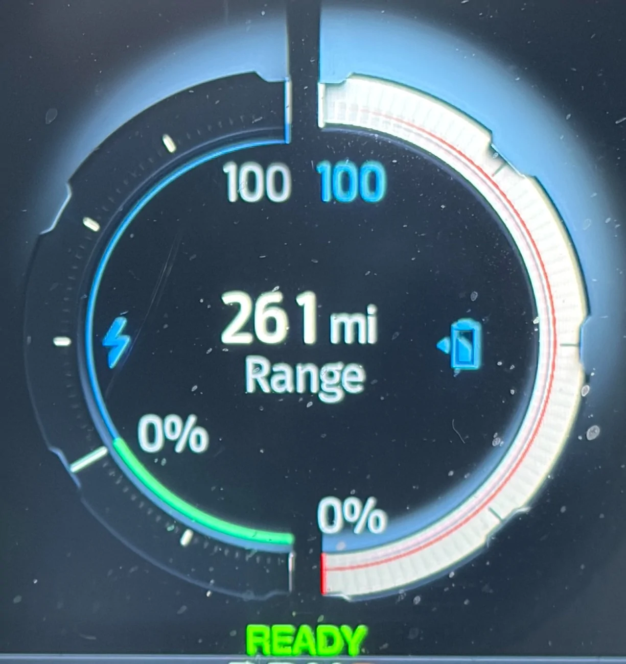

drove more today, and everything seems absolutely successful, with not a single issue - you wouldn't know that anything has 'changed', although you'd certainly know if you see the photos of the truck up in the air, the whole battery pack removed, and the time it took to get the technology back in place... I'll give kudos to the EV tech at the dealer, whether he knew enough to start with, or whether he learned a lot in the process...
After hearing Jim Farley talk about the lack of EV techs, and even ANY vehicle shop techs, or lack of them in the marketplace, and how long most folks are having to wait, even weeks to even get seem, maybe I am blessed the whole process 'only' took 2 1/2.
no, I don't have a method to find the 'SOC' % within the battery pack, but the 'range' estimate at 100% of 260+ miles tells me that everything is just fine...
I also checked the coolant bottle level, and it seems perfect... I have a planned follow-up on Tuesday for a 60,000 miles FORD checkup - the coolant level is a prime question. Interestingly, when I first arrived home and charged, I happened to be outside near the truck when the 'converter' sound kicked on... which I've heard many times before. What was DIFFERENT this time, though, was a loud 'gurgling' sound, as though also water was 'flowing' thru pipes... very new sound.
I fell down on the ground and looked under the truck - nothing. No leaks. No water. nothing... the converter sound ended, and then the gurgling stopped. It happened again several minutes later. It stopped then, too.
So, I am going to chalk this one up to the newly charged system getting back to 'normal'... but, we'll also see if the EV Tech confirms on Tuesday.
In all my time driving since picking it up, the Coolant LEVEL indicator has been consistently on the mark, with nothing to indicate any issue.
That is likely the sound of some air left in the cooling lines. Keep a daily eye on that coolant level.
