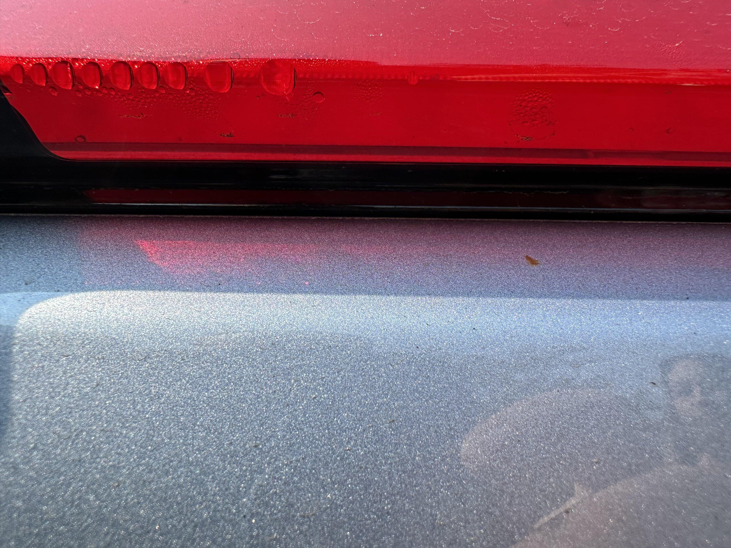

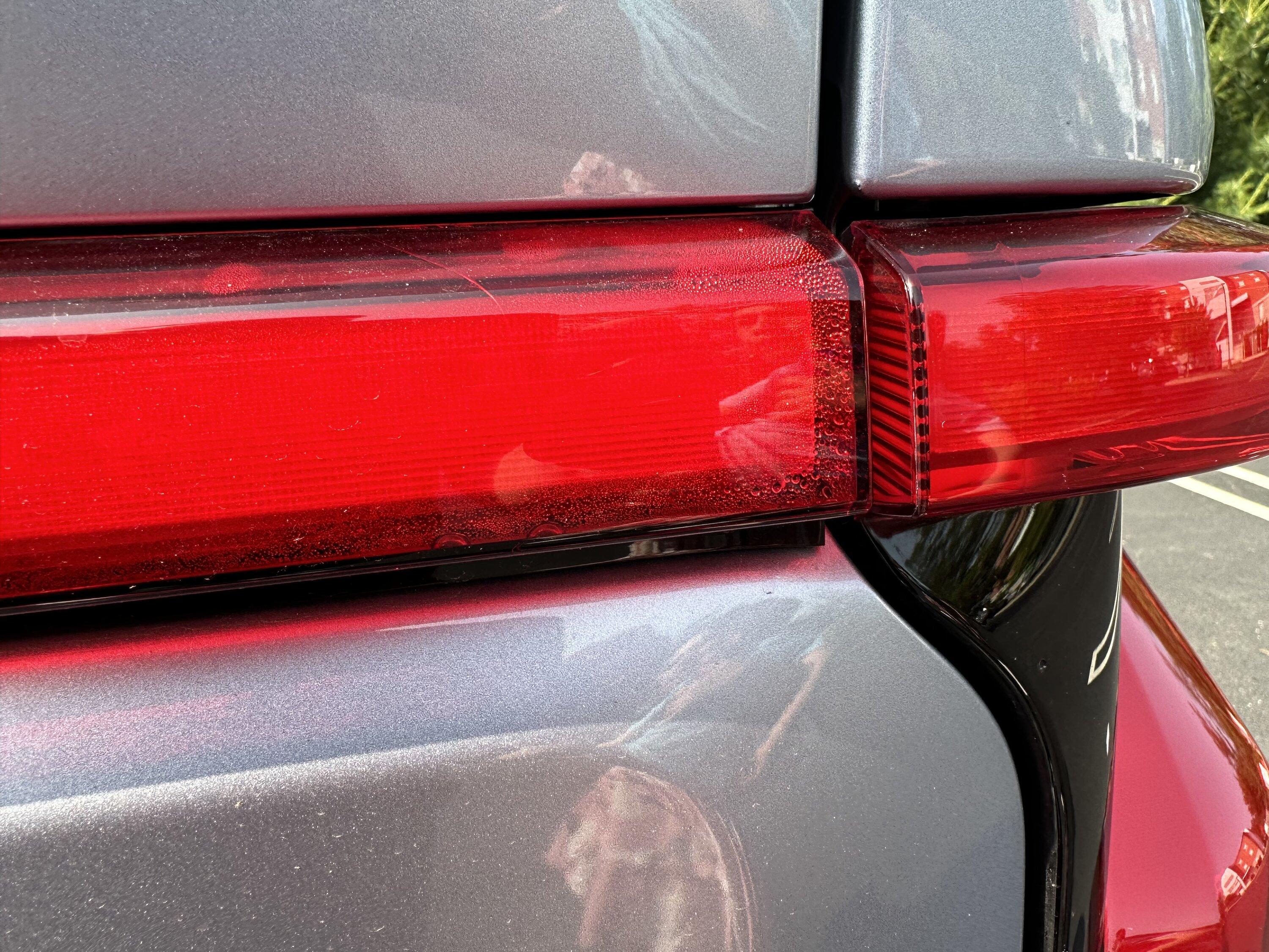

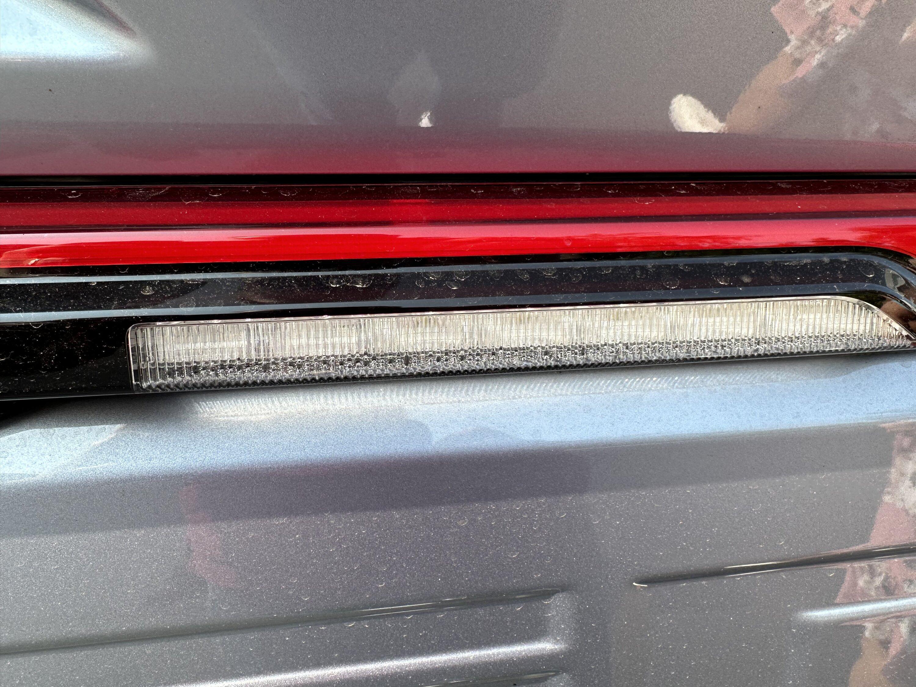

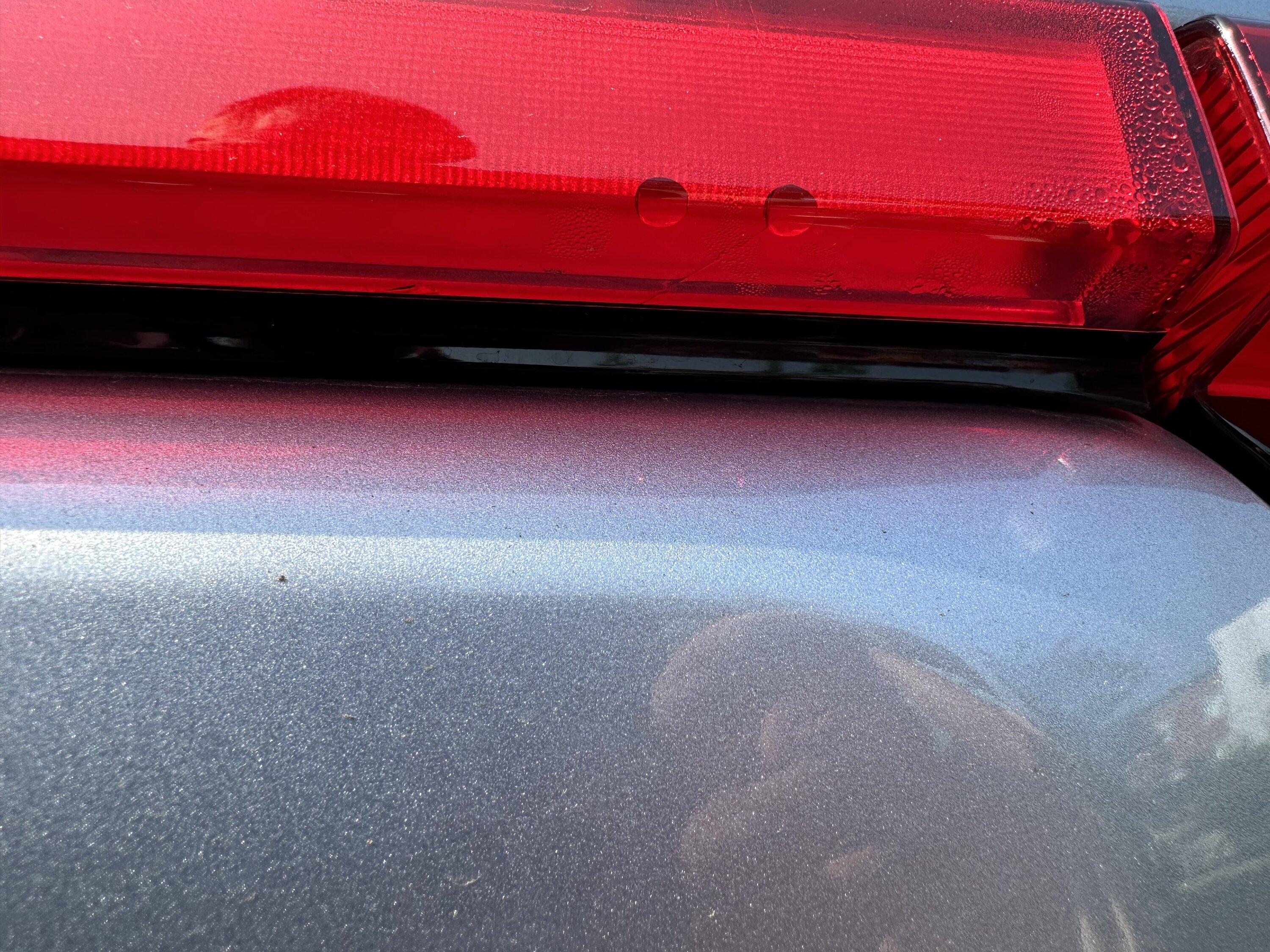

Oh well… I thought I was going to be lucky when it came to this issue but I guess I was wrong. It just rained out this morning, and now I see drops of water in the light bar. As a force of habit, I always checked the light bar after storms or car washes, and this is the first time I notice this issue in nearly a year since I owned the truck.
Can we disconnect the connection if it starts to freak out? I know we will lose the rear camera, but not sure about what else.
Also a FYI under the new recall:
A new rear lightbar assembly (Part Number NL34-13N466-AE) will be installed to replace the recalled component (Part Number NL34-13N466-AC).
