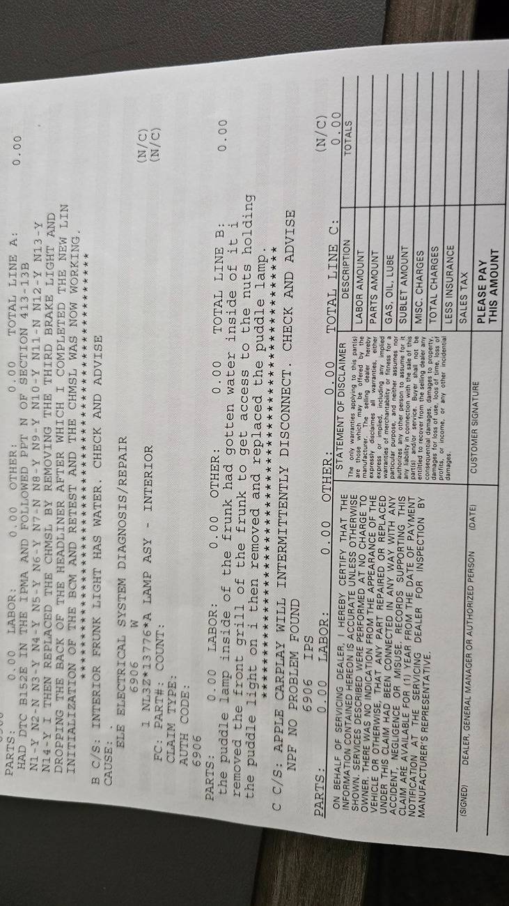

New update
Got the truck back today. Tech replace lamp under warranty and also reprogrammed the FHCM module at the same time. All under warranty nothing out of pocket.
Picture below of the Ford tech notes:

Nice, I gotta get mine back into the dealer.
