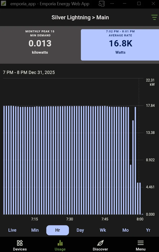

One thing to remember about the taper profile, I agree that a 'healthy' battery pack will show the current slowing after 98% on a level 2 charging EVSE at 80 amp and lower capacities.
But it's possible Ford has programmed the BMS to behave more cautiously when one module is substantially out of calibration to the rest of the original pack, cautiously slowing the charging rate should resolve once all modules are in alignment, 22 days was the stated time frame, yet the OP had work done in October, so at this point 60+ days have elapsed, why hasn't the battery reached a balanced condition by now?
New years eve charging back to 90%, note the last hour by the minute approaching 90%
