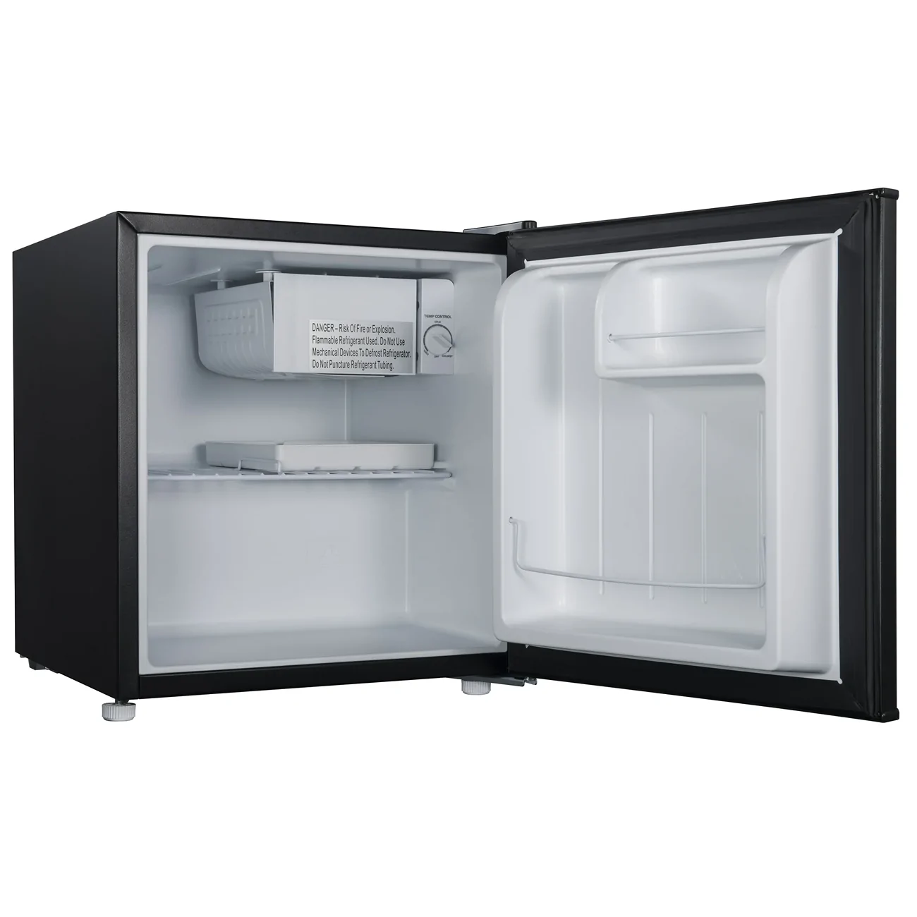

since day one, I've used the simple Walmart 120v mini-fridge, which sits behind my driver seat, or fits completely underneath the bed's tri-fold hard cover, plugged into either 120v outlet...
my wife and I had this conversation the other day: but 'what' happens when you turn the truck off?
- well, if you are simply going into a store for a few minutes, or a little while, or even longer, just leave the truck ON. I lock the door when I walk away - the fridge is still using ProPower.
- if you have to, and can't leave the truck ON, well, the fridge is already a big 'cooler', and doesn't need power 24/7... even for hours. Most fridge compressors don't run constantly, anyway - they run 'as needed' for the temp. Even if the temp falls below 'normal', it's not the end of the world. When you return, and turn the truck ON, the fridge will quickly get back down to it's optimal temp.
- if you 'must' turn the truck OFF, well, newer models provide for the ProPower setting to remain ON, if you need
I've left our truck ON overnight many times - to keep ProPower ON, even to power our Camper... it's no issue. Lock the door. Cover the driver screen, if you must... It's all good.
I don't understand the need for expensive 12v 'fridges' that have to 'fit' into your frunk...
A 120v mini-fridge, with a freezer compartment, kept in your frunk, OR your cab, OR your bed, is much cheaper, easier to power, and just as roomy. Get TWO of 'um!
Your LIGHTNING has outlets everywhere for a reason.

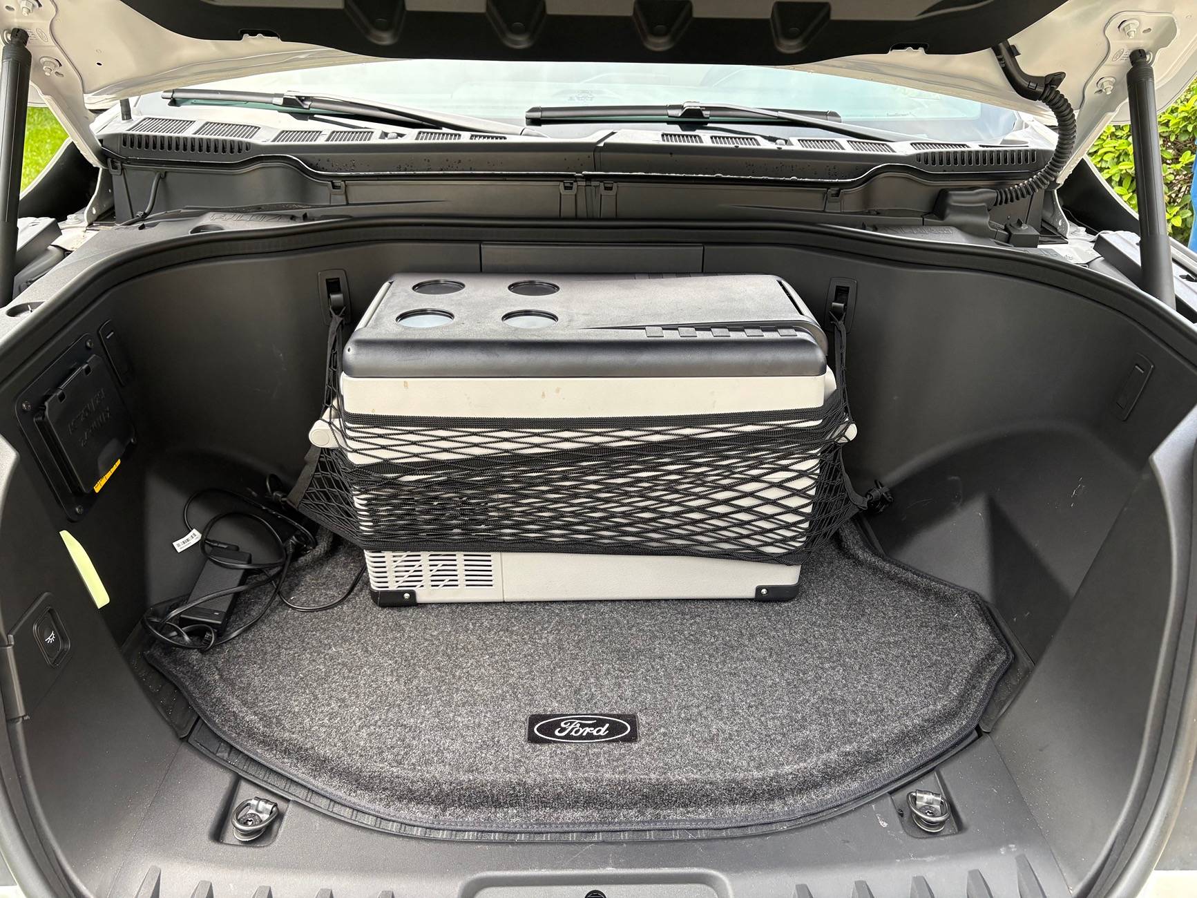

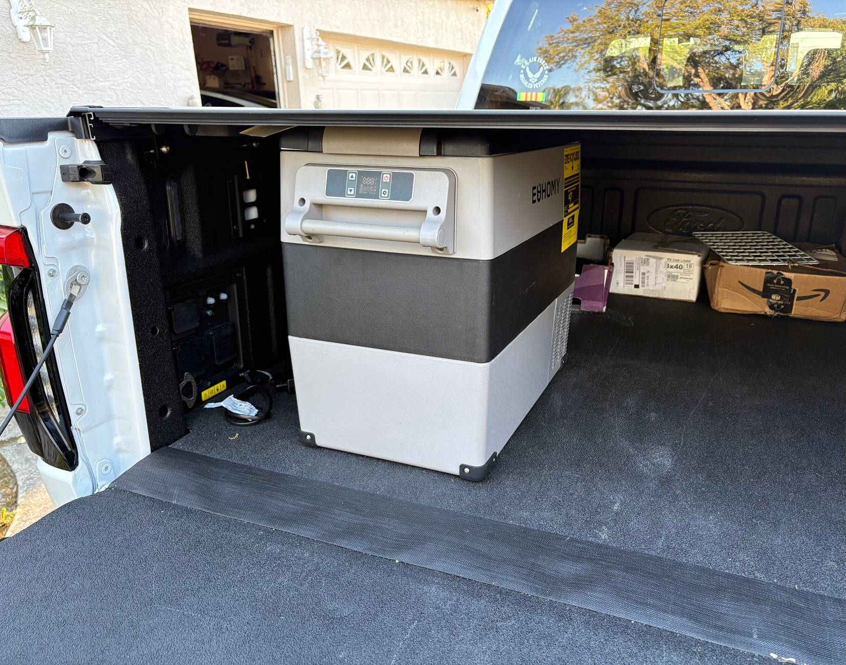

Where does it say in the Lightning manual that there has to be a constant draw on the PPO for it to stay on? On my 2024 Flash all I can find is setting the power limit low enough so it will stay on.
Nowhere in the manual does it say there has to be a constant draw. BUT. From those who have tried it that is the case. From my experience there has to be at least a 100 watt draw or the PP output shuts down after about 6 minutes or so, when using PP with truck turned off.
If I leave the truck running the outlets stay live, no matter if there is current draw or not. So when pre-cooling my powered coolers before a trip I now keep the truck running.
When I use the truck, with it turned off, to power the cabin during power outages the truck PP outlets never turn OFF because there is enough current draw.
