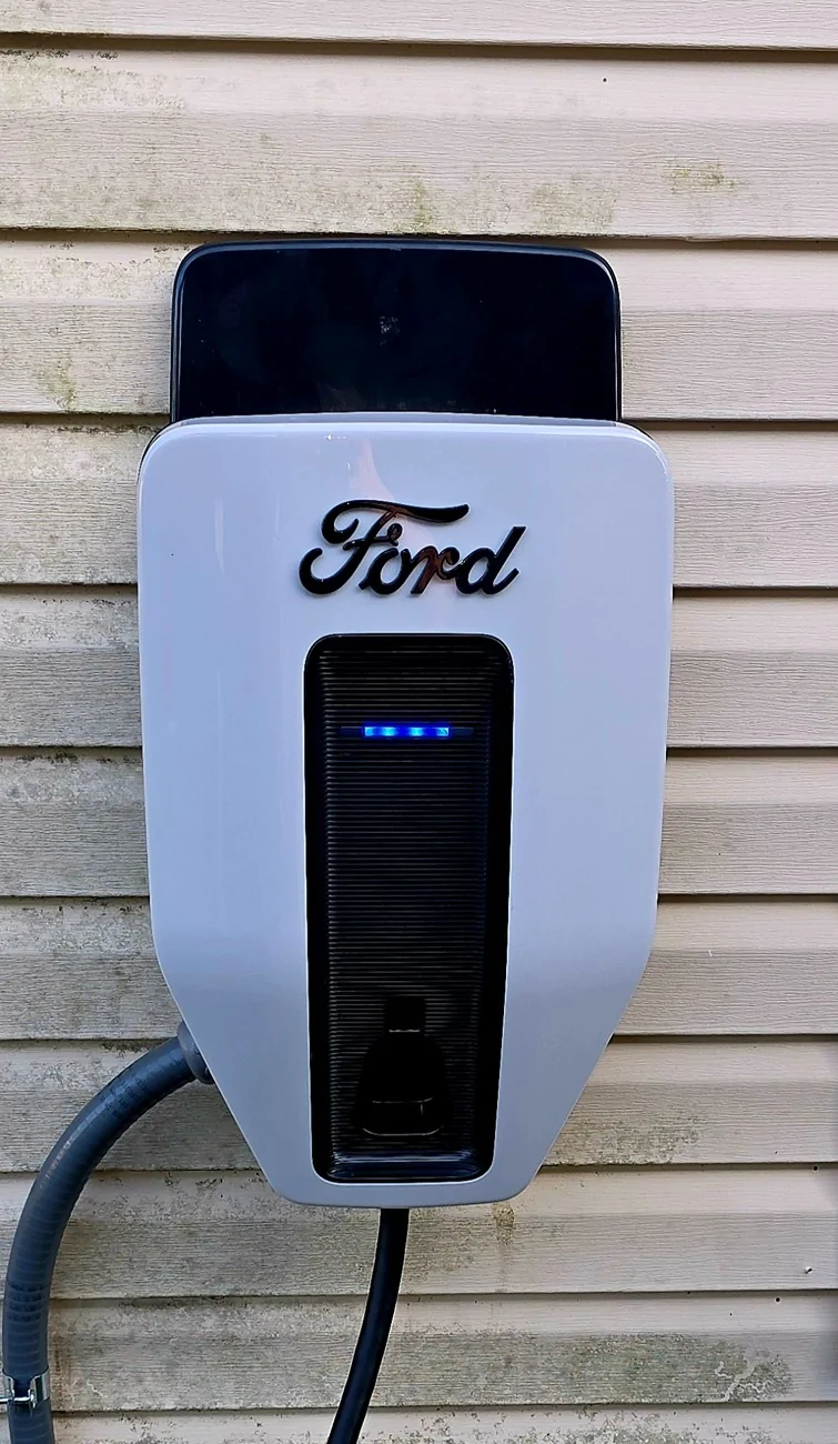

Ford F-150 Lightning Why was Charger capacity reduced ? FCSP
chl
CHRIS
Dec 16, 2022
2,128
1,288
alexandria virginia
Just recently joined the Lightning fam with a 2025 Flash and even though my dealer sent me home with the Charge Station Pro it sucks my truck can only accept 48 amps. As I wait on my install there are zero benefits to having a 100 amp circuit put in then correct? Just stick with 60 amps?
For you current vehicle yes.
Maybe down the road Ford will again have a vehicle that can charge at 80A.
I did not know they were going to make the change to a lower amperage when I installed my FCSP on a 100A circuit.
But since I bought the supplies myself (wire, conduit, breaker, etc.) the cost difference between a 100A circuit and a 60A was not huge.
The FCSP was made for #3 AWG hots and #6 AWG ground, so the terminals and torque specs are for that wire.
If you change to 60A wiring (for a 48A charge current) your electrician will have to make sure 1) the terminals are ok for that (probably are) and 2) that he uses the torque for the smaller diameter wire which will be different (less torque for smaller diameter wire).
You are getting a free install, right, so if you go ahead and have it wired it for the full capabilities it won't cost you anything more.
In the future, you might be able to use a different EVSE and vehicle at a higher charge rate, and you will be prepared.
