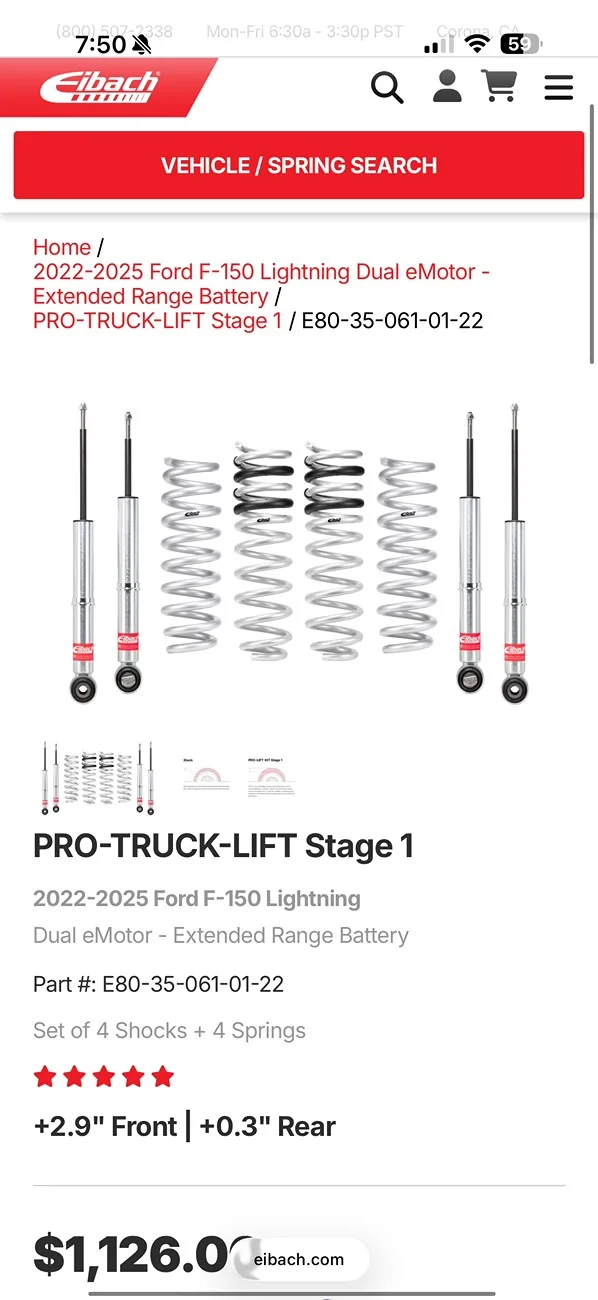

Thanks! Do you have any recommendations for anything better than pucks? What did you use?

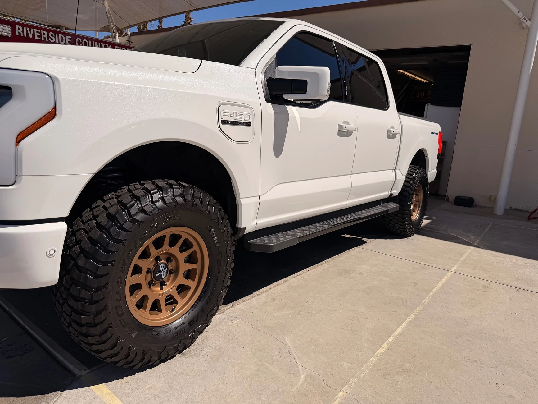

Eibach stage 1 lift with Icon UCAs. They are adjustable and built specifically for the Lightnings weight
Ford F-150 Lightning Will this Rough Country 2” Leveling Kit Fit? IMG_0612
Ford F-150 Lightning Will this Rough Country 2” Leveling Kit Fit? IMG_9817
Ford F-150 Lightning Will this Rough Country 2” Leveling Kit Fit? IMG_9819
Ford F-150 Lightning Will this Rough Country 2” Leveling Kit Fit? IMG_9911
Dont be too wrapped up about it. Its close enough that standard f150 items have been shown to work.
That said I wouldn't buy that kit. I have never heard of vertex and even at msrp that kit does not say quality.
For other options the bilstein 5100s use your factory springs so no worries about springs and weight. Bilstein 6112s are a step up but do use different springs. Ford tremor bits shoukd also work.
