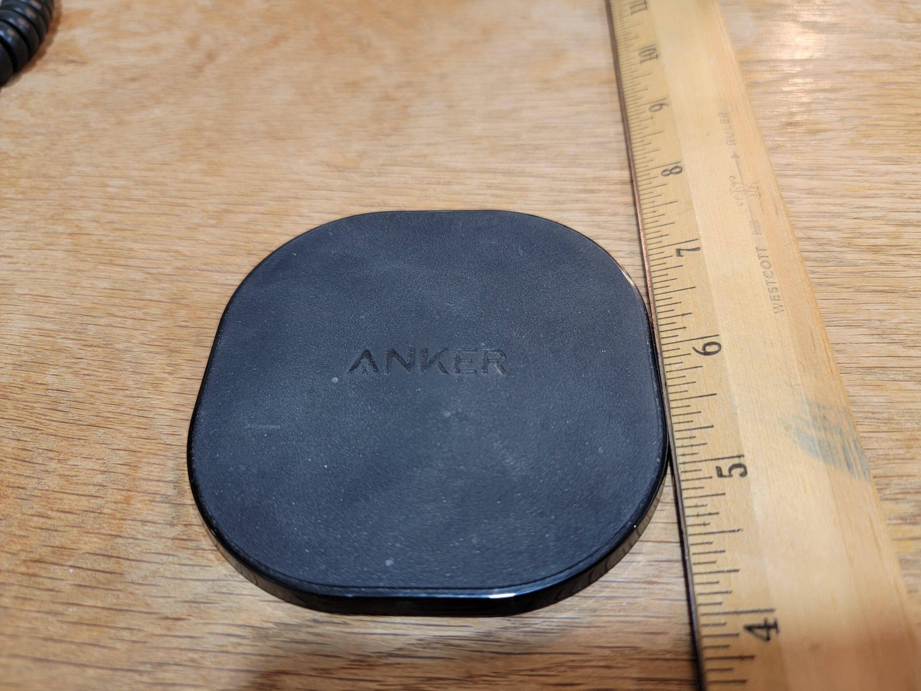

I have various Qi charging units that I use for charging my phone at my desk, in my living room, etc. I've noticed that some of them are pretty poor, and some of them work really really well. The fastest one I have is the Samsung fast wireless charger, but the best one for working through cases is a relatively thin Anker 10W pad - [email protected].
The one in the truck is likely only a 5V, 1A pad which is the most compatible Qi charging mode but can't keep up. Had the same problem with Tesla's built-in pad when I had a Model Y as a loaner.
I've been thinking of shaving the feet off one of the Anker pads and mounting it in the same place in the truck, to see if the phone will remain on the ledge. I'd plug it into the USB ports and that should allow for better charging, as long as it doesn't exhibit any negative effects with the truck's charging pad.
