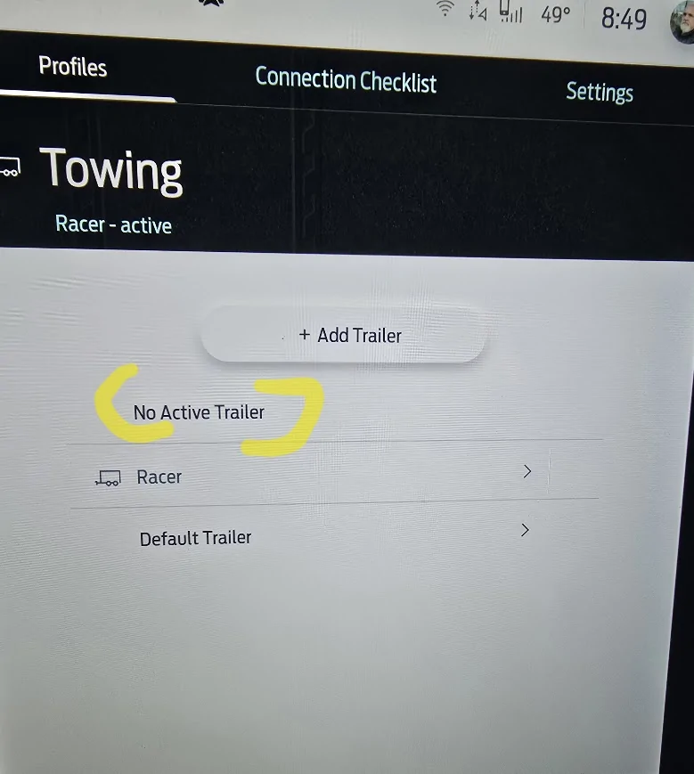

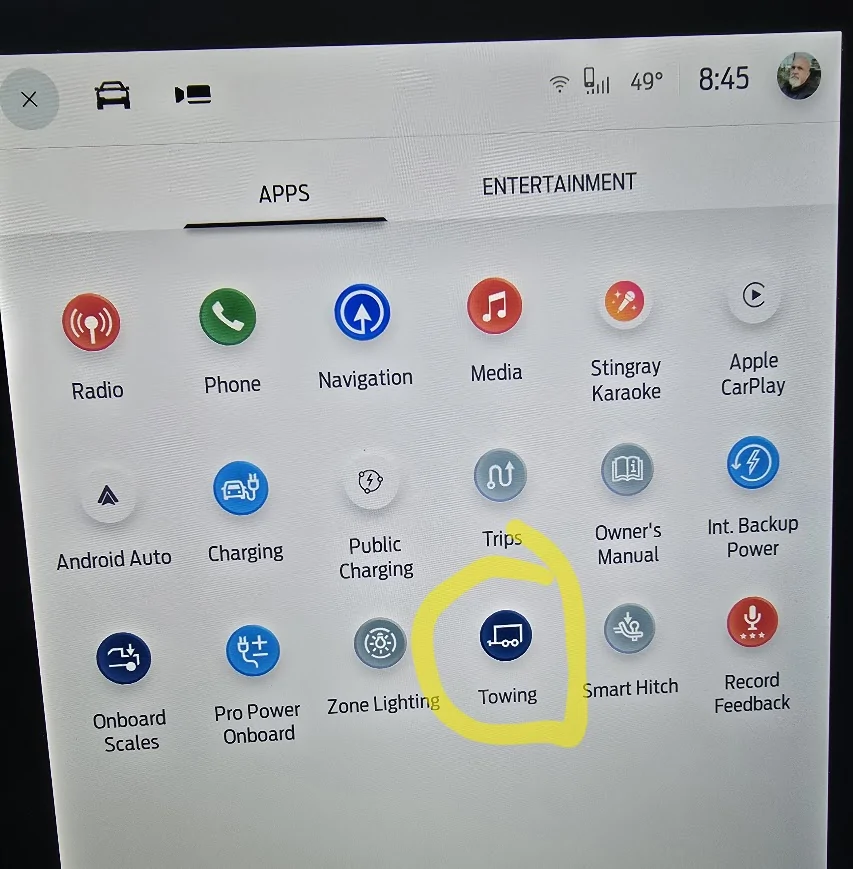

Hello, I have issue going on for last five days on my Ford Lighting Flash 2024 at 90% of the battery charge is showing the mileage is 125 miles even though I have extended battery the problem just started happening.
Did you happen to explore the Towing configuration screen?
You may have created a custom trailer profile for future use and left it active.
View the [Towing] from the APPS menu, Select [No Active Trailer].
You may get a prompt to confirm the change, accept it, then your predicted range should correct.
