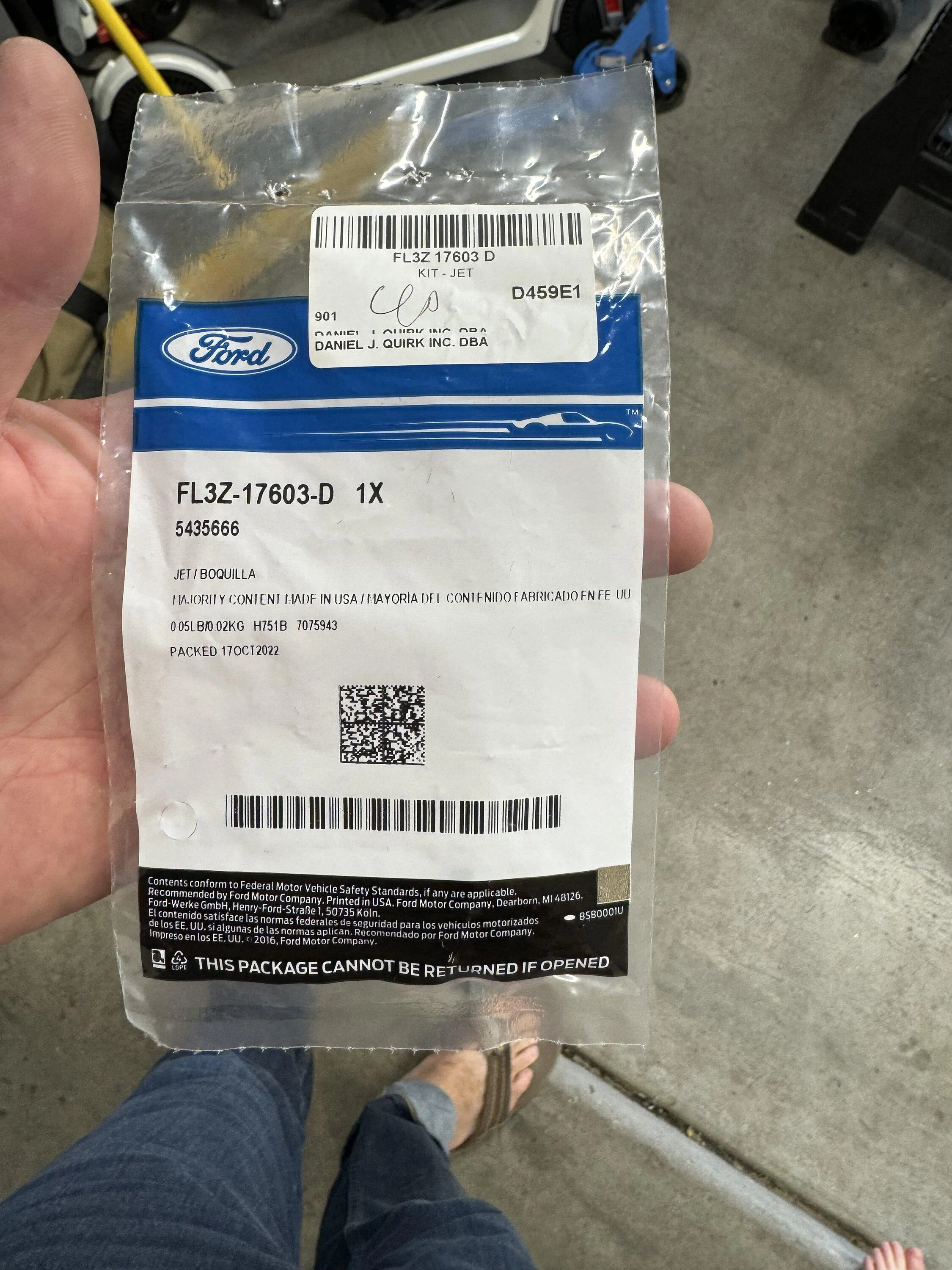

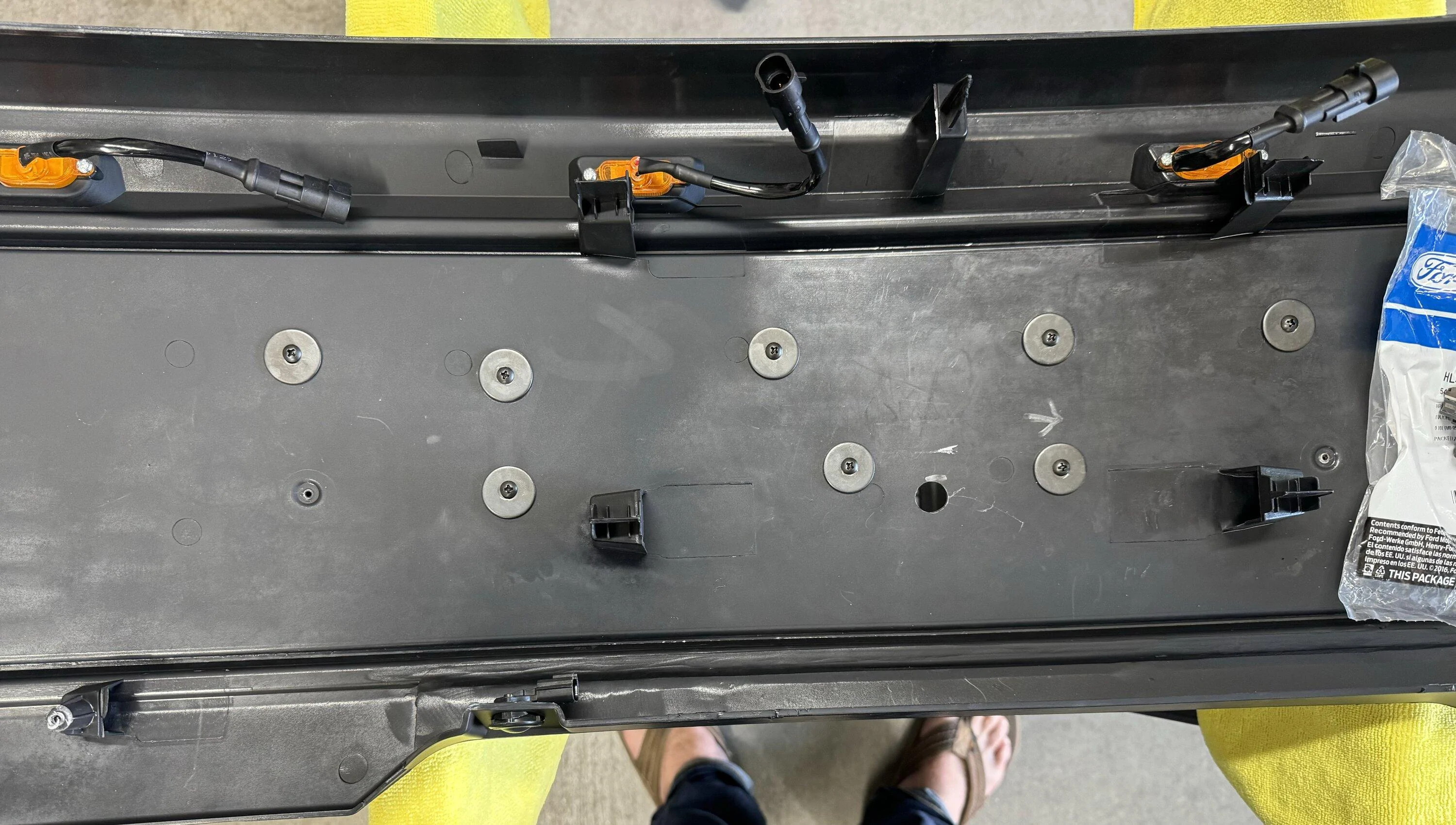

So here I got a little “creative”. I’m sure there are better ways to mount it, I Figured that it’s not going to need to be removed so i busted out the good ol hot glue gun. After ensuring the angle was on point. I marked the location and angle of the housing and applied a ring of glue around the housing and the grille With very good results. I then mounted the camera and popped in the new spray jet and went for the test fit. Everything worked! Hooray! Time for a Beer! Then back to wiring the LED lights.

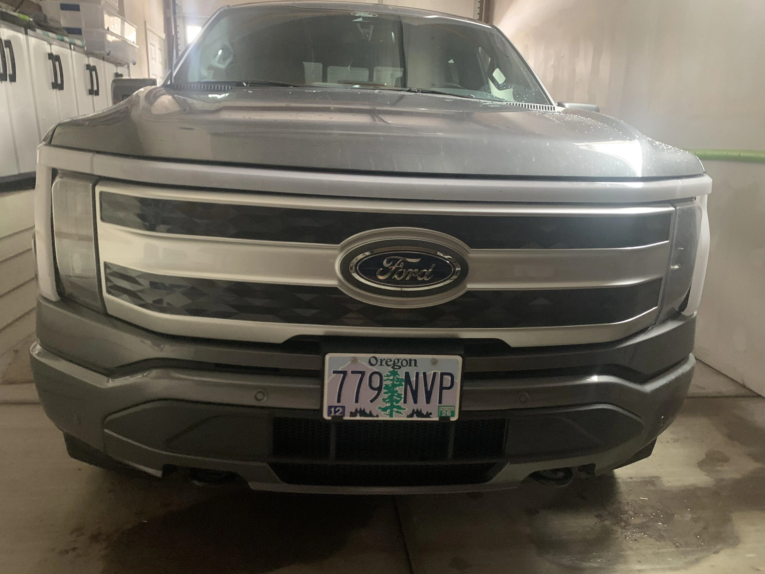

Yours looks awesome. I didn’t consider and just painted mine. I’ll stick with it for a while. Maybe later once you post all parts needed.
