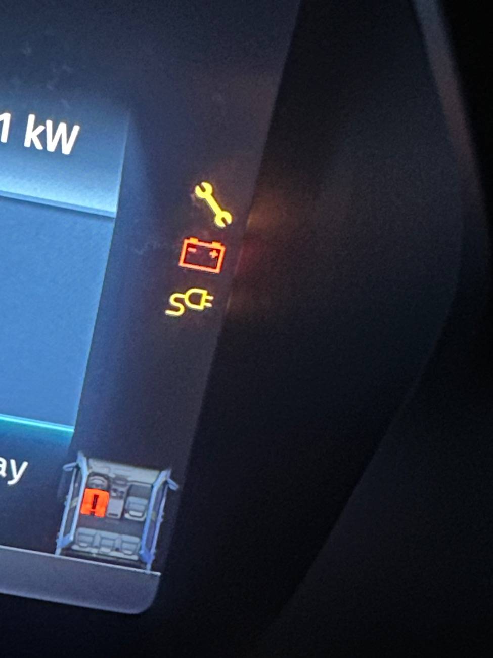

But of an update.
Went out to check on truck and not the battery icon is red on cluster…
truck is charging normally

That's normal when you're in accessory mode, doesn't guarantee the condition / health of your 12v LVB
