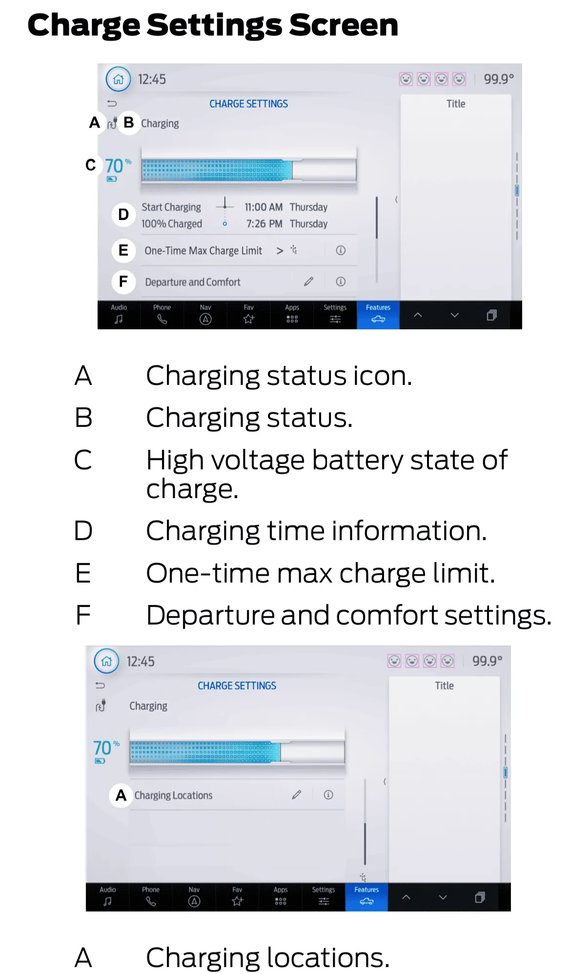

I’ve read most of the replies and am a little confused.
My dealer told me to always plug the truck in when I’m home. And I’m doing it every day pretty much since took delivery in late December 2022.
Am I doing it right or should I be doing the charging thing differently?
Every morning my display shows 100% charged and miles to empty in the vicinity of 320 miles.
In the first few weeks the charting was showing 100% but miles were around 170/180, and had some lows around 250. The temprarues were pretty low back then and the dealer told me they should improve with the weather and drivability, which it did.
Now, when I leave in the morning with 100% charge and around 320 miles estimated, drive around to work and errands about 30 actual miles, the estimated miles drop 50 miles or so.
which I understand it is because of the other power usage of the HVAC system.
Please let me know your thoughts…

SOC = State of Charge. The high the number, the more energy you have put into the battery.
There is a setting for the truck to stop charging at a specific SOC. When you see 100%, you are at 100% SOC. I can't remember how to set this (and don't care to look it up right now), but I'm sure other members will step in to explain the specific procedure, and I think you set this after you have charged at home and it will be set for every time you charge at home.
I use 85% for my truck because I know it's best for the long-term health of the battery and will more than meet my daily needs. My wife's Kia EV6 charges to 90% because it only has 10% increments and I don't know if 80% will meet her ever-changing requirements on a daily basis.
Charging to 100% on an occasional basis will not do long-term harm, but you should drive soon after you hit 100% SOC.

Fully agree. I would only add that when you set maximum SOC based on what your typical driving distance is. In my case, my typical days drive is 15-30 miles, so I actually set maximum SOC to 50%. On the few days when I need to drive much farther, I click "charge to 100%" in the app. If, OTOH, you normally drive 250 miles a day, than charging to 100% every day makes sense.

on my copy of the manual is on page 213. Just click on the pencil on your display.

Your manual explains to charge to less than 100% daily.
