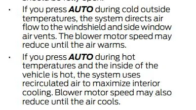

So per the manual, in AUTO it comes out the windshield vent and side window air vents.

I think it's intentional not blowing hot air in your face. Hot air rises which is why it's probably coming out at your feet in auto also. Not saying it's the best approach, but it seems like they did it that way on purpose. Pretty easy to just hit the Climate button and change it to front vents if that's what you want. I'm pretty sure when you run the climate from Ford Pass on a cold day/morning, it's coming out off all the vents, until you start the truck. If I run mine for 5 minutes before I get in the truck, it's usually pretty comfortable.
As shown in the video hardly any heat comes out of the feet, or the top vent. With zero from dash vents. Its also sure not 5 minutes to be warm ..
Using the app is not a solution when I just want to jump into the truck and have warm air. In the platinums case i shouldn't have to manually fiddle with it , on this trim and others we paid to have auto climate thats is not a pos.

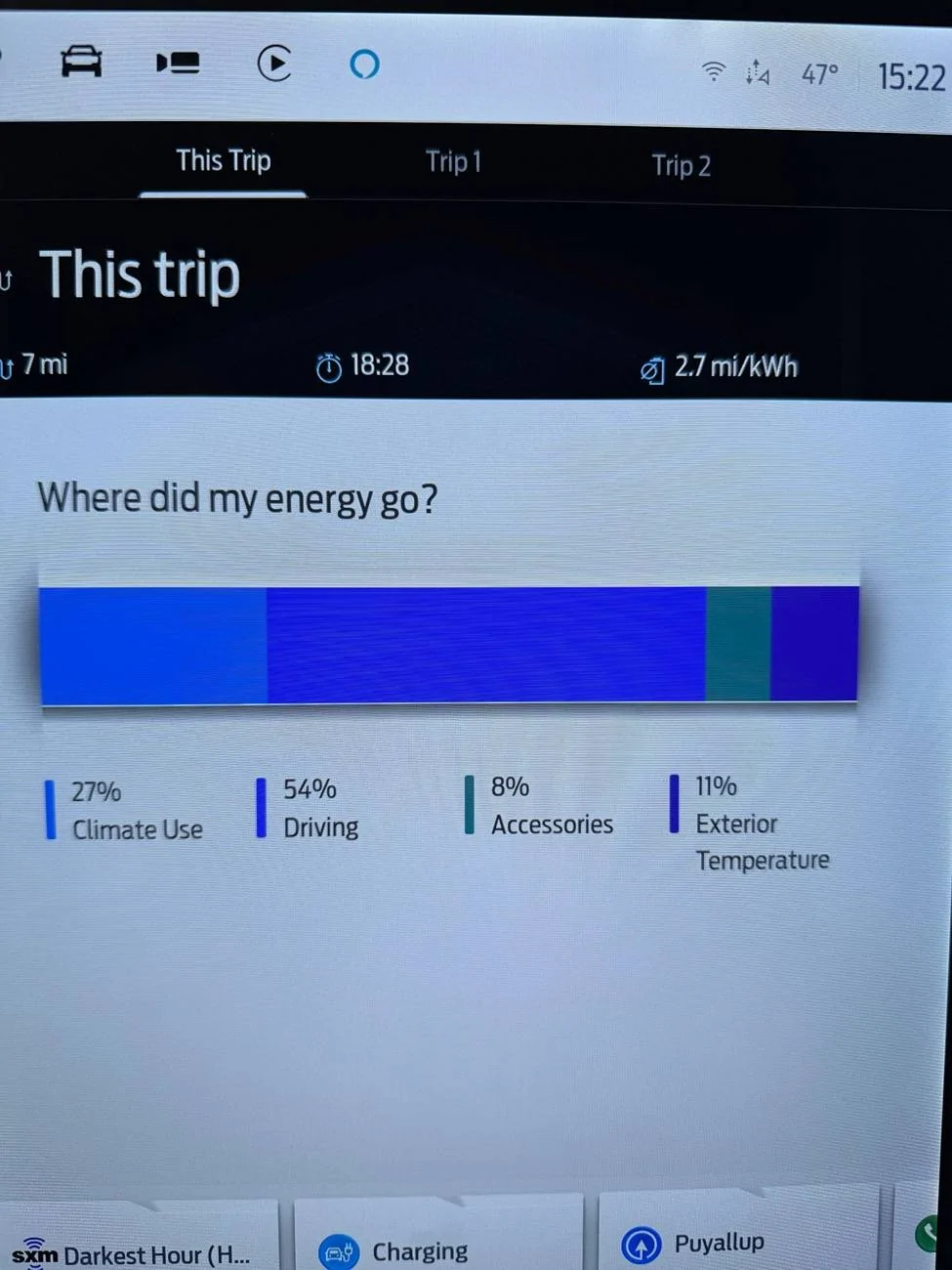

So hopped in the truck and headed home from work today and I suppose I’ve been micromanaging the climate since I started following this thread. OAT was 46 degrees. After about 2 or 3 minutes on Auto 3 with seats on auto and steering wheel on, I had solid air blowing out of the defog and really solid air if not full blast blowing out of the floor vents with next to nothing coming out of the front facing vents.
Upon arriving at home I noticed the fairly high climate number on the trip. 27 is about as high as I get with this trip and a note that the air had slowed down as the cabin had warmed quite a bit since I started the trip. It may be on the conservative side but definitely for a reason if it’s really drinking that much juice.
