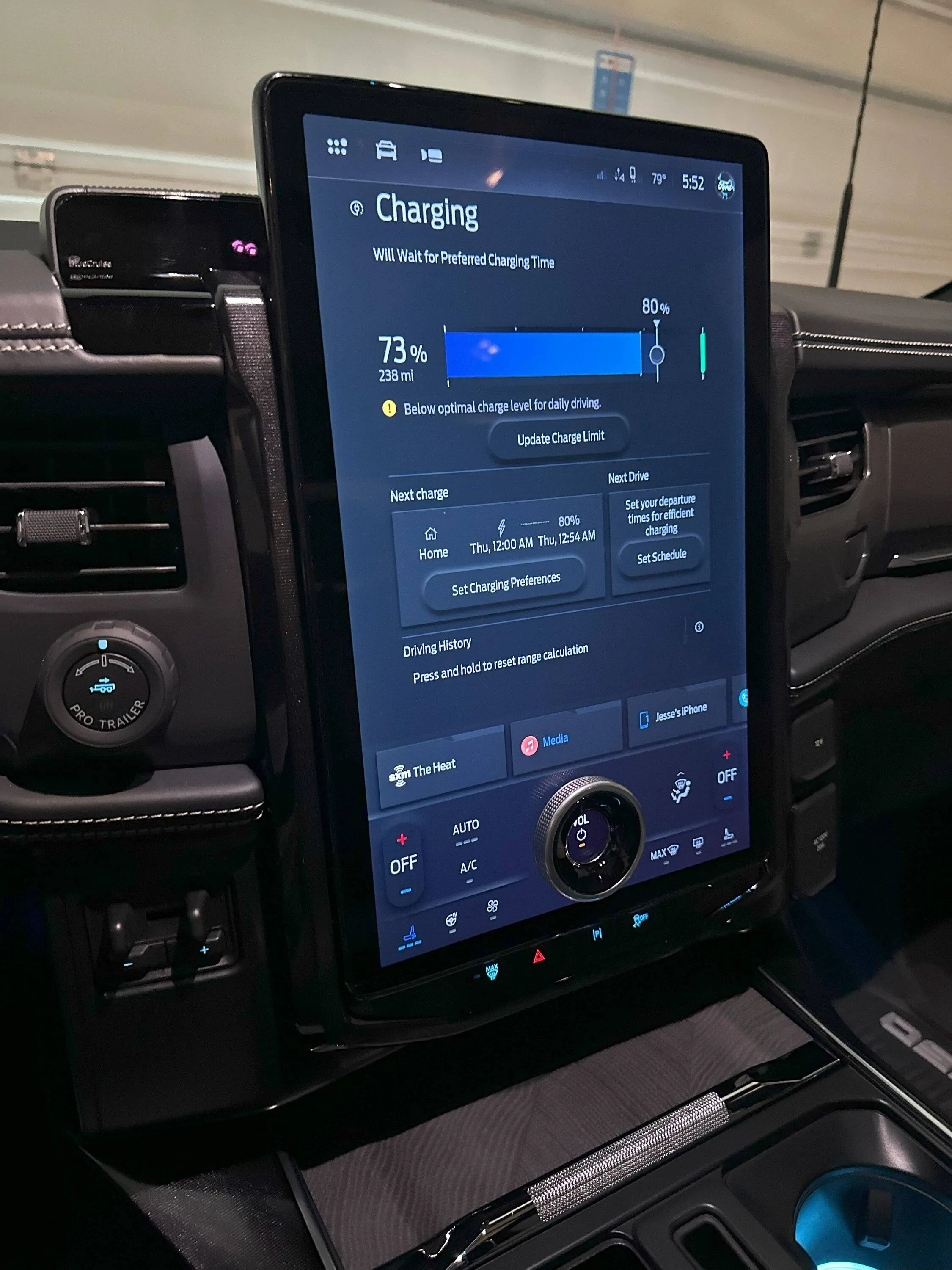

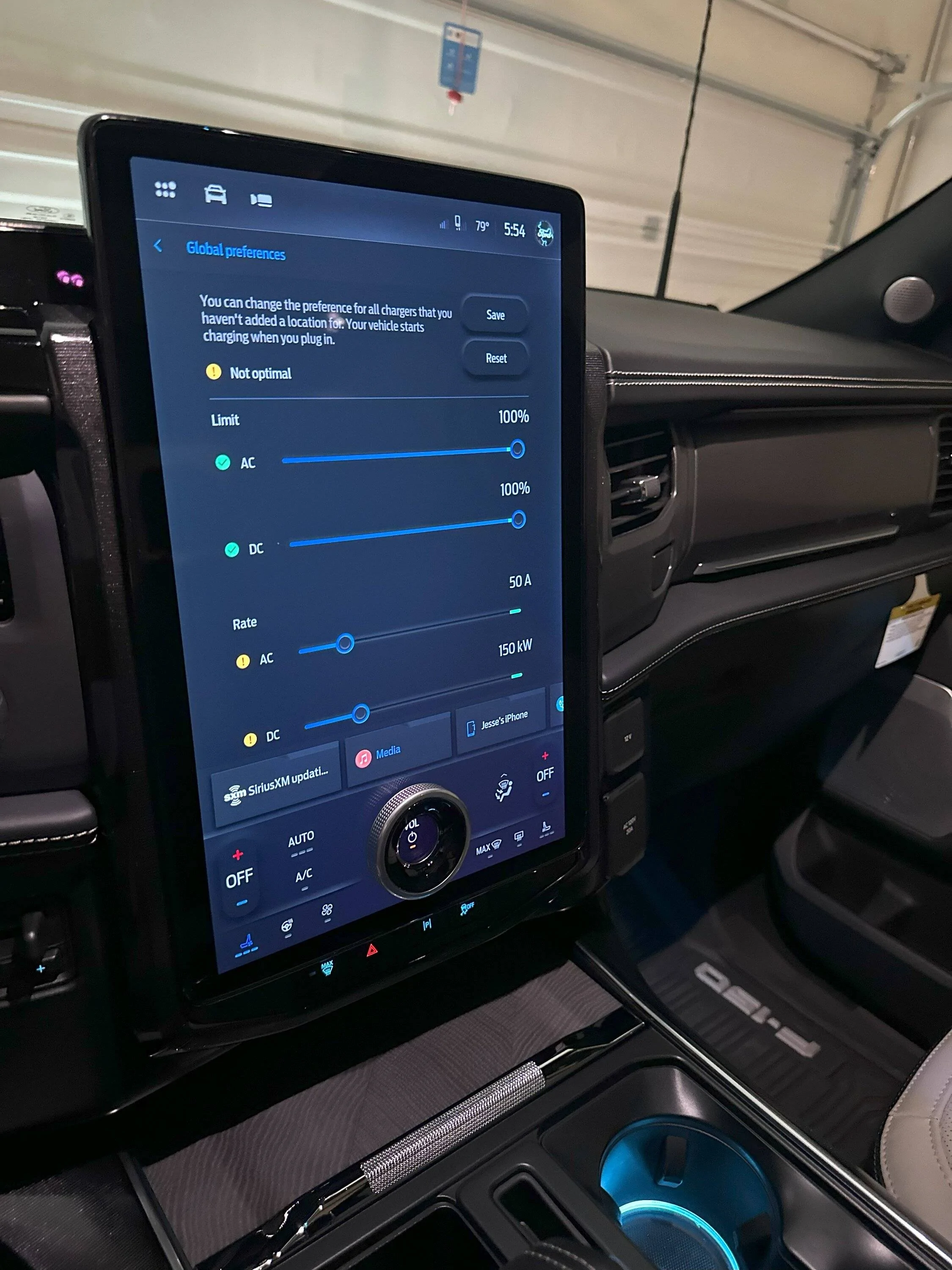

EDIT - I am sorry. THis apparently doesnt apply to the 12" yet. I am still learning about EVs. So I am not as knowledgeable about the EV terms and setting yet. SO as of now this only applys to the 15 in Portrait screen. On the 12" if it were available in the Charge settings an advanced tab would show. That would contain the additional settings. Even then the 12" seems to only have a AC setting.
SOrry for the confusion. I should have double checked prior to posting.
Ford F-150 Lightning Add Charge enhanced charge settings IMG_2228
Ford F-150 Lightning Add Charge enhanced charge settings IMG_2227
I shared how to do this with someone I thought they were going to share it but since i havent seen it shared yet I will. I figured some of you may be able to use it. i havent used it at all.. but some of you are more knowledgeable than I am and charge a lot more than I do.
As long as your APIM is at 24127 and have the SOBDM, B,C and BECM, PCM updated you can enable these options.
2024 should have this without any updates BUT I havent confirmed this. My truck is fully updated. THese are the options the 25 come with.
In forscan go to the APIM
edited
Add a 2 to What you have in this location.
Example C would go to E
7D0-10-04XXX*XXXXXXxx
This will enable this menu

You should have it at that version. I enabled it on a 12” lightning
Typically it takes a reset in forscan to make changes show

I was able to enable it on my 24 Flash. Not sure if it’s doing anything though - the global settings didn’t do anything on my saved home location, and the saved global settings revert back to what your screen is showing the next time the truck is started.
