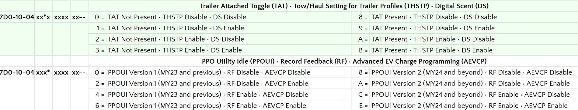

@Jesse-Infotainment, can you share the spreadsheet for 7D0-10-04 byte 4? The public one has nothing for APIM and for APIM(2024), it just has:
Ford F-150 Lightning Add Charge enhanced charge settings 1749411855674-7o
I understand why 22-23's have 4 (or rarely a 0) and 24's have C (or 8 rarely), but it seems a new toggle bit was introduced to have 25's go from C to E.
I'm afraid if 22-23's make it an E outright, then they may mess up something like RF Enable. Likely it will be one of those mods if you only have a C then change to E. Otherwise, if 0 change to 2, if 4 change to 6, if 8 change to A, etc. Just a theory - need the spreadsheet to confirm. Thanks!
I'm afraid if 22-23's make it an E outright, then they may mess up something else. Likely it will be one of those mods if you only have a C then change to E. Otherwise, if 0 change to 2, if 4 change to 6, if 8 change to A, etc. Just a theory - need the spreadsheet to confirm. Thanks!
I think I was correct the first time and the 6 is also required. It isnt in the new sheet I have.. E it wont remove anything it just enables the advance charging options.
Here is that bit though on the sheet
Ford F-150 Lightning Add Charge enhanced charge settings 1749412442413-rv
3,244
4,719
Thanks. I think technically the E is only if you have a C and want to enable AEVCP. Enabling RF (Record Feedback) is likely ok, but If someone has version 1 of PPOUI, they will only want to enable the AEVCP and not tell the truck they have version 2 of PPOUI (unless version 2 is an upgrade to PPOB applicable to 22-23's).
So maybe the safe thing to do is add 2 to current value if you have 0, 4, 8, or C? Otherwise you would be modding other features.
So maybe the safe thing to do is add 2 to current value? Otherwise you would be modding other features.
Pretty much. Most all the Lightnings I looked at had a C.
