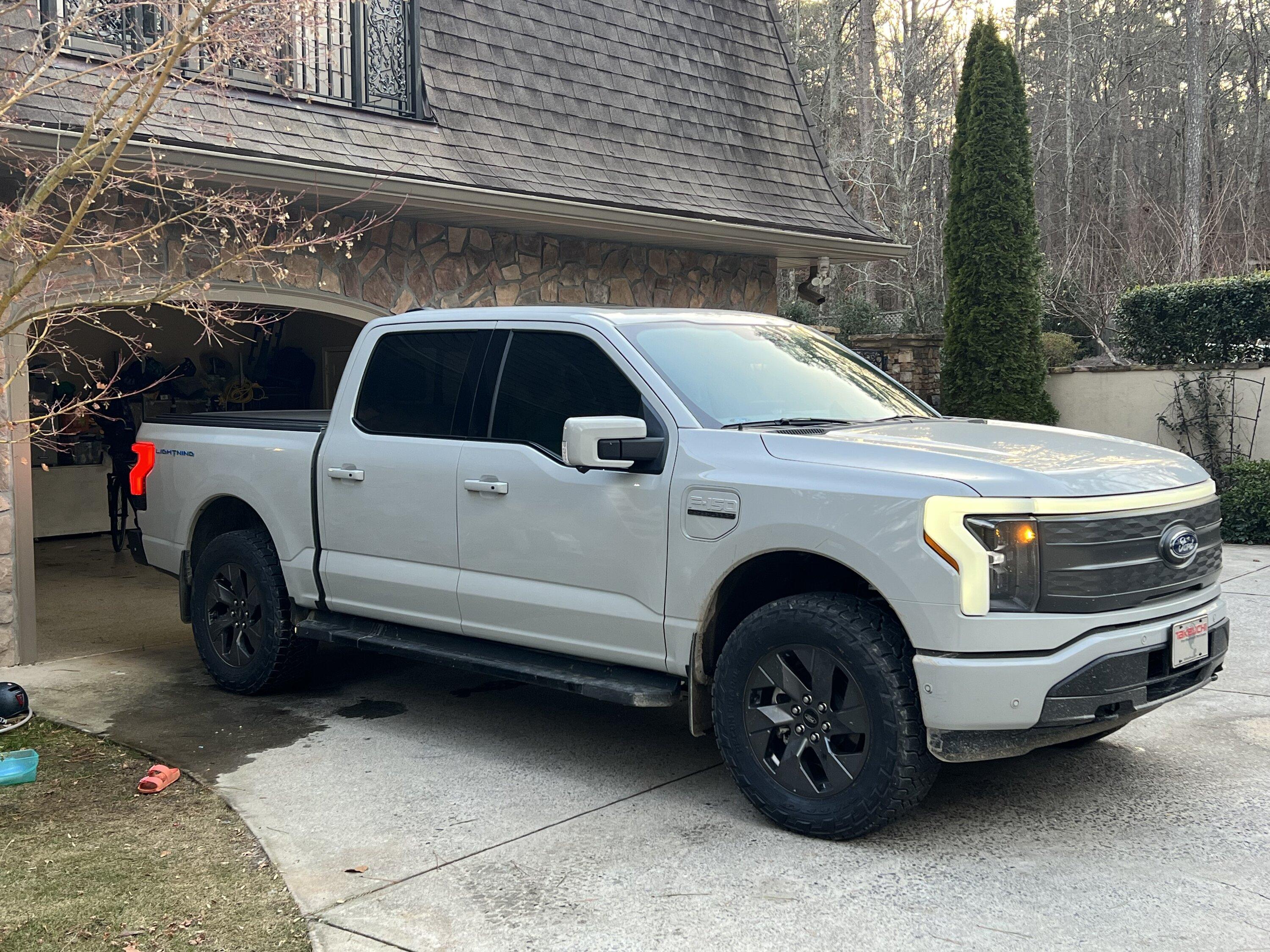

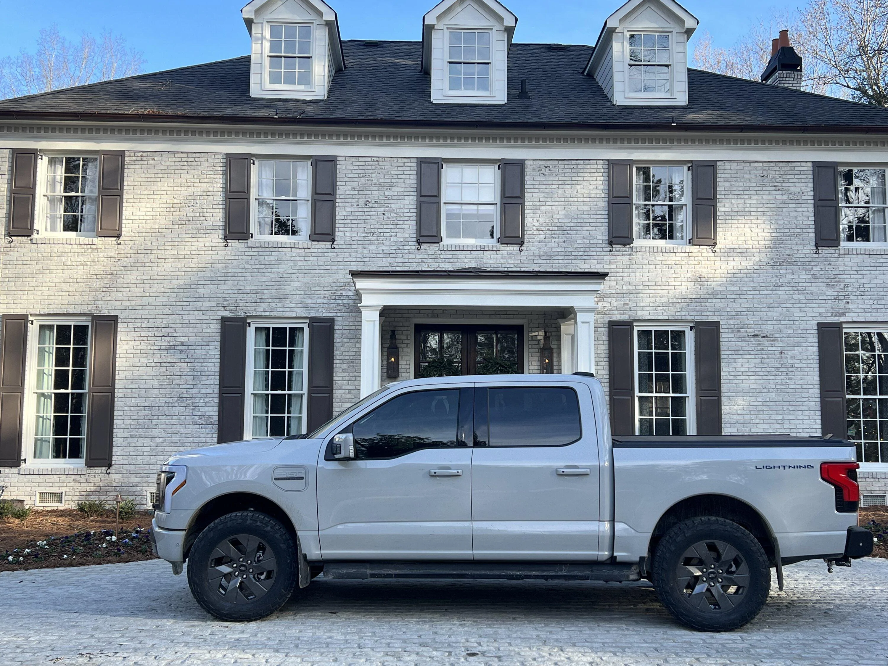

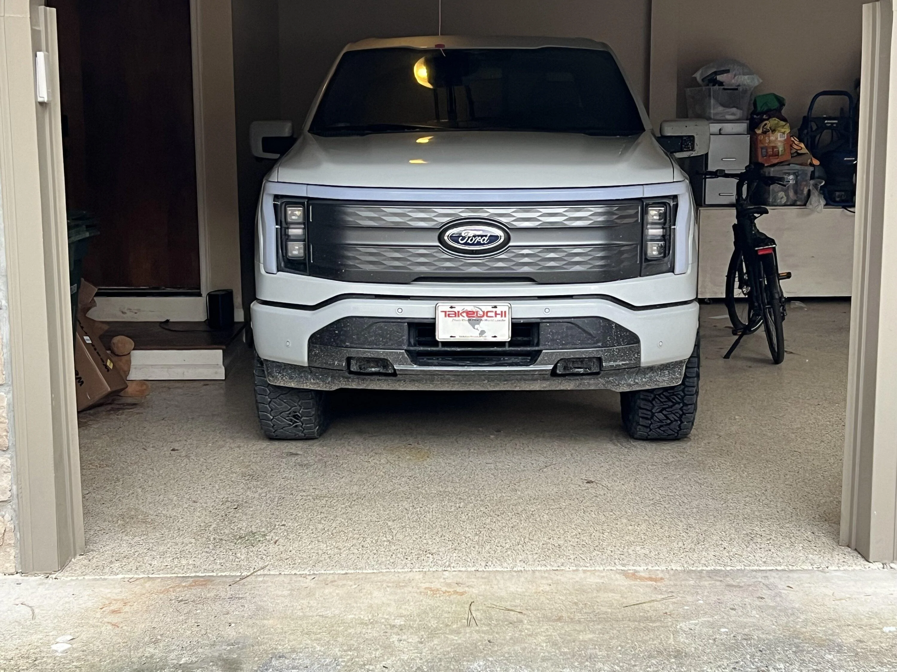

Did a 2” level and went with 285/65r20 recon grapplers.
34.8 tire.
I’m thinking I might be a tad happier if I went 295/60r20 with only a 2” level but I have no rubbing and the suspension is still great so maybe next set. I do like how much higher I feel looking out of the cab tho.
Range is around 2.0-2.5 around town in 50 degree weather. 1.6-1.8 in 28 degree weather
Anything above 55 I haven’t seen it better than 1.9.
The tires have been calibrated as well so I know my correct MPH ect.
