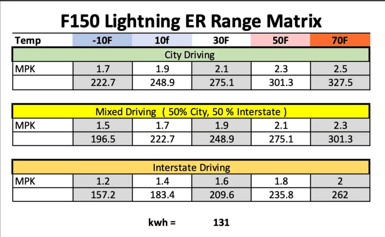

@luebri made a nice "back of the hand math" chart for easy reference when planning:
Ford F-150 Lightning Another Post on Range Lower than Expected 1754343407377-j
You can also use the chart to ball park your range a bit easier. Let's say I'm getting 1.8mpk and have 33% SoC left. A quick glance tells me ~23miles per 10% so ~69-70miles would be a conservative estimate. Another example is a road trip I take between Tucson and El Paso. There are a few elevation changes. Even though I see lower than usual numbers for efficiency, I know I'll make it up further down the road. In those cases, with the benefit of past experience, I know what % SOC I should be at and I use it directly to determine if I need to slow down (maybe due to unexpected headwinds).
