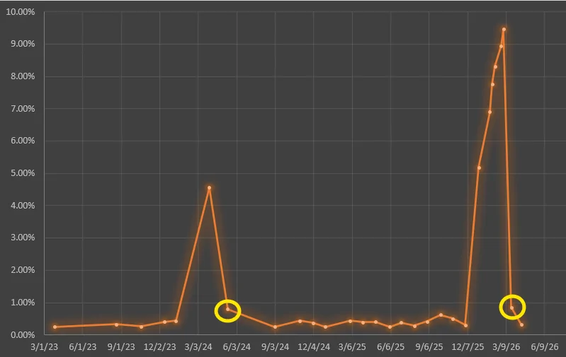

I can kinda answer this question. After both module replacements I noticed a slightly elevated module variation (0.8%) immediately afterwards that settled and stayed lower when measured later. I don't have the exact time frame since I didn't measure regularly, but there is a definite decrease.
If I have 3rd module fail, I'll do more frequent monitoring :facepalm: .
Thanks...hope for no third module failure!
