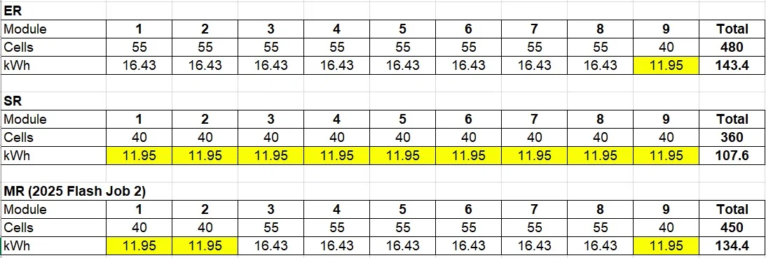

BTW depending on the battery SR or ER or Mr (Flash) and year, the number of modules will be 9 but the number of cells differs.
Ford F-150 Lightning Reduced Powertrain / Reduced Power Notice? 9 battery modules
This table lists the total number of cells and kWh but it includes the 'headroom' or 'buffer' so the usable capacity is less - e.g., the SR lists 107.6kWh but the usable is 98kWh.
And these cells are in groups of 4 or 5 cells in parallel, which is why the dealer reports only show 90 (SR) or 96 (ER) cells being measured.
