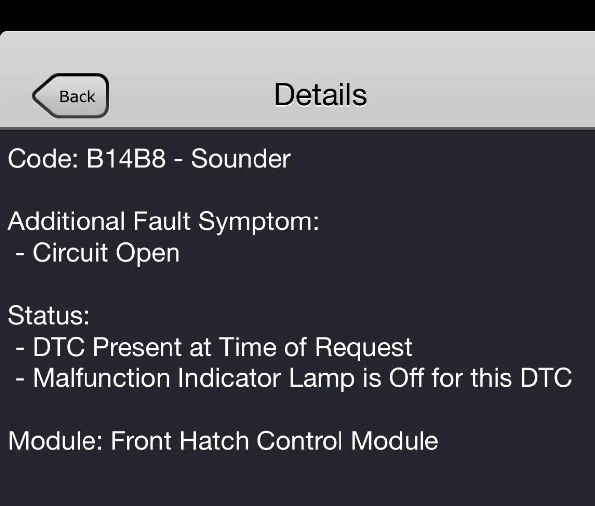

Yep, you are right.
No MIL light on the dash, but I did check for codes. Got code: B14B8 -Sounder
May do some surgery on the beeper and reinstall in a few days.

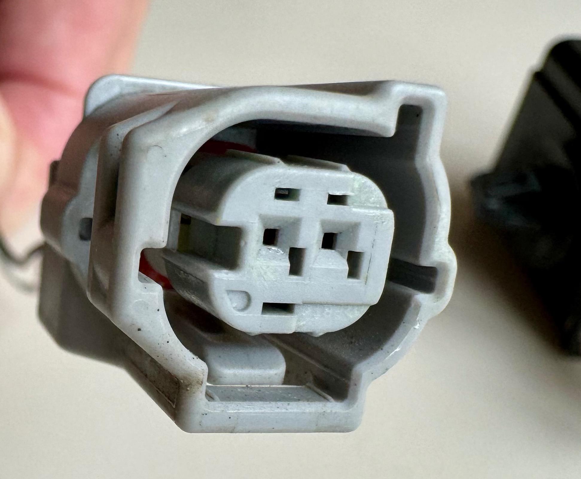

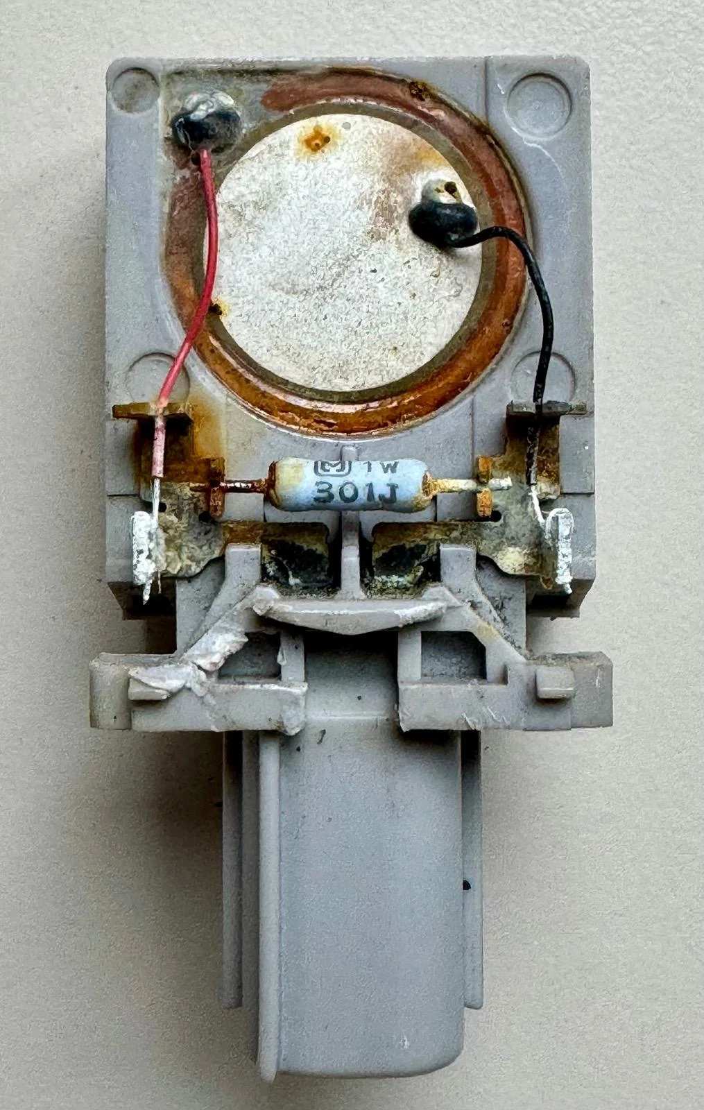

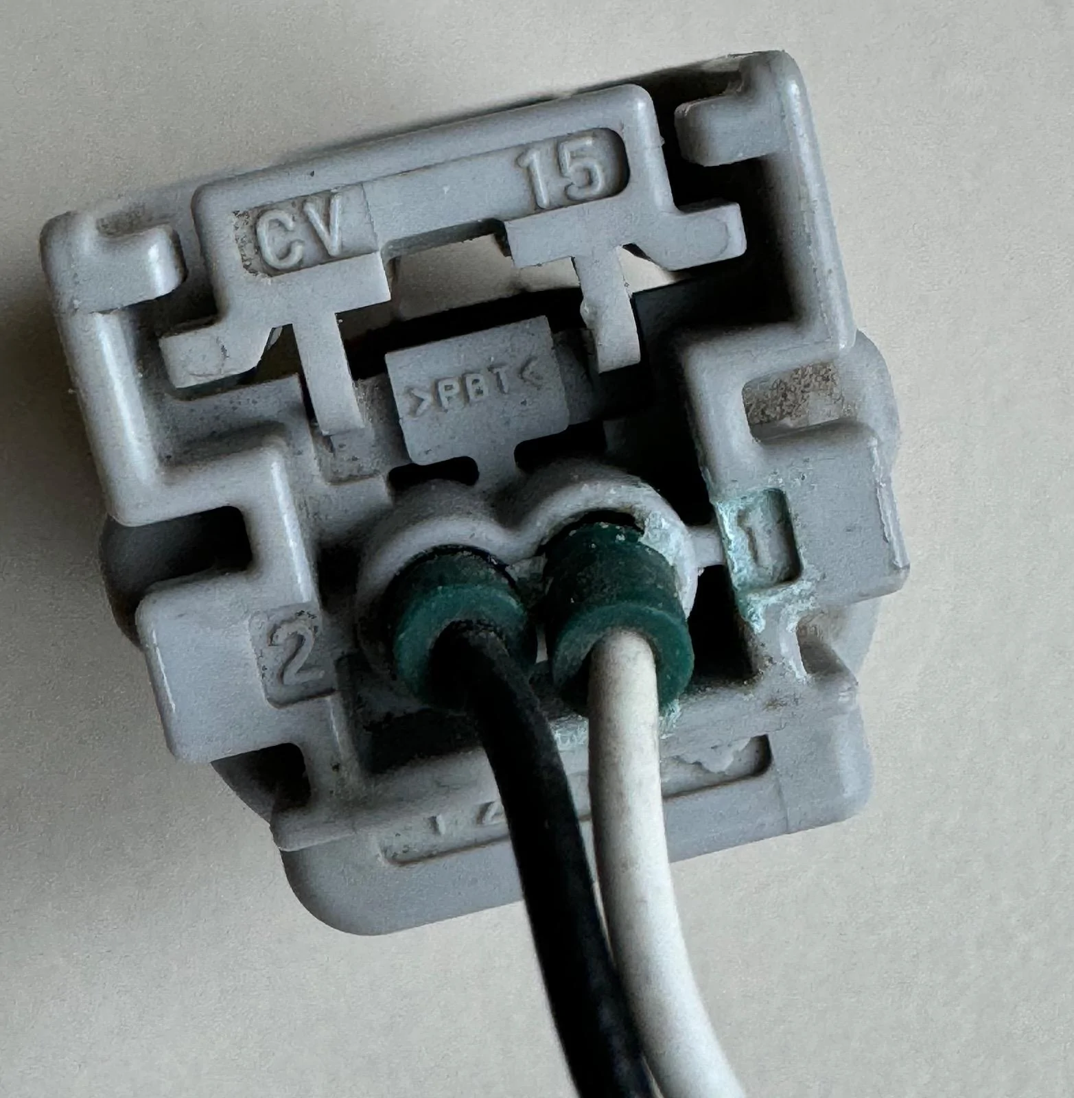

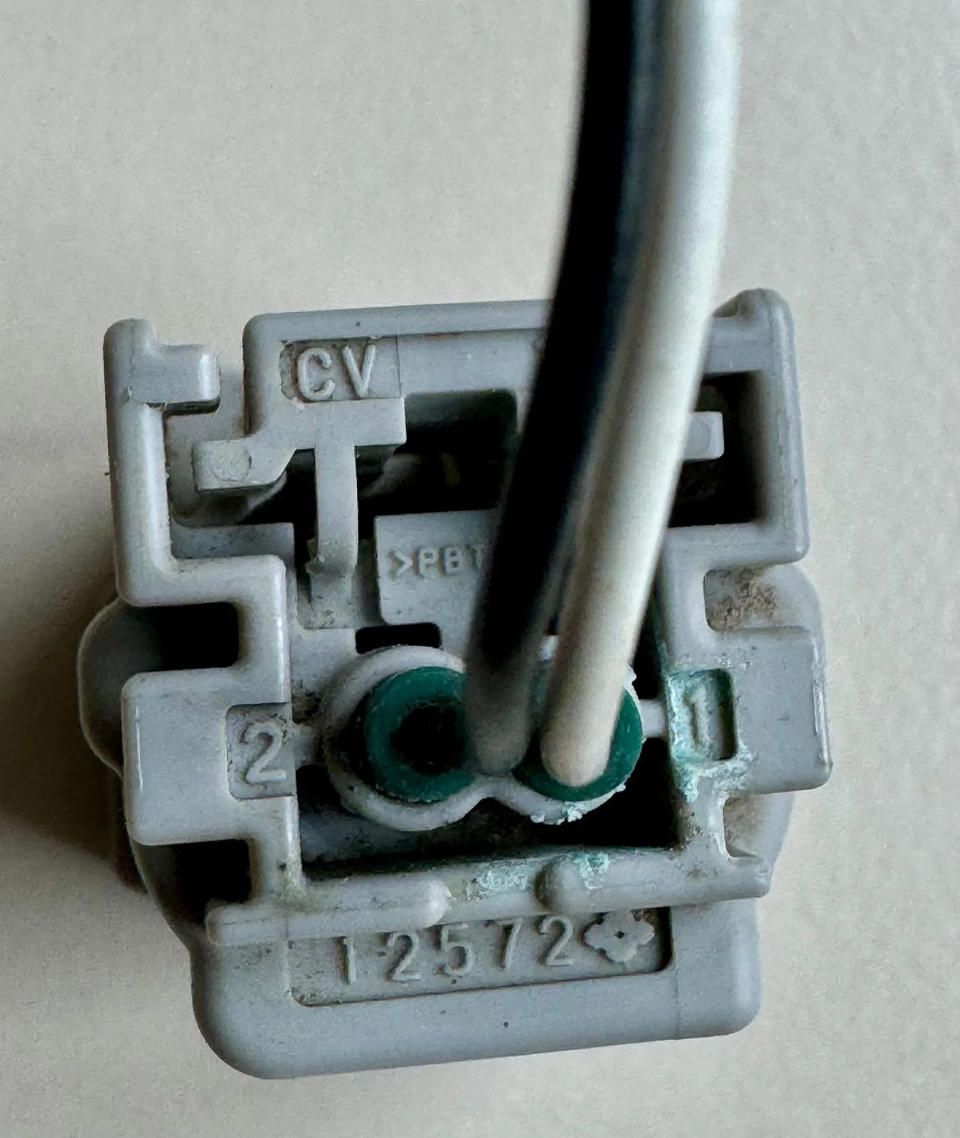

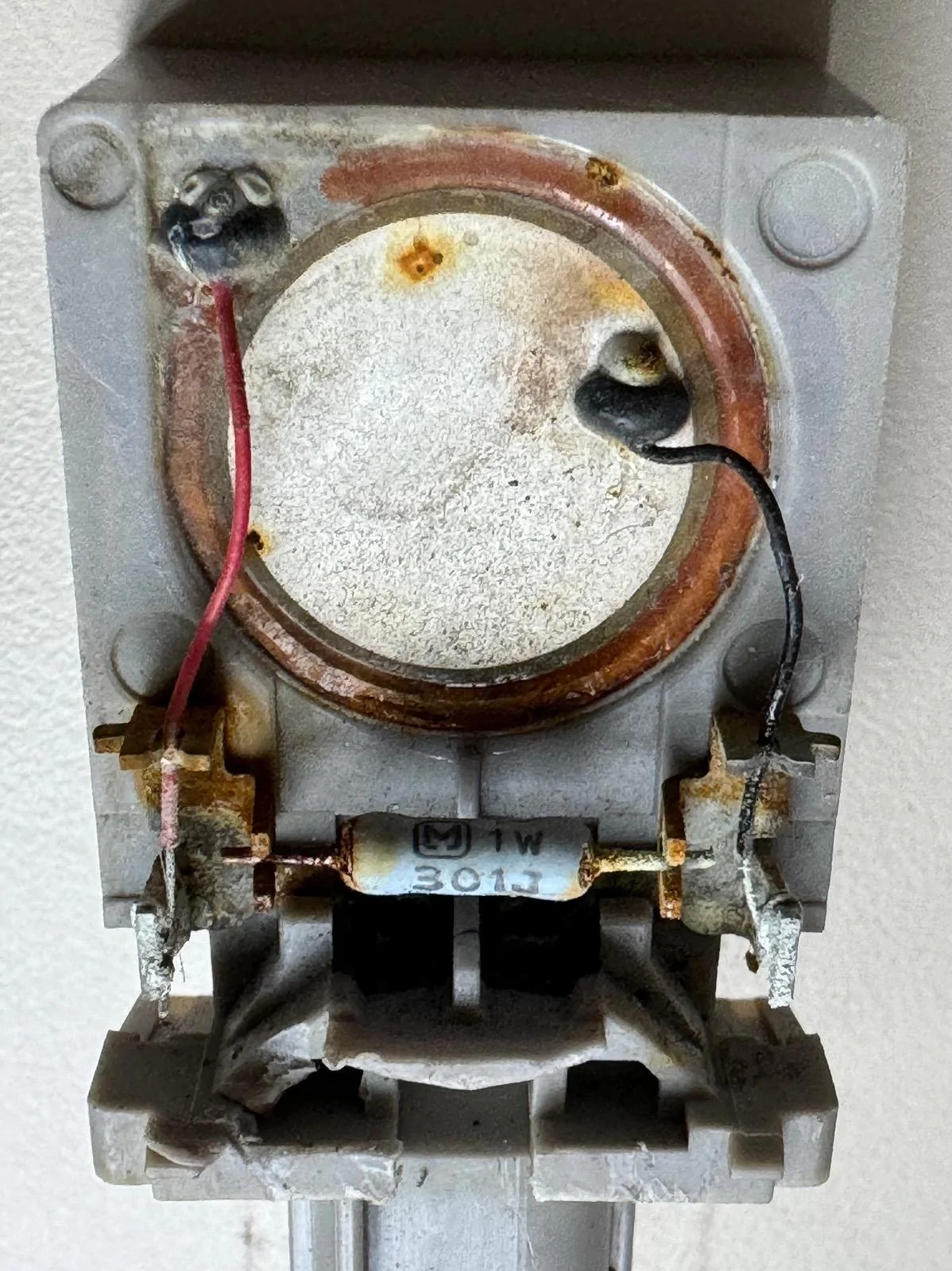

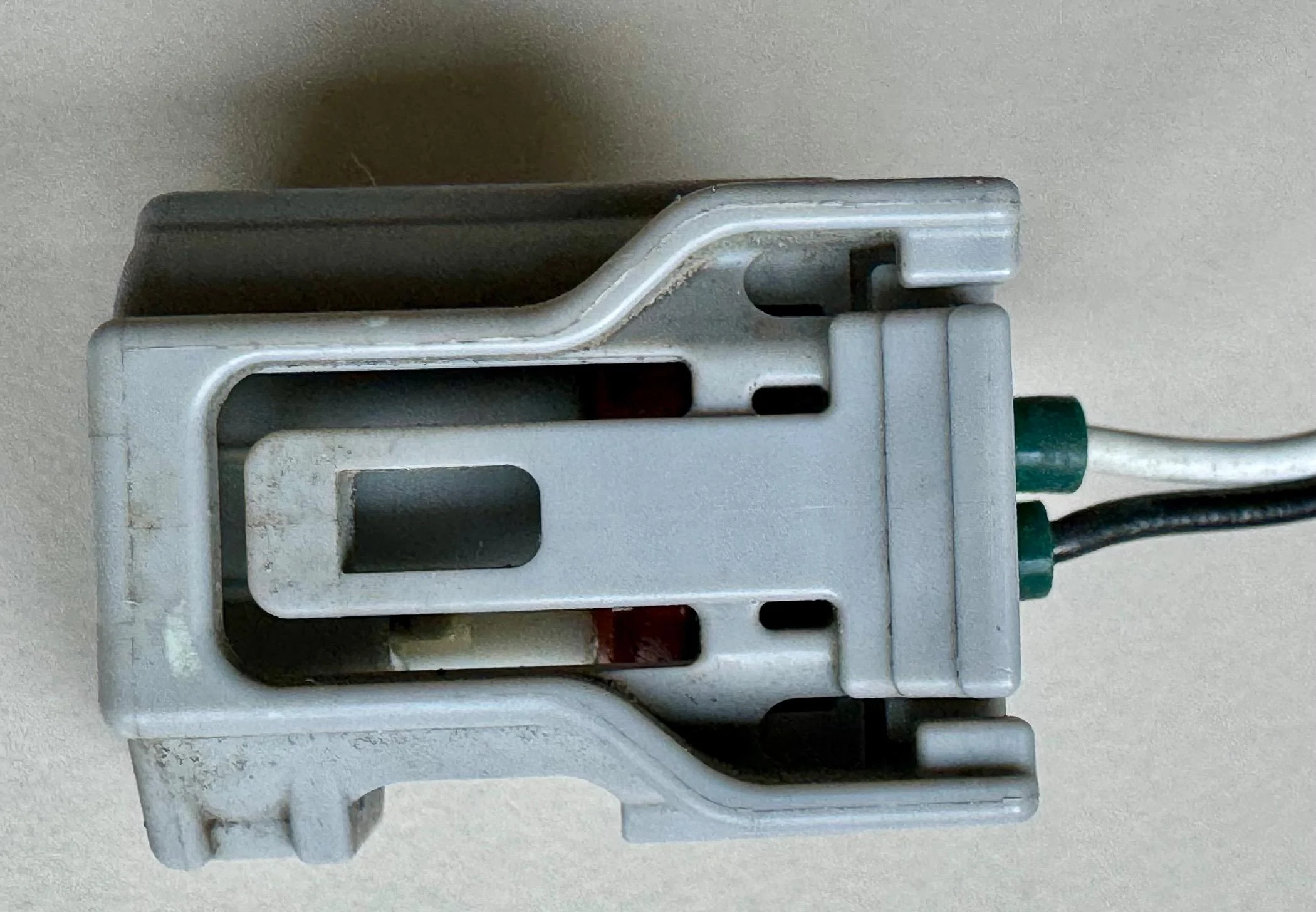

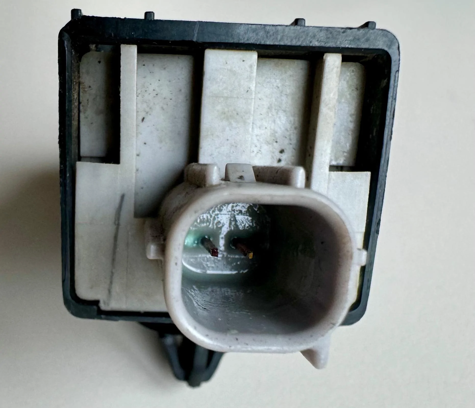

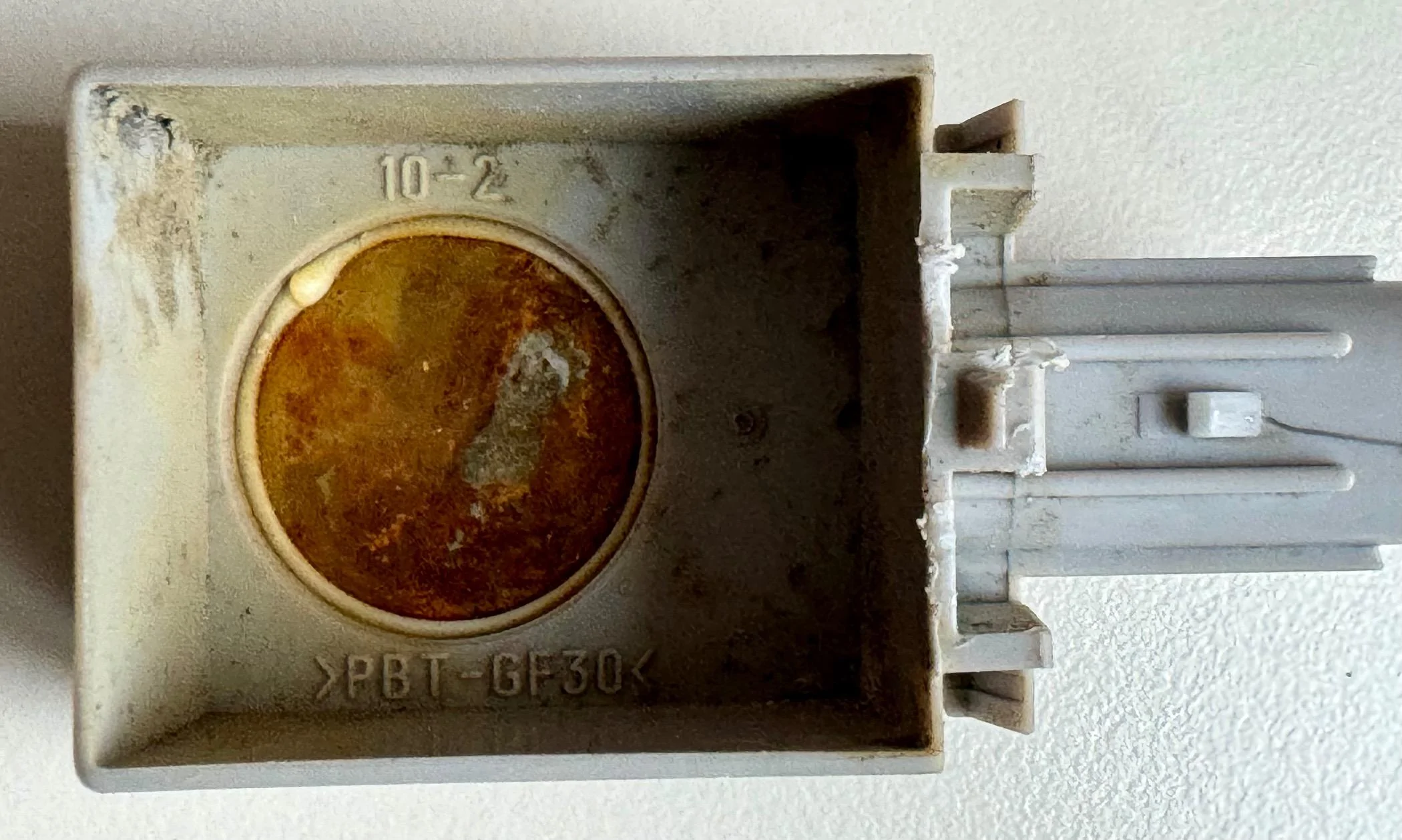

I was able to find a used beeper with the female plug still attached on eBay. After it arrived I opened it up to get a look. (Wanted to keep my original part in good order in case I need it later).
Unfortunately this part is a bit rusty inside. The ad said it came from a 2017 Subaru Impreza. It looks identical to my Ford part. Shows the same resistance when measured across the female wires (.235 ohms) when plugged into either the used buzzer or the Ford buzzer.
The inside looks to be the same resistor as others photos that were posted in this thread of the Ford original buzzer.
@WillB17 not sure if these photos will help in the design of your plug-in bypass, but here they are.
Thanks a ton, I did the same as you and got the buzzer as well from Ebay. I ohm'd it out to 22 ohms though. Now I am hunting down the OEM housing, terminals and seals. Finding overseas connectors though is always the hardest. EDIT: I guess I spoke too soon, found everything I need! Hopefully have a working proto in the next two weeks.
