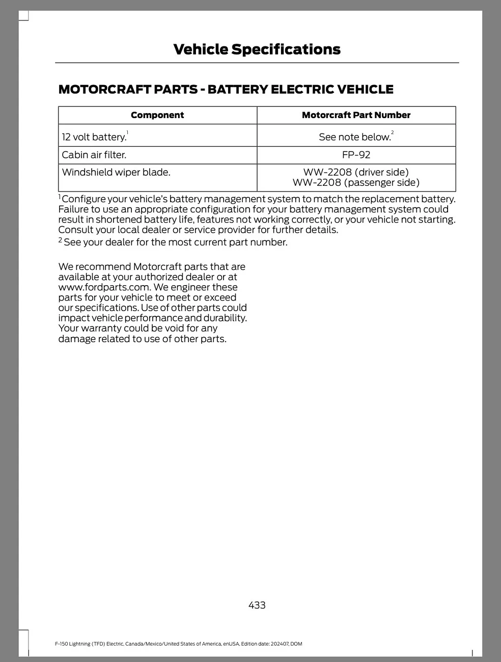

I'm still new to the truck but the owners manual references 12v battery and not batteries so I assume there's only one. I'm with @biers in thinking that they were likely referring to the 3rd module of HVB pack.
Page attached for reference.
