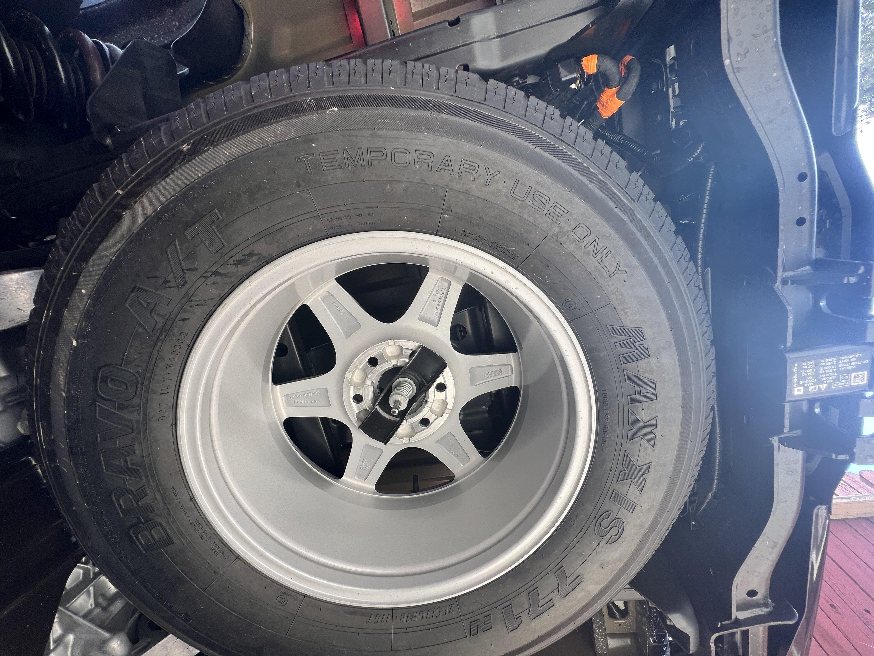

Negative. The factory spare is mounted on an alloy wheel (that is the wrong size) and the tire is a limited use spare. I has to buy a matching Lariat wheel - actually bought a set of four take offs for less than one new one.

Yeah. I just discovered the dissimilarity today. I thought the Lariat had a "full-size" spare tire. That was the glow I read in initial press releases about the Lightning, IIRC. It was going to come with a full-size spare. My tires are 275/60R20 BSW ALL-SEASON, whereas the spare, as pointed out, is a 265/70/18 A/T BSW. I asked a Ford chat rep about the mismatch today, and she replied straight out of the manual on Ford's recommendation.
Vanessa: I appreciate your patience! Here are the specifications for the spare tire on your truck: 265/70/18 A/T BSW. With that being said this would be considered a dissimilar spare wheel and tire. Your Owner's Manual state the following on page 473: " If you have a dissimilar spare wheel and
tire, then it is intended for temporary use only. This means that if you need to use it, you should replace it as soon as possible
with a road wheel and tire assembly that is the same size and type as the road tires and wheels that were originally provided by Ford." Here is a copy of your Owner's Manual for your review: https://www.fordservicecontent.com/Ford_Content/Catalog/owner_information/2023_Ford_F-150_Lightning_Owners_Manual_version_1.1_om_EN-US.pdf
Too bad on a $100K vehicle that @Ford Motor Company can't provide a real full-size spare time that matches the mounted tires and does not inconvenience the owner with the limits on a dissimilar tire relative to the vehicle's speed, performance, and safety. My reaction is the same as when I discovered that FMC, with very little warning to 2023 buyers, removed the spare tire lock from 2023 builds. I don't even think that item is listed anymore on Ford Parts (accessories.ford.com). My dealer rep said the spare tire lock removal was probably done because there was very little demand for a spare tire lock (who wants to steal a temporary spare and rim!?). Ford offers lots of options I don't want. I wish they would offer at least as options the things that I do want - a full-size spare tire that matches the mounted tires and a spare tire lock. As it is, we're paying doubly for a spare we don't want and then a truly functional tire and rim to replace it! :rolleyes:

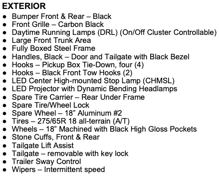

The 2022 Lightning order guide only referred to the "Spare Wheel - 18" Aluminum #2" as standard equipment for all trims. It does list the Spare Tire/Wheel Lock, which is on the truck I received. Maybe check the 2023 order guide to see what it included at the time you ordered your truck. A tire calculator shows the spare as very close, but not quite as 'full-size' as the 20" A/S, a 1.25" circumference difference.
https://www.discounttire.com/learn/tire-size-calculator
2022 All Trims Standard Equipment:
Ford F-150 Lightning Can full size tire be stored under the truck in place of the factory spare tire? Std Eq
