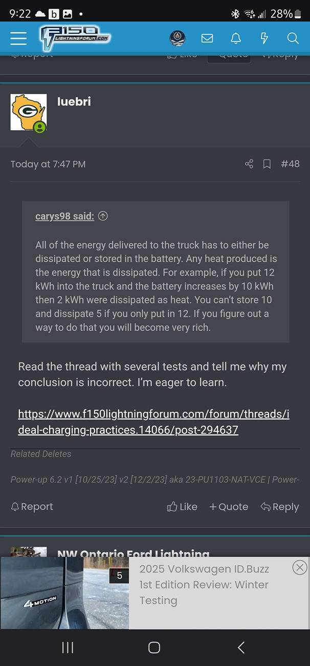

All of the energy delivered to the truck has to either be dissipated or stored in the battery. Any heat produced is the energy that is dissipated. For example, if you put 12 kWh into the truck and the battery increases by 10 kWh then 2 kWh were dissipated as heat. You can’t store 10 and dissipate 5 if you only put in 12. If you figure out a way to do that you will become very rich.
Read the thread with several tests and tell me why my conclusion is incorrect. I’m eager to learn.
https://www.f150lightningforum.com/forum/threads/ideal-charging-practices.14066/post-294637

Yes, due to internal resistance in the battery, energy used to charge will also result in energy expended as heat. That's not what is being said. The point is that it is not energy stored, not exactly. You are not increasing the chemical potential. There IS some capacity increase due to the raised temp, but much less than that amount of energy chemically stored, and it will dissapate.
Again, All I am saying and my tests have shown is the act of charging (inputting kWh into the battery) will raise battery temp as a bi product (agree that my understanding is due to internal resistance). I never stated anything more or less than that.

He claimed that you can't put 12kwh in, get 10 kwh in charging and 5kwh in heat. You refuted that.
I never refuted his example. I also never said or meant to imply saying what his example is trying to say I did say. My link to my previous test stated the following... using REAL WORLD TESTING DATA.
Test #1 - EVSE 120v Charging with Preconditioning Set
- AMPRoad EVSE set to 16 AMP
- Charging at 11.2 amps (per Lightning 120v limitations)
- Plugged in at 9:38 PM (65% SOC, 71.65 kWh)
- Per Car Scanner OBD App Start Temp: HVB Min 41 F/ HVB Max 42.8
- Unplugged at 7:07 AM (12.55kWh used per charger display) (70.5% SOC, 82.63kWH)
- Temp: HVB Min 53.6 F/ HVB Max 55.4
- Preconditioning was set to occur at 6:55AM
- Garage temp per Truck reading was 43 F at start and at Finish.
(I can attach screenshots if you need to see my work, but did not feel that was necessary as I am not worried about my semester grade)
My conclusion: Even 120v charging makes a temperature difference. Since Only 1.5kWh was "lost" between what the charger used and what the battery gained I would conclude that 120v was enough to warm the battery a decent amount ~12.5F.
15A / 120v
Soc End82.63
Soc Start71.65
Gained kWh10.98
KWh used12.55
Lost kWh1.57
Lost kWh %12.51%
