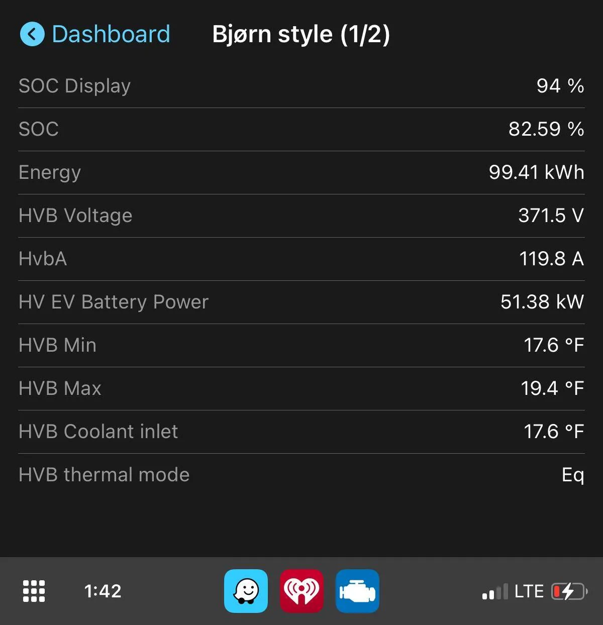

120v does provide a minor benefit from a heat standpoint via just charging or attempting a preconditioning schedule, but nowhere near the desired 60 Fahrenheit in frigid conditions. I have previously done tests showing this, and I also did just return from a six day vacation with the truck outside on 120 V at an airport lot In Milwaukee, which for much of that time was subzero and was low single digits during the day yesterday when I picked it up, I purposely adjusted my precondition time for when I would return back, so hopefully the battery was as warm as it could get it to. I was also hoping to time the bulk of my charging to be nonstop the last two days of my trip, but unfortunately, even without a schedule the truck would randomly start charging again and I would have to check on it via FordPass periodically to stop it so it got to too high of SOC so I was not able to charge the night before in which temps were well below zero. I did start charging in the morning and have preconditioning set up and truck did get to 17 Fahrenheit. My guess is if I would’ve been able to time it with 48 hours plus of nonstop charging the temp would’ve been a bit higher. Power gauge was at 90% so other than my driving efficiency being poor, 120 V juice did the job for an extended time and very frigid conditions to get charged up.
