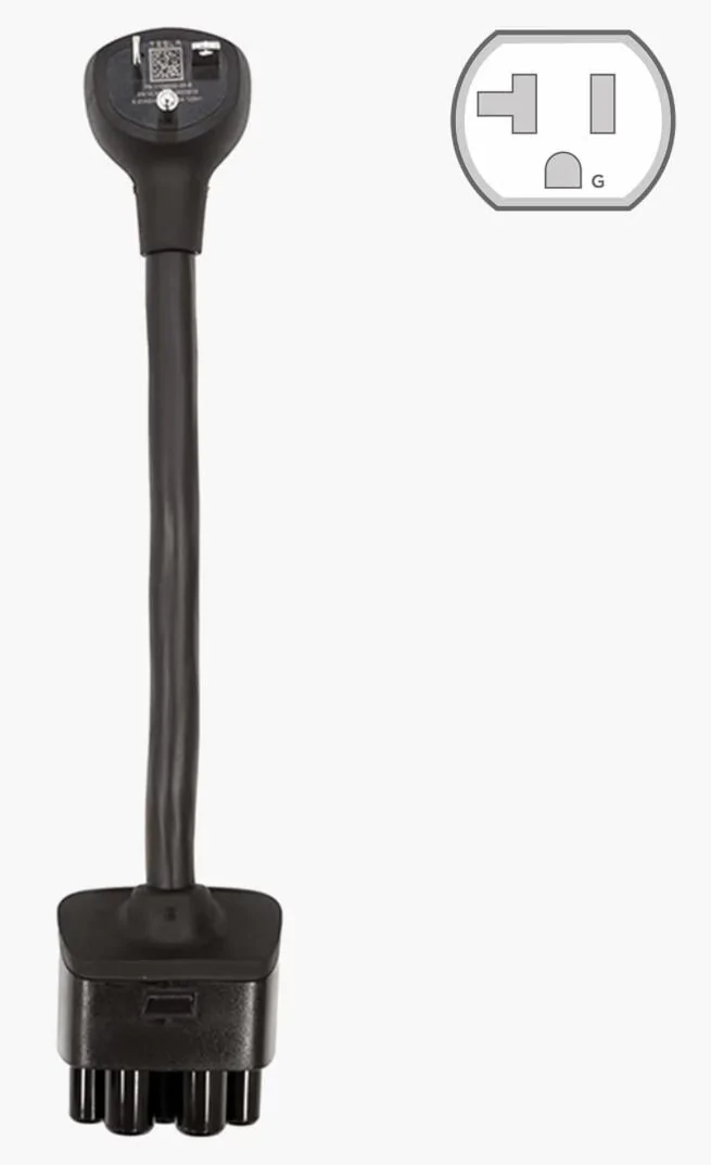

Lowest common denominator is the issue, 15a & 20a outlets accommodate the same 120v plug, designing an EVSE with 16 amps (80% of 20a) would overtax the 15a circuit, hence the derated capacity to lowest safe value. Even some "smart" people get themselves into trouble!
In my opinion Ford should handle this the way Tesla handles 20a (16a charging) with the 5-20 dongle. From my standpoint it is no different than a user knowing that the various types of 240v outlets and the associated wiring is sized correctly for the demand.
Not so common in old construction, they defaulted to the LCD.
But, OK, provide it as an optional dongle and adjust the programming on the EVSE to signal the truck of the slight increased capacity.
