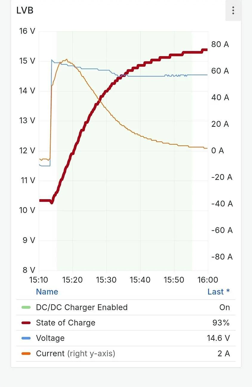

Faster charging is not likely an option. I believe the BMS limits the speed the little H3 battery can receive a charge to keep from frying it. This charging speed limit will not likely go away with a larger battery and if your driving habits result in a chronically undercharged H3, it will result in a chronically undercharged larger battery too.
That said, an H4 will fit with some tray modifications and may reduce the depth of discharge for some driving habits. Has anyone tried this? If not, I am going to do this next round to see if there is any improvement. My goal is to extend the time the truck can stay connected before dropping everything. Right now, it drops after a day and a half because my second battery is now weak.
mr.Magoo
May 27, 2022
686
829
2022 Lariat ER, AMB
The LVB is charged from 35% to 90% in about 20min, so charging speed shouldn't be much of an issue unless its in the dead of winter and you're taking the whole family 5 miles fown tge road with heated seats, cabin heater and defroster running, at that point you might end up with less SoC than you started with, but during normal circumstances this should not be a common occurrence.
If people are still concerned due to short commutes, don't shut the truck off, let it run and shut itself off after 30min.
