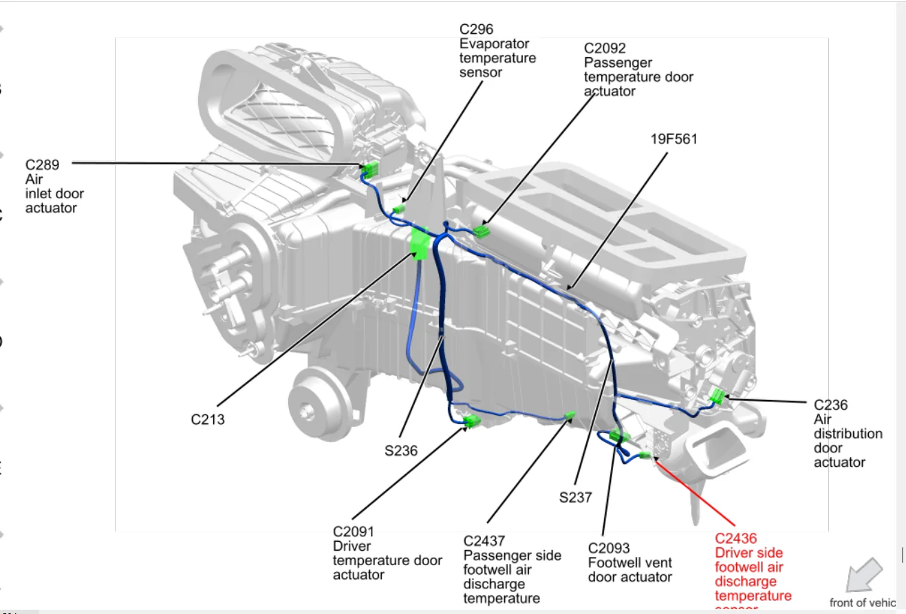

Hi everyone, I need some help with my 2022 Ford F-150 Lightning.
I’m having an issue with the blend door actuator (driver side). On the driver side it only blows cold air, while the passenger side works fine and blows heat. I scanned the truck with a diagnostic tool and it shows “blend door failed”.
Can anyone please:
Share a diagram / exact location of the driver-side blend door actuator so I can remove it and order the correct replacement?
Thank you in advance! 🙏

Thank you very much for the help.
The blend door actuator for the driver’s side was actually located on the passenger side, down by the footwell. It was very easy to access—no interior trim or plastics needed to be removed; it was directly visible.
With the diagram, it was very easy to locate. I only had to remove it and lubricate it with WD-40, which freed it up, and now it’s working perfectly.

Was it the C2091 driver temperature door actuator in the drawing?
