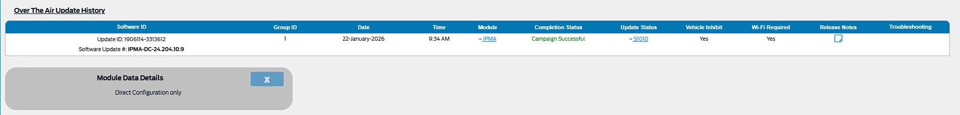

This morning I received a message that an update would install at 1am. When I got home I decided to see details of upcoming update and go ahead and do it now if possible. It said I was getting Blue Cruise 1.4. I wanted to do update now which It did. After 20 mins went out and checked status. It showed updated complete. I looked at details of update and it showed the same information when I got blue Cruise 1.4. I received that update back on Apr 16th. Does anyone know if they sent the same update or perhaps a 1.4.1 version that corrected some small errors like better speed limit sign recognition.
My pass app does not show an update happened yet.

@BSEE SPARKY The OTA you got was the one that enables the config, but I assume you already did that when I sent you the FORScan changes. There are two IPMA OTAs needed for BC 1.4 to work. The first one will install the software itself, and the second one will add the configuration to enable the features. If you would have not made the changes to enbable this back in April, you would have had to wait all this time for BC 1.4 to work.

Everything has been working since Apr. All the features of 1.4 that are advertised anyway. That's why I thought maybe version 1.4.1 was rolling out. So it sounds like it is a repeat.
Any guesses why??

I am guessing the mothership thought your truck still needed the config to be enabled, so it sent you that update as a blanket cover. In your case, it made no difference to your truck since you enabled those things yourself.

I, too, received this update this morning and had previously installed module updates via FDRS and enabled via FORScan for BlueCruise 1.4.
Minutes after the update, I received a second update for SYNC 25.2.1.6.5
