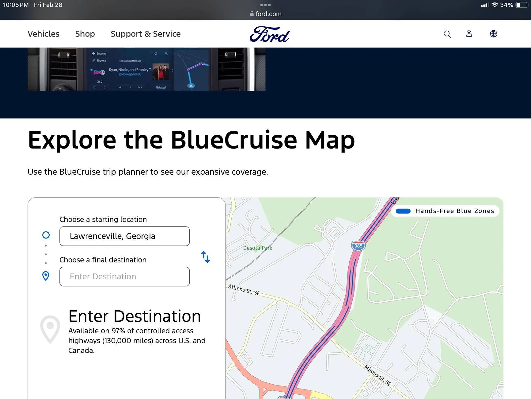

I notice that a stretch of interstate I drive BlueCruise goes on/off over short spots. So I look up the charted map and see this…..
the map reflects where it goes in/out of Hands Free mode. Short spots all along this interstate, Why is it like this?

Do you have BC 1.4?
It could be other reasons of course but it looks like there are curves in the road. Same thing where I live but with BC 1.4 it now stays engaged during those gaps and in some cases even slows down the truck to navigate the curve.

I have noticed this on my portion of the drive. Certain curves arent mapped on the BC map. Regardless, my BC still stays engaged in those spots.

I have the lane change and lane reposition toggles, so I guess I have BC 1.4. Still not sure how to determine that with certainty.
But, those little mapping gaps just don’t make sense to me.
Seems like the system has room for improvement.

There's a spot on a regular drive where BC drops out for a short distance. It's annoying, but consistent. Oddly, the "dead spot" is a little longer in one direction than the other.
