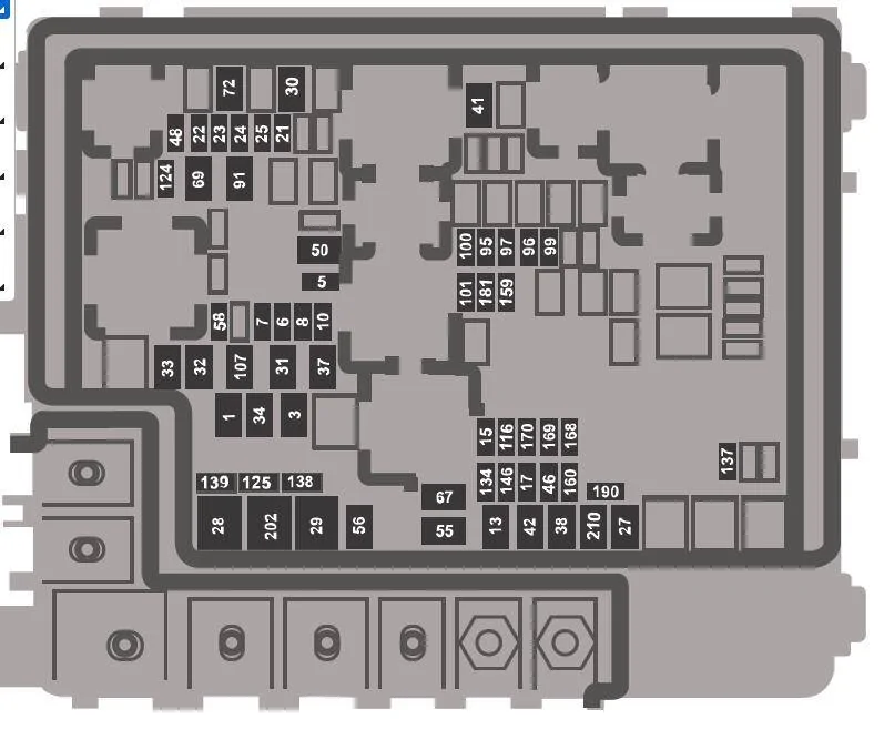

Maybe check for a blown fuse?
The frunk fuse block there is fuse 125 which powers both USB1 & USB2, and fuse 139 powers USB3,
Ford F-150 Lightning Both Front USB Ports Will Not Charge 1728966360729-uv
Ford F-150 Lightning Both Front USB Ports Will Not Charge 1728966516243-8a
Ford F-150 Lightning Both Front USB Ports Will Not Charge 1728966399142-l
