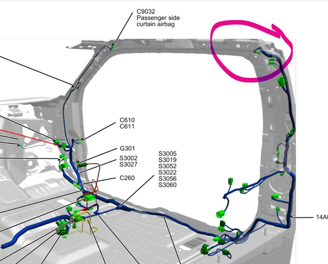

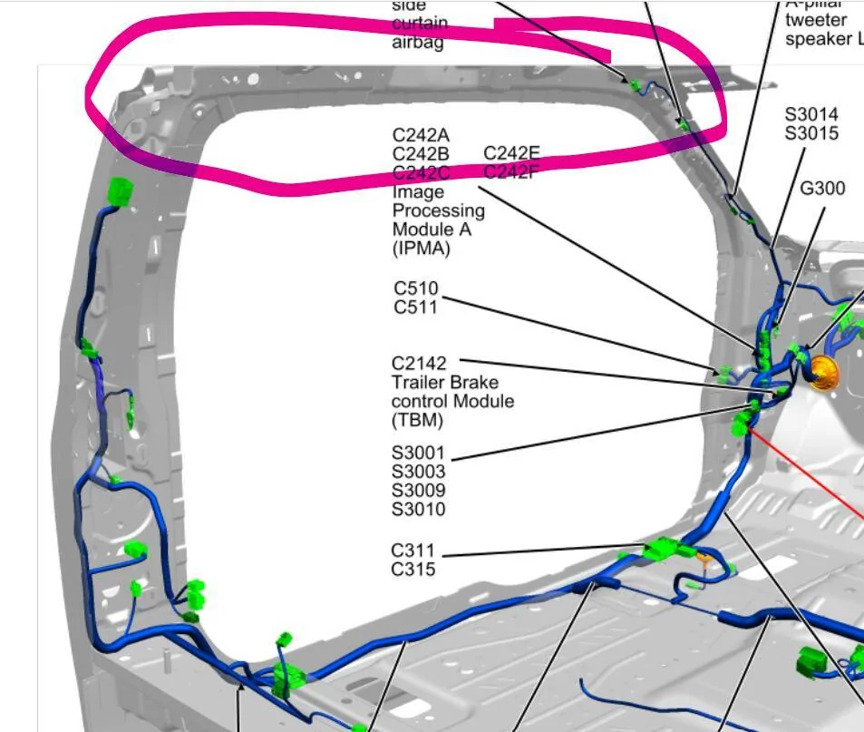

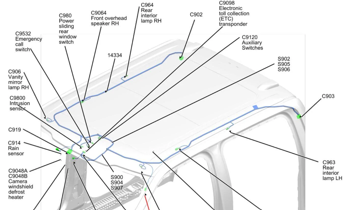

My guess is a wiring harness related to the “moonroof”. It isn’t the b-pillar. It literally at the “garment holder/light”. So I just need to find a way to pull the trim and check. I just didn’t want to attempt if anyone knew for sure there isn’t anything routing through that section. I was hoping someone had a drawing of the area to share. Thanks to all. I’ll post what I find.
213
15,715
17,626

Roof section

That’s awesome. Thank you. I bet it is airbag related. Which means I’m taking it in. I don’t think I want to mess with anything around that.
Thank you again. That’s what I was looking to see.
