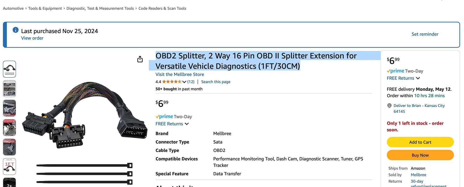

Here it is. Works well for powering the Canopy cam and data for ABRP Premium.
I don’t see a link to the splitter in your reply. I don’t know if the forum is cutting it out, but maybe you could offer the product name on Amazon?
thank you!
Hammick
Jun 21, 2023
486
546
Somewhere in MT
thank you!
Screenshot attached.
Ford F-150 Lightning Canopy Bed Security Cameras Screenshot 2025-05-10 at 9.18.07 AM
