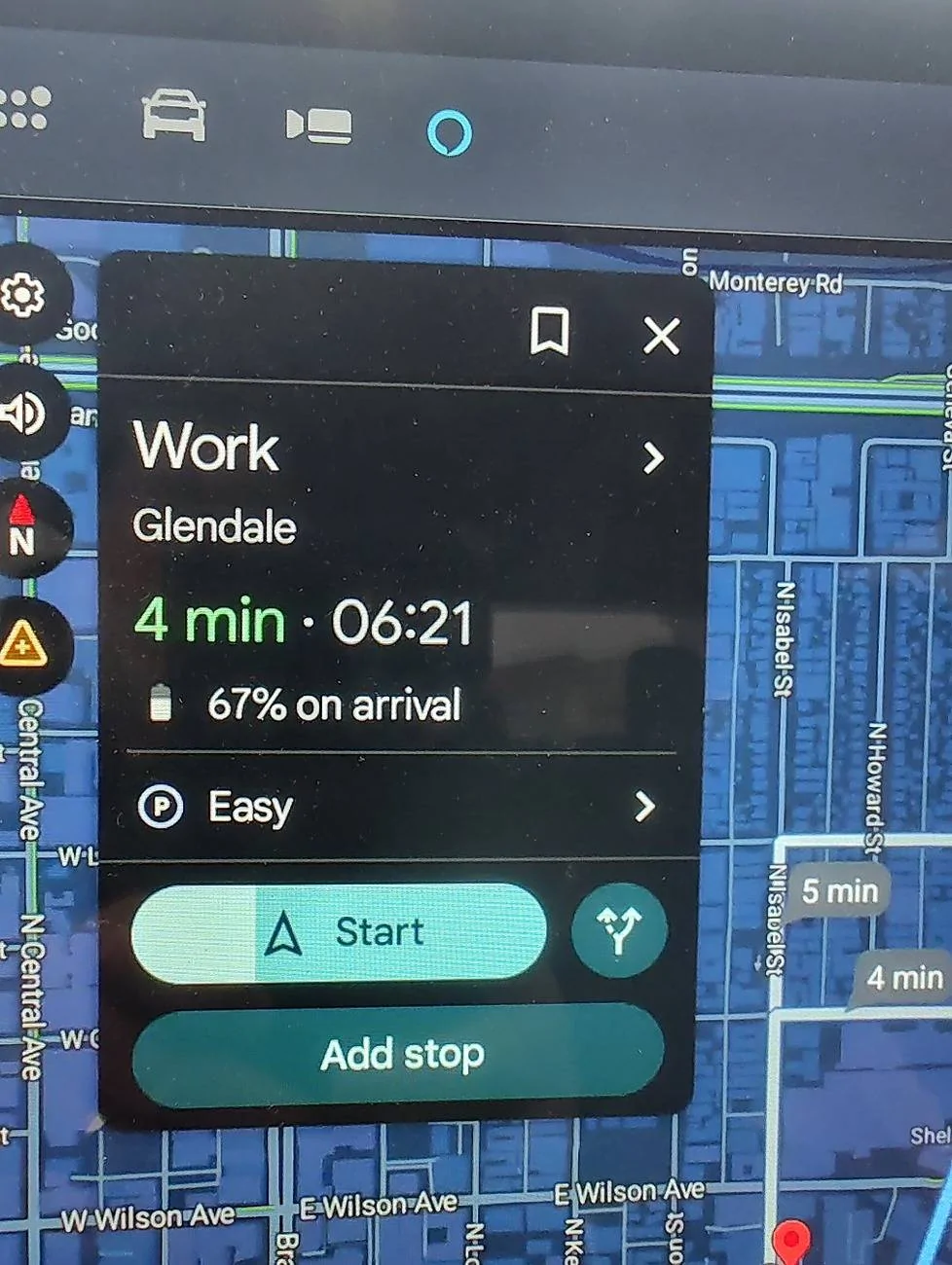

I first noticed this a week or so ago - maybe after a recent update.
On the 15 inch center display when Android Auto is selected (so it's showing the map), by default it shows a search bar with two "suggestions" entered. Those two locations would give the distance, time estimate, and estimated battery upon arrival. That would update as I drive. Very commonly, the two suggestions are Home and Work since I routinely drive between the two. Recently the distance, time and arrival SoC are no longer updating. The image below correctly shows where I am, but the information for Work has not not updated since I left home.
Ford F-150 Lightning Change in nav distance indication Photo-1
If you select one of the selected locations as if you want navigation to it, during the timeout before it starts navigating, the the distance, time, and arrival SoC are updated to reality as seen below:
Ford F-150 Lightning Change in nav distance indication Photo-2
Sync version 25.2.1.6.5
Android Auto version 14.4.652054-release
Anyone else seeing this?

Yes, this is how it's operated for a long time.
It doesn't update the distance to unless you select it. You should also notice that there is discrepancy in the distances when searching VS navigating to.
I think it's to save on processing power and gps usage.
Maybe yours is that way, but mine definitely was updating the miles and time estimate when not selected. I almost never use the truck for navigation, but would routinely watch the time and mileage tick down, and maybe the arrival SoC. As recently as a week or so ago I was watching it tick down while answering the question of how close does it get before removing an item from the suggestions list (a little under a mile).

I observed this yesterday. What I observed is that it updates on a lesser interval than "instant". I saw it change like every 30 seconds or so. But it definitely was changing. I didn't try to figure out how often it updated.

As a followup, yesterday I noticed it did update at least once. I had the search minimized for most of the afternoon driving around so the suggestions not there, but late in the trip the search suggestions were there and shortly before I got home I noticed it had updated. I don't know if I will go anywhere today, but I will pay attention driving into work (the screen captures above were taken near work).

I have been trying to pay attention to this. Sometimes it updates and sometimes not. I MAY have found a pattern and would love to see if anyone else can confirm this. If the truck starts up with the center screen on Android Auto, the suggested distances will never update. If the truck starts up on something else (radio for example), and some while later you switch to Android Auto, the distances will update. And as far as I can tell, even if you start on Android Auto and immediately switch to something else, then later return to Android Auto, you will not get distance updates.
Anyone else able to confirm this?
